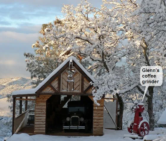

See what Glenn has done with his Garage project. This from the master of low-cost construction who also has hilly terrain.
http://www.countryplans.com/cgi-bin/yabb2/YaBB.pl?num=1138433261/0
(Now we know the secret of his productivity! :))
Drinking a cup of coffee as we speak. :)  That's hard to do --- I think I better get a napkin. :-/
The total cost of that garage is under $200 with all salvaged materials except a bit of cement, tarpaper and nails.  It was built off of a set of the Little House Plans that I modified to use the post and beam materials I had.
While your processes will likely be different, check out the story of that little garage from John's link and we can answer questions on the rest.
