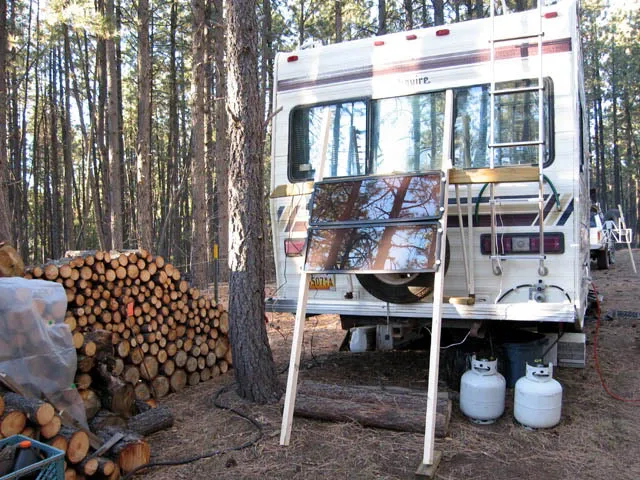

Yesterday I put together a quick and dirty solar panel experiment up in the mountains. The intent is to maintain the battery charge while absent. Eventually, when the cabin is built, there will be a proper solar PV setup, 500 watts min., shade free, MPPT controller, good batteries  ;D ...
What I really need to do is replace the batteries.  ::) They self discharge a bit quicker than they used to.  :(  Worn out... abused.
I bought two 15 watt Amorphous Silicone solar panels and a small charge controller. The location is somewhat shaded with shadows that move as the earth turns. A-Si panels are supposed to be more tolerant of shading. We'll see.
Unfortunately I left my test equipment at home so I couldn't measure the actual output watts or amps. All I had was a digital voltmeter. It did indicate that power was being made; depending on the sunlight I had reading of 13.09 to 13.65 volts at the batteries with the panels connected. With panels disconnected the batteries under no load read 12.5 volts. I also broke my hydrometer  :'( so I have no real idea what the state of charge is/was.  :-/  More info after next weekend... going back up Thursday AM.

Did you have a regulator or diode to prevent backflow?  Seems you mentioned you were going to put one on.
They say it is not as bad as once thought.  They can cook batteries if no regulator though.
#182
Back flow is prevented!  :)
The El-Cheapo charge controller is a very basic old pre-PWM, transistor type. I did verify there was no power flow when it was dark, no back flow either.

The solar panels had kept the old batteries up pretty good. Applying a temperature correction they were at about 80% charge and these oldies haven't been much better than that for some time. That's after a couple days of cloudy weather and the snow. I'm leaving them there over winter to see what happens. New ones in spring.
