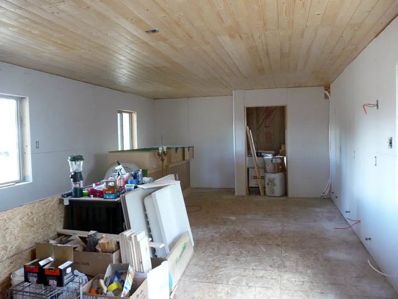

  #1: Well, this past weekend I didn't do too much other than screw up the drywall.
   a) Oh the drywall screw up? It's like.. I screwed the drywall up to the studs.  ;D ;D
     b) Did I have ya' wondering for even a moment?
... looking at west wall; the wall that will receive T&G soon...
#2: We've been spending money like a sailor on leave
#1: Screwed up eh , yer clever ;)
     a)  Will those butt joints over the door and window sides tend to crack , maybe those are walls you'll be covering with the T&G.
     b)  Ah ,,,,,,,,,,,,,,,,,,No  ;)

Peg I was sort of hoping you would make the comment about the door & windows and the pieces of drywall.  I figure you would get away with it.
#553
Quote from: PEG688 on October 20, 2008, 08:35:01 PM
MTL.   :-[    That wall at the end, bathroom doorway, is a pocket door though so no door slamming to deal with. It is one I want to cover with T&G at some point, maybe at a diagonal. Maybe use some of the thinner stuff. I was down to my last cut off pieces (should have bought an extra sheet  d*). And 24 inch OC makes it just a tad more difficult to spread the joints around, away from window corners when you're dealing with large windows.

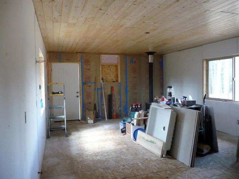

I drove up Friday night and got a fire going in the stove. Saturday AM it was warm enough, 70 degrees, to get on with drywall taping/jointing. I had some left over "hot mud" setting compound and used it on a couple spots where there were wider areas to fill. It saved a lot of time; instead of waiting for regular compound to dry, it sets chemically in about 45 minutes.  :)
After a morning of taping and filling I moved outside after lunch. I began the hardi panel siding. I'd bought a pair of Solo Sider siding installation hangers/tools.
The adjustment feature made it very easy to correct for any slight panel width differences. And as I was working alone, they made the job possible. Without them there's no way one person could hang the siding without resorting to homemade Rube Goldberg setups.
So by this afternoon I have the drywall completed. At least I'll know for certain when I return. I think all it needs now is a little light sanding here and there.  :)
I also used up the 25 hardi planks I picked up (12 ft x 12" wide). I have most of the north wall done and some of the west wall.
Here's a general view of the "homestead area"...
I also split some firewood and made a small pile of kindling from 2x cutoffs.
