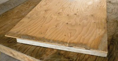

imagine a 4 ft wide panel, the sheathing is offset by 6" so that when its joined to the corner, it covers the edge of the 6" wide stud.
Basicly in a prefab you dont want the stud joins and the sheathing joins to be in the same place, you want the sheathing overlapping any panel joint, whether it be corners or along a wall.
This is for a chicken coop , but you can see the overlap for the base plate and the overlap to the next stud along from the panel join
make the panels as large as possible to minimise the joints in a long wall, the top and bottom plates would be as long as possible any joins being positioned so that they are not at a panel join.
