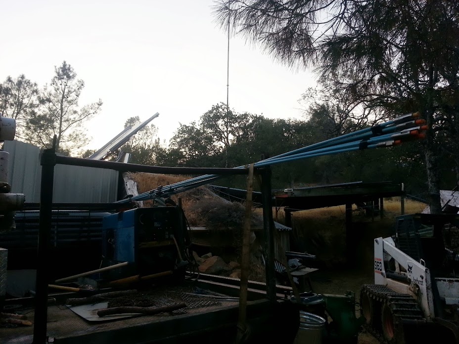

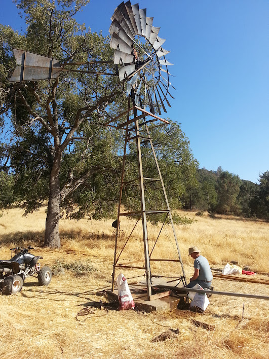

Well... tomorrow it'll be time to see what we can do about fixing that windmill.  Located the sucker rods I think... :)
Headed up to get the Sucker Rods for the mill tomorrow and check on possible sails for it... though I can make them if need be.
Four of them are damaged or missing so I guess we will do what we have to do.  :)
The lady at the windmill place is very knowledgeable and recommended going to a packer on the top rather than the old stand pipe and keep the system closed and clean... good idea I think and allows a proper finish at the top of the well too.

I went past quite a few of them today as I went up the Golden Chain Highway 49 to Placerville area to pick up the sucker rods and parts for the old windmill.  Paul and Ellen at American Windmills were very helpful in fixing this mill to be much more reliable than it has been in the past.  It had previously been repaired every couple of years.  Talking to Paul we decided that it was mostly due to using old junk parts in the well part of the pump... 100 year old sucker rods made of rotten wood, etc.  A couple of them broke or were broke when we took them out.
I was also told to add a second check valve under the pump as a safety in case one had any kind of problem... the second one would work as a backup and you would still pump... the check valve in the bottom of the pump cylinder can become dislodged by the plunger as it is meant to be removed with the plunger. it is threaded but more often than not it is dislodged unintentionally as the threads lock together and pull it loose when not expected .. cool idea but in reality it is likely responsible for a lot of failures too....
The top before was 3/8 standard pipe and couplings for sucker rod... get rid of that they said... I agreed... let's make this thing work for several years instead of two.  I am replacing all of the sucker rod... wood and steel with 5/8 fiberglass rod with guides on it.
Got the load of that today.
Also we are changing to a packer at the top to make this into a closed system.  That way it will be safe to use as a potable drinking water source too.  :)

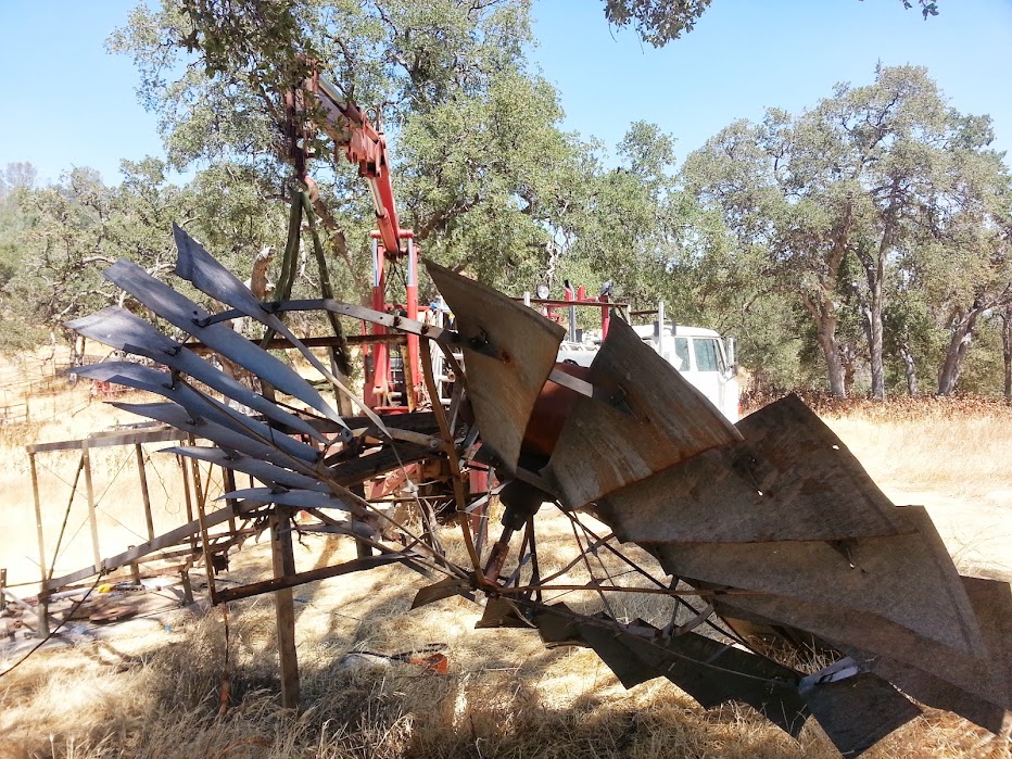

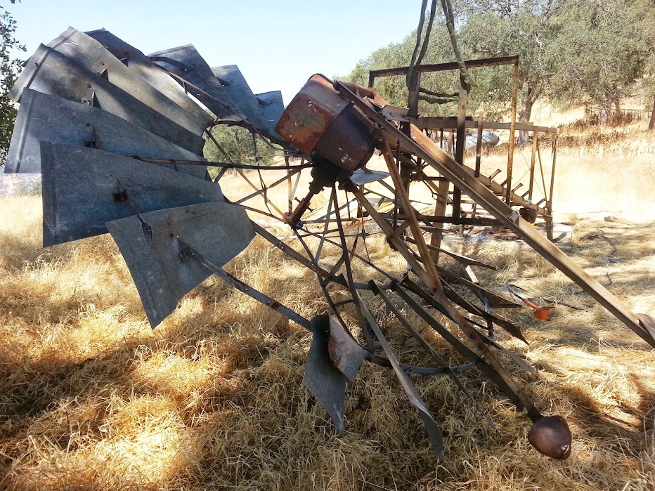

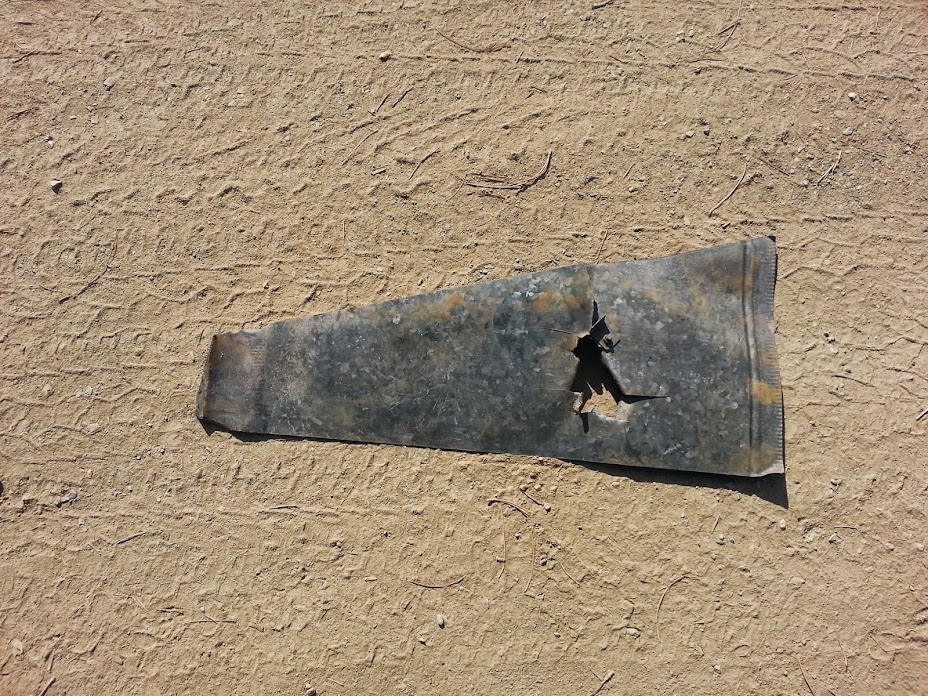

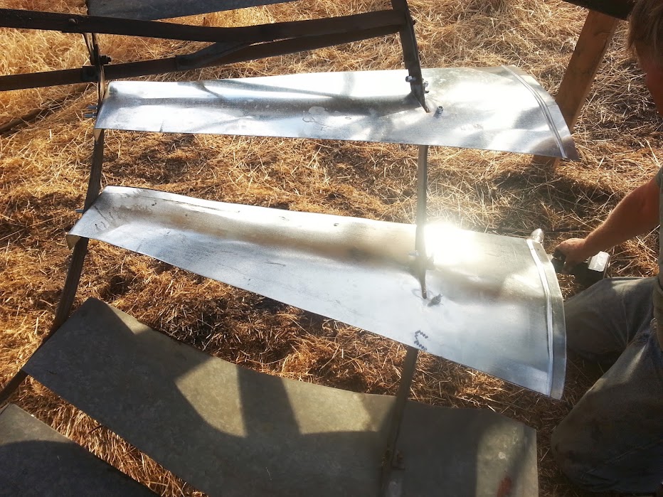

I put the new blades I made on the mill yesterday.
Here are two of them.

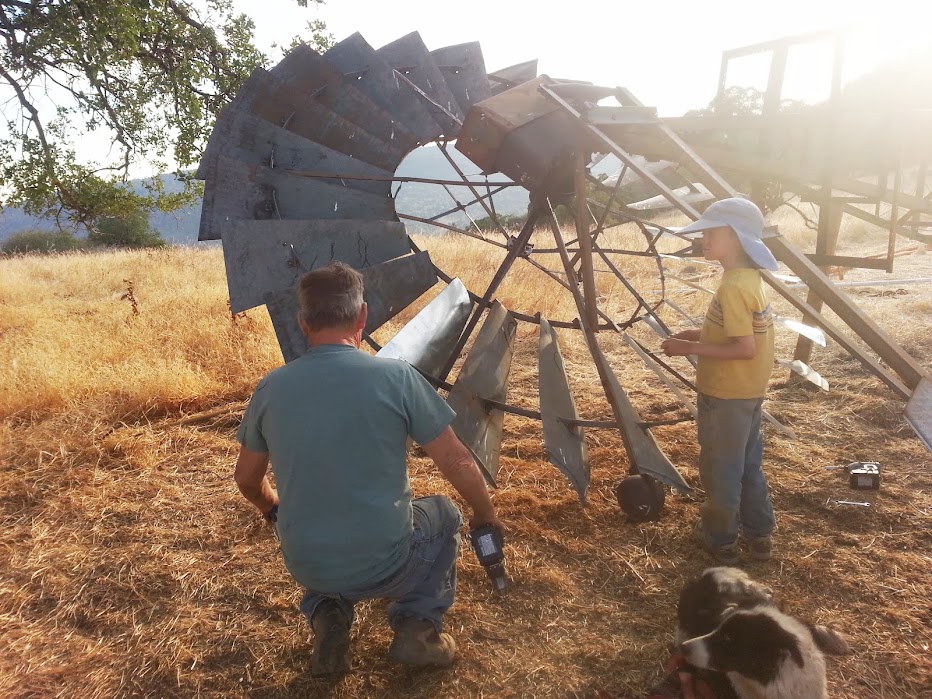

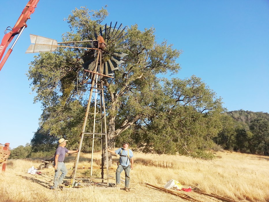

Here is my friend and his Grandson putting new bolts in the blades.   [ouch]

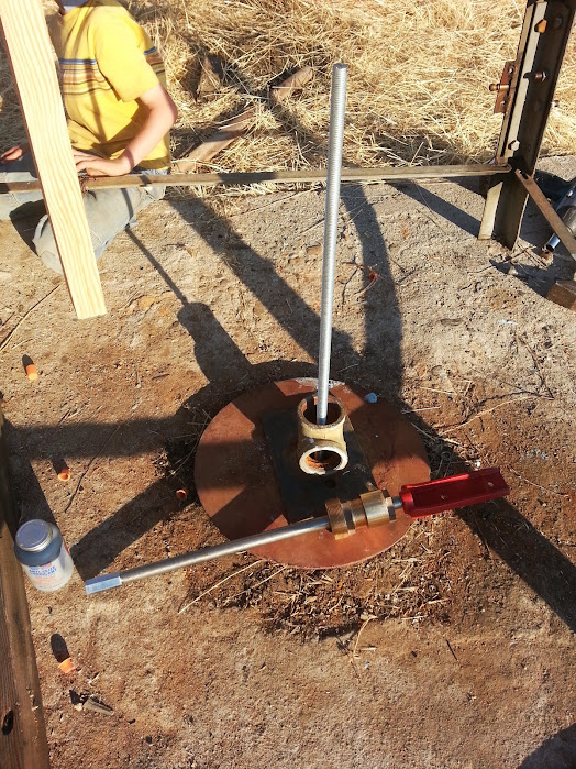

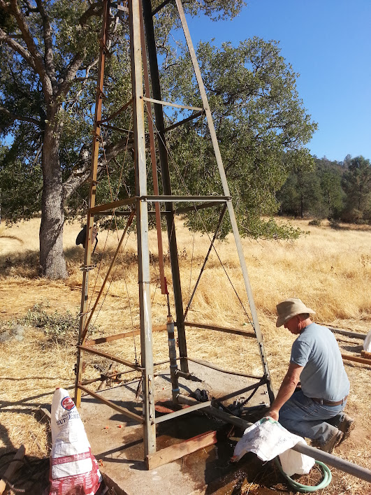

I finished the Windmill last night...

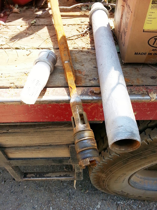

I laid out the packer and got the length right for cutting the threaded connection rod.  We put the pump in earlier and came out within a few inches...actually I expected it to be exactly where it came out on the sucker rod.  The threaded rod connects to the bottom of the packer rod and the sucker rod at the bottom of the stroke on both, then the entire sucker rod is pulled up the distance you desire to give room at the top and bottom of the stroke when the windmill is in operation.  We used 3 inches then with the 7 inch stroke of the mill we had 10" to the top of the stroke leaving us another 3 inches above the top of the stroke clear.
The cylinder on the bottom had 17 inches to play in so no problem there.  Up three inches off of the bottom plus 7 inch stroke left us 7 inches at the top.
Only enough wind to get it to make a few strokes but it seems all is in order to bring water up from the bottom :)

I completely rebuilt the cylinder and check valve in the bottom of it.  The local pump company told me the plastic check valve was as good as the brass one because that was all he had... ... but that would be if you were not me I guess. I put some pipe dope on it -- tightened it down with a couple wrenches and promptly snapped it in half... quite easily too... [ouch]
I knew the hardware store had a brass one so about three hours later my buddy returned with it.  :)

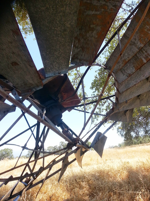

Rick, there are big double gears and Pittman arms coming off of the side of them going to the Walking Beam that raises and lowers the pump.
Looks like Hyatt roller bearings or Fiber bearings - double long, Rick.  Mostly steel rather than cast iron too.
It does all run in oil which was a great improvement over the ones that had to be greased every so often and was one of their selling points. :)

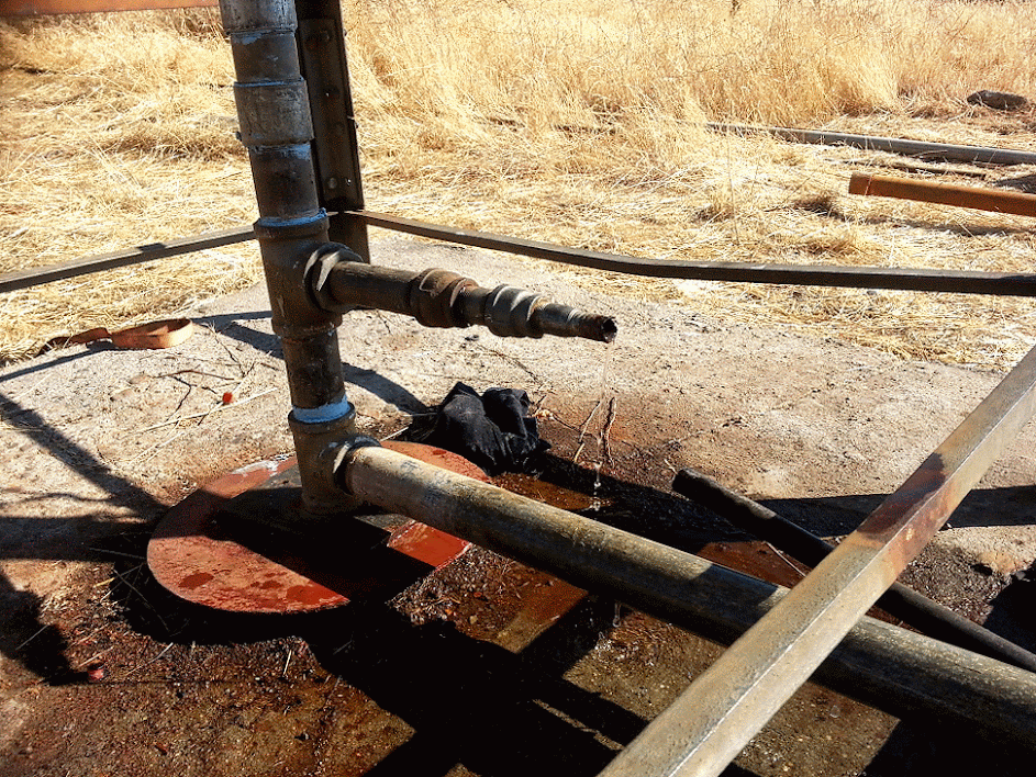

Richard was excited today as we rounded the corner and he saw the windmill pumping away and water coming out of the pipe.  I was riding a motorcycle behind his quad and he turned around and gave me a big thumbs up.  :)
A short video.....click the picture below to view
We found that the problem with the tail being over center was just because the furling mechanism was too loose.  After tightening it to the proper tension the tail was centered yet it could furl in a high wind.  :)
We checked out a few more things and noted materials we needed to get it hooked up for the cattle.  We measured the flow at a low wind condition at about 40 gallons per hour.

Hey Glenn,how is that pump regulated to shut off water flow once the tank if full.40gph is pretty good in a light wind.I bet it would easily double that in a steady strong wind.
I hope you get it going Windpower.  It was a fun project.  I wonder if it has a bleed off to slowly drain the water back into the well when not pumping?
Ben, this one is not currently regulated to shut off but since we put a stuffing box or packer at the top it can pressure into a storage tank up hill for use when there is not wind... Manual shutoff currently but there was a device shown in the PDF catalog above for shutting off the windmill.  Currently this one would just overflow into the meadow.
