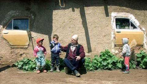

Here's an interesting use of cob style construction.
I wonder if the windows roll down?

The doors might even open!  Looks like a frame might be stuck in there.  (I can't think why you wouldn't leave the window cranks in there, as well as the padding on the inside).
I don't really think though that a cob wall would be a great place to put doors that you often slam.
Looking through windows the other day, found a reference to a residential window that opens and closes (and seals) the way a back seat door does on a van.
