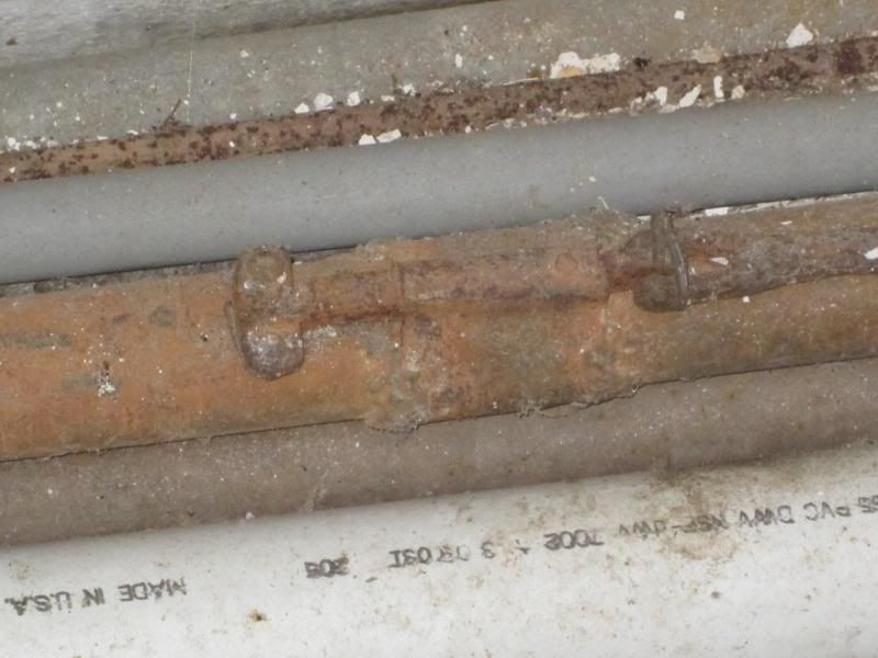

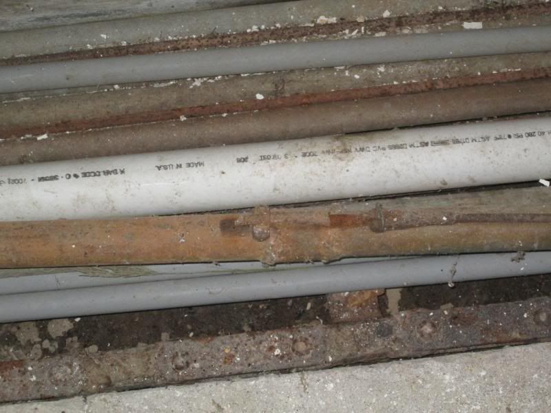

I found all the parts needed for hooking up my windmill
<----   pictured here
the sucker rods are very expensive from Lehmans but I found the old ones in the garage in working condition (a bit rusted) along with the pipe
  this one has a vent pipe to keep it from freezing in Wisconsin winters -- I need to figure out how it works too
one of these days I am going to pull the pipe and install my rebuilt cylinder and get this one working
