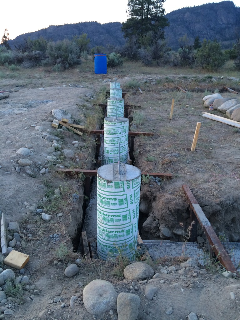

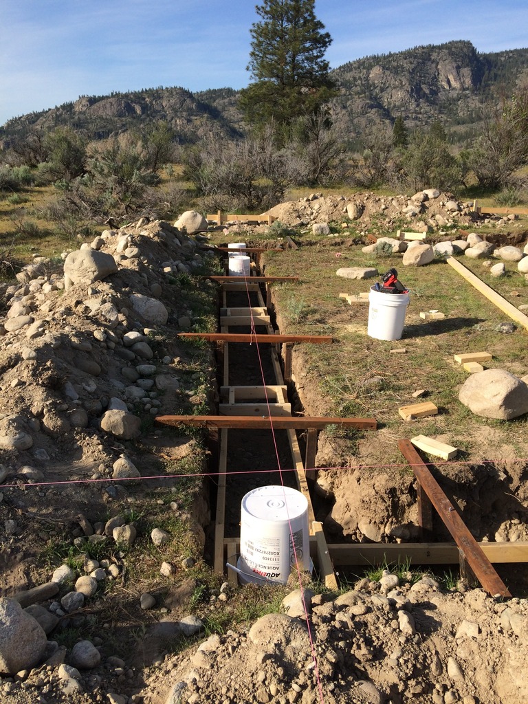

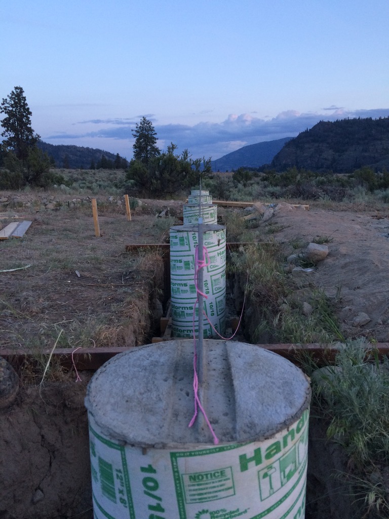

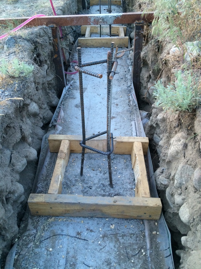

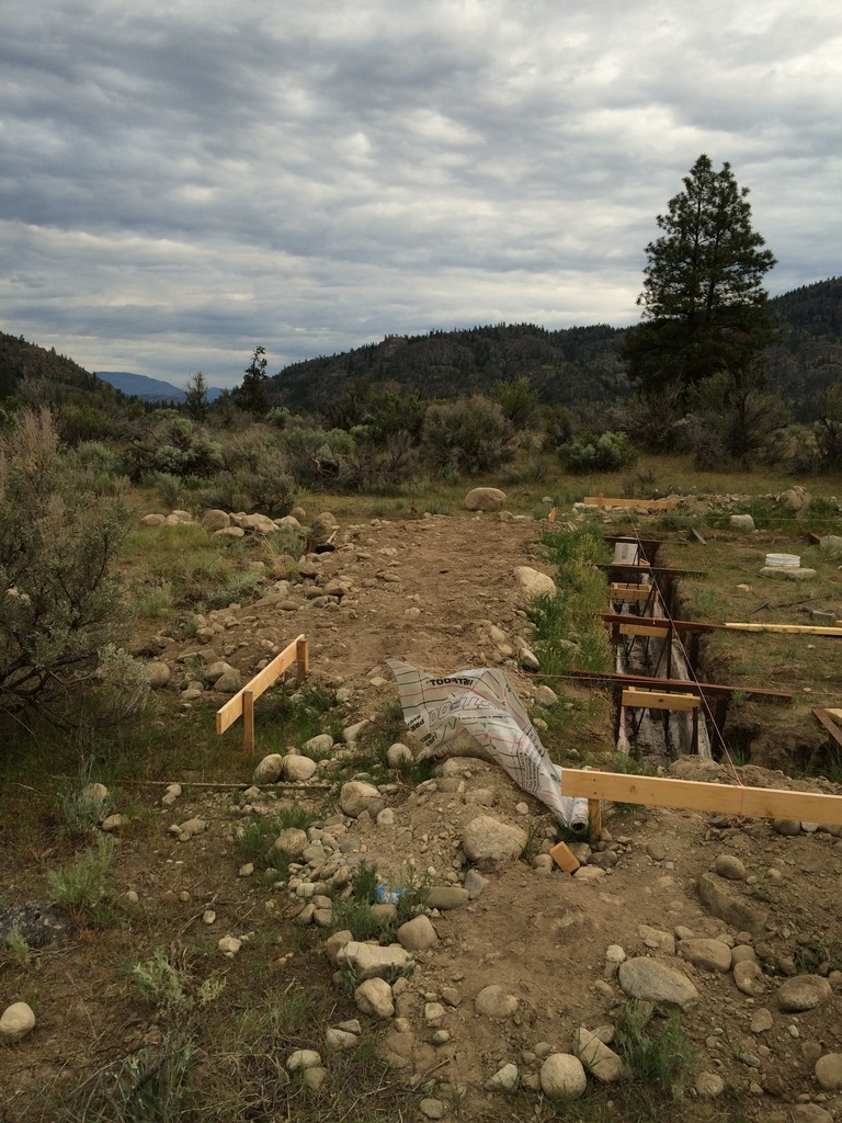

This cabing build is in the southern okanagan valley of b.c.. I built it on piers, thinking it would be faster and cheaper. It was neither. The piers are all tied into a 14"thick x 18" wide perimeter footing. Form for footing is called fast foot. Its a woven poly material.
I could not find stakes to pound into ground to support the form board, so I made up some brackets and suspended the form board from the top.

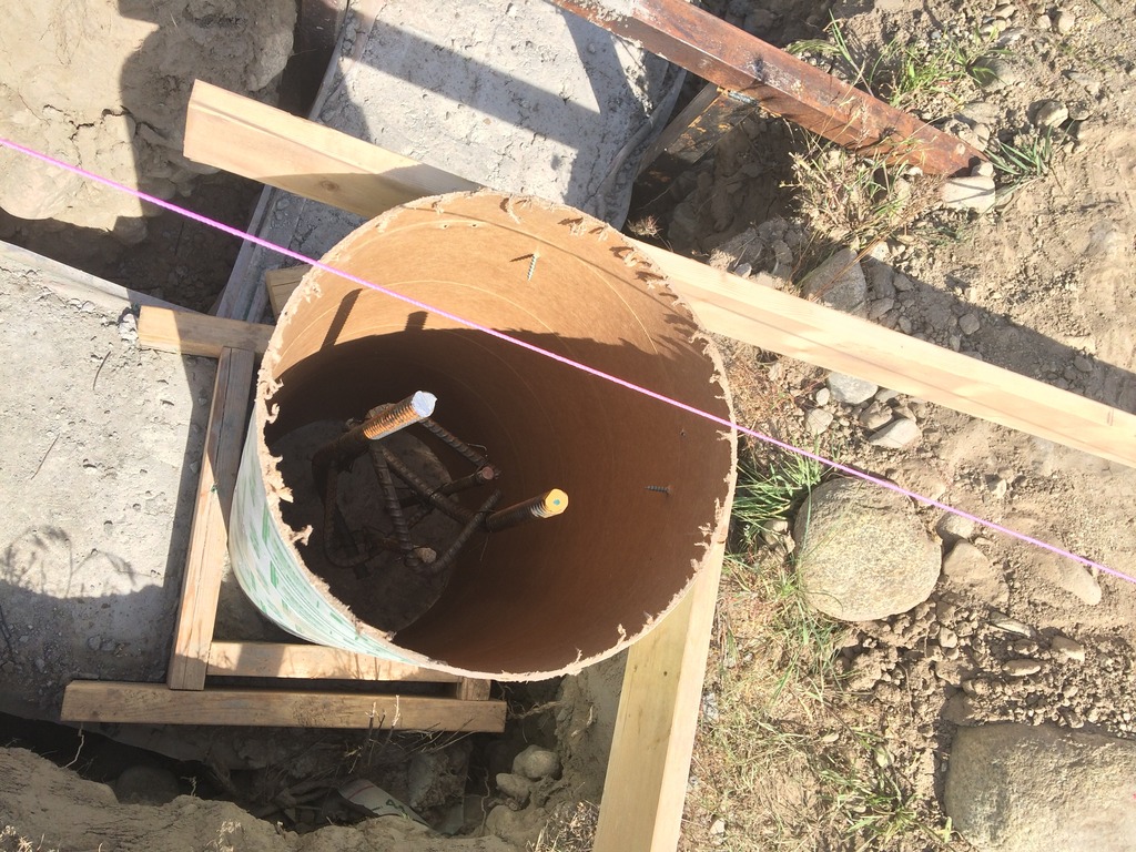

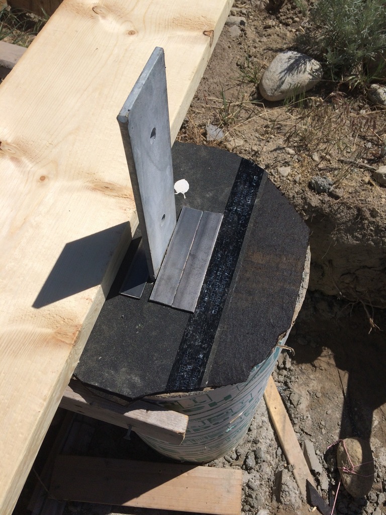

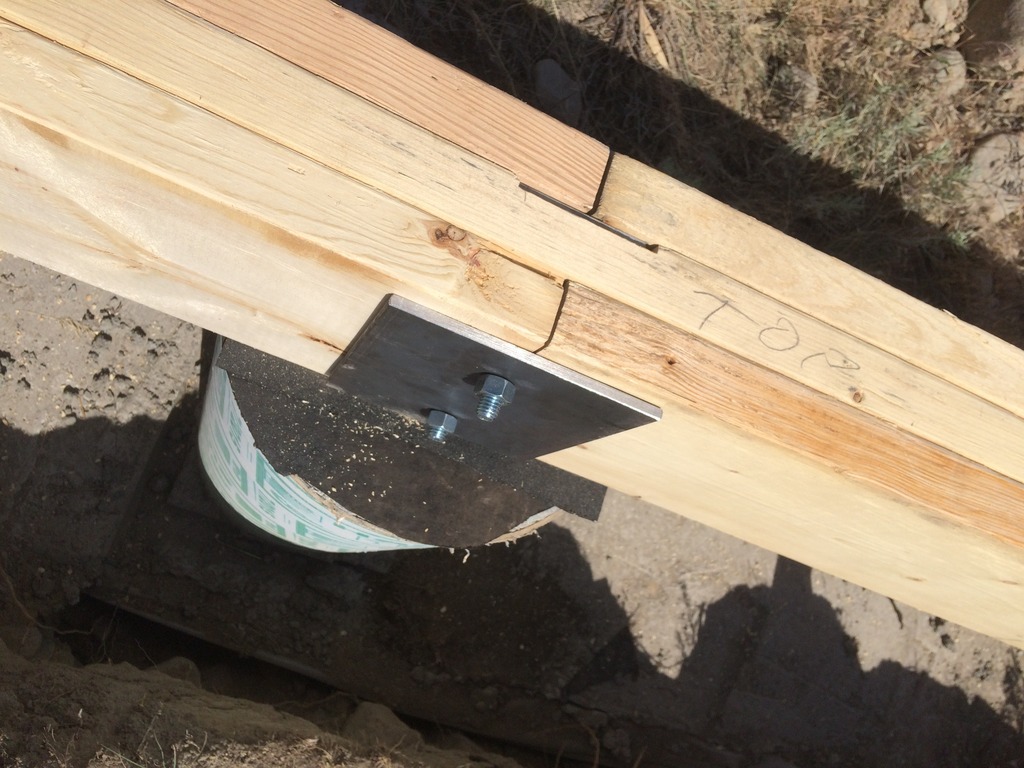

The anchors are 3/16 x 3" hot dip galvanized cold roll. I drilled some holes and added some bolts near the bottom of the anchor to prevent pull out.

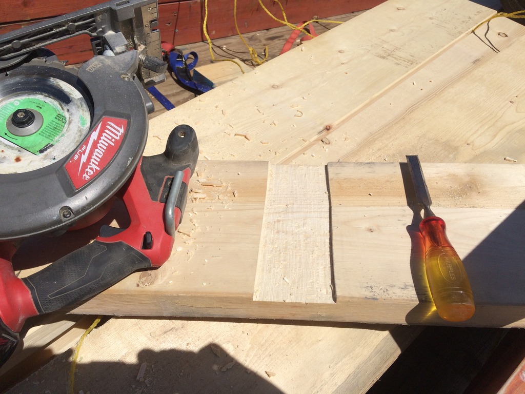

Built up beams with an anchor...

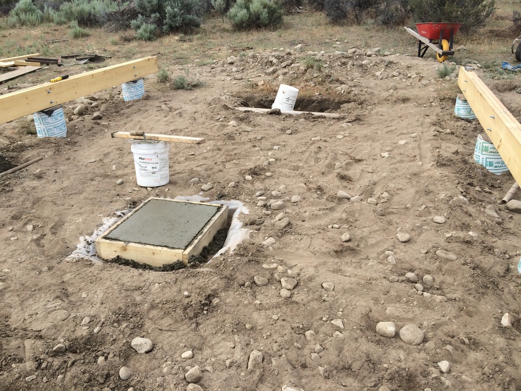

Concrete pad for the center beam support to sit on...

Looks like a great start to your project. I'm planning a similar project (16x24 cabin) a few thousand km's east and a few hundred km's north. Your pier and beam foundation is somewhat unique in that you've included a strip footing. I'm assuming the piers/columns were directly tied into the strip footing with reinforcing steel. If so, you'll have a foundation that is much more resistant to horizontal loading (wind) than many pier & beam foundations. I'm still debating between the pier & beam or a strip footing with a PWF wall. My site is very remote so every pound of material matters.
Are you planning to hang floor joists between the beams with joist hangers or will you rest the joists on top with a rim board?

Looks like a gorgeous location!  Your steel anchors will also minimize the chance of the beams rolling due to lateral forces.  That's a nicely done bit of work.  Yours is probably one of the few pier and post foundations that will get a grudging thumbs up here.   :D
You're assuming a strip footing is beam enough to take load down the piers, deliver it to the ground and not snap between piers. A strip footing is meant to be fairly uniformly loaded. Dunno. Look at pier and curtain wall as a minimum example. A rubble stone foundation pops into my mind seeing all that foundation material laying around. It would keep that impending wildfire out from underneath too.

Amen and amen...don't want to get too settled in my armchair here....but a pressure treated foundation wall woulda been an easy day, you'd have an instant crawl/ storage/utility space.....and it'd be to code....
