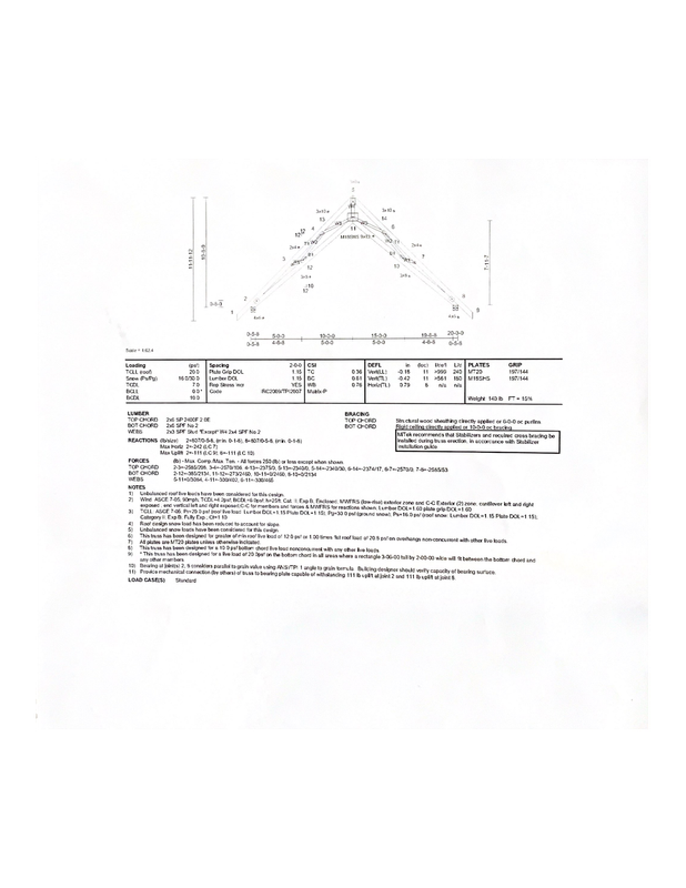

OK here is my truss design... It looks like I'm ok, but I'm worried about the loading numbers.
We don't have a lot of snow here, when we do its here and gone as fast. Winds are my biggest concern, we will have sustained winds for days. Not like Western Kansas that has 40mph winds and 70mph semi flipping gusts, but we will have multiple days where we have 20mph winds with 40mph gusts.
Reninco, thank you, good explanations.
KJones, It looks like .79" horizontal deflection. That means it is possible for the truss to push a long, unreinforced wall out of plumb that amount. To me that is excessive but it is a judgement call. If the truss is resting on a floor then that would be tying the walls together and no worries, if it is over something like a open greatroom I'd try to reduce that horizontal deflection.

I agree with Don_P, I would talk to the designer and mention this concern if you have long walls without any partitions. Also the design is based on peak values which may not be a concern in your location but its best to talk to the designer with this concern.
KJones I like the finished look of this style of truss as it always gives more volume to a cabin or house. Your plan specs are about the same as the comments I made for Nate. All wind conditions for your region are considered as is Nates comments. Mechanical fastener is requested etc.
If wind force is a concern lets follow the wind load...
The wind hits the truss...it will not blow off the top plate (addressed as a mechanical fastener needed) and if the top plate is fastened to the plywood sheeting with the correct schedule...and if the plywood sheeting is fastened to the bottom plate and if the bottom plate is bolted to concrete the load path is complete and not a problem. Also they are considering the dead weight of the completed roof assembly.
If wind intrusion is a concern...
Detailing for wind "intrusion" can be addressed with peel-n-stick underlayment on the roof sheeting and caulking at blocking. This should also include the gable end truss's. Caution should be used with standard venting procedures detailed in many code books. These become problematic with openings on the "windward" side. In my own house (featured in the build section) is built in a "constant" wind region where it is not uncommon to see speeds of +20 mph for 72 straight hours. I have sealed the windward side of my ridge vent with caulk because it was very obvious this was where any rain was going to go!

Don, thanks for the input, I went back and looked at some loading charts and talked to a contractor friend and he thoughts the loading was fine. I didn't talk to him about horizontal defection. I'm following the 1.5 story plan, with a loft and then open area (open for about 16'). Along on long wall there is a deck and there will be a deck roof merged into that wall (not sure it matters for this discussion just sharing).
I will call them tomorrow and have it reworked, but sounds like 0.29" is ok, is there a target (other than zero) I can shoot for? We will not be putting sheetrock in the greatroom, if we use sheetrock it will be in the bath and bedroom area under the loft. Again not sure it matters just letting you know.

That horizontal deflection is a judgement call. If both walls are equally "floppy" I try to keep it under around 1/2". This is not a strength issue it is a serviceability problem with no clear cut answers.
Framing of the gables with scissors is done wrong more than right. Studs must run unbroken from points of lateral support. That is, from the nearest floor to the underside of the scissor trussed ceiling. The truss shops often create a flat bottomed gable truss to go with the set. That is what you are seeing in the video. This is wrong. That creates a weak hinge in the gable wall. What you will see in post wind event pictures is that wall breached, the gable truss on the ground and the roof somewhere across the neighborhood. Balloon frame that wall to the underside of a scissor pitched gable truss. Less fun but much stronger and to good code.

The designer came back and said to hit 0.25" H defl that the bottom chord would be a 2x10 and the resulting heel would be about 24", that is to much height for me.
So question, since I'm just seeing the output of numbers and not the equations... The loading generates the deflection taking into consideration the lumber size/angles etc. That is my assumption here so could one of the following be a solution?
  • What if I doubled up rafters every 4 ft?
  • What if I changed the rafter spacing from 24 inches to 16 inches
  • What if I added a collar in the lower third of the scissor every 4 fit?
  • What if I used a tension cable every 4ft reduce the splay?
  • Sheathing the truss
I did confirm that is total deflection, so 0.395 per wall.
Whew, I doubt that this will blow away but regardless I want it to be right...
Thanks!
Strength is a life safety issue, a "must"
Deflection is a serviceability issue, it is a "may". Things like cracked drywall, opening trim, planes out of plumb, excess vibration. These are qualitative things rather than safety issues.
We'll be hitting 25mph sustained with 50mph gusts tonite, 70 is not uncommon. The vibration caused by that in a flexible truss is annoying/disconcerting even if it is safe so I err towards stiffer.
If you are willing to put a tie in, or cable it then in my mind you are willing to lower the inside pitch. Lowering the inside pitch will do the most, the cheapest... it creates more "tie". The other solutions may certainly work or help to varying degrees but I think you'll get the best look and function by lowering that inside pitch a little if possible. (Do coordinate that with the truss designer if doing that, pinning the wrong point can damage a truss.) Depth creates strength and stiffness fastest/cheapest. Have him maintain member sizes and grades but drop it 6"-12" lower at the peak and watch what it does to the deflection.

I agree with Don P on lateral support (lack of), serviceability and his suggestion on a slight truss redesign with slightly flatter inside pitch. I bet after you set them you'll have forgotten the change.
Realize they are using max wind for input and these are somewhat generic in code applications. Considering terrain variation: If you're building in a hollow you would never see peak wind...so you will never see peak deflection...but you might see peak snow loads.  If you're on a knoll of some type and see peak wind 3 times a year...well as Don P says a lot of the qualitative stuff with big deflections just gets plain annoying to live with.

I assume you're doing a 10/12 interior slope to accommodate head height in a loft?  Maybe drop it to 8/12 or 9/12 as suggested above, but increase the heel height to compensate?  This may be a simple design change for the truss designer, and might not be expensive. If you look at my truss design (posted previously/above), they just add a "spreader" wedge between the bottom and top chords to increase the heel height another 3 1/2 inches.

Yes I was trying to keep the headroom in the loft and not have to much wasted space in the corners where the roof meets the walls. It will be functional and we will use it.
Quote from: Don_P on March 01, 2021, 07:18:17 PM
Don, I have a request for a new design... 8:12 on the interior, I gave it a little extra heel height too, not sure if they will need it.

Well redesign has the horizontal deflection at 0.49" total.
They did revert back to 2x4 Top and Bottom Chords, so I've asked if there was room to gain a bit more based on Don's comment

Is 0.49" just to close to 0.5"? I'm thinking if I can squeeze some more why not at this point.
They were also about $450 cheaper too and 62% of the weight, which made me happy. I'm sure if they change something it will go back up.

Well here we go, what do you all think?
If the geometry is acceptable it is a better truss. If you need more headroom can you increase wall height a bit?
Take a look at both printouts...
Reactions are the same, both are bearing the same loads
Now look at the difference in the forces. By making the truss deeper the internal forces dropped dramatically. Enough that they are now able to use visually graded #2 SPF lumber vs high end machine stress graded much stronger wood in southern pine, and as you noted they dropped a size to boot. I'm seeing 3/8" horizontal deflection, looks fine to me.

Good deal! Lighter and cheaper than the first version too.
