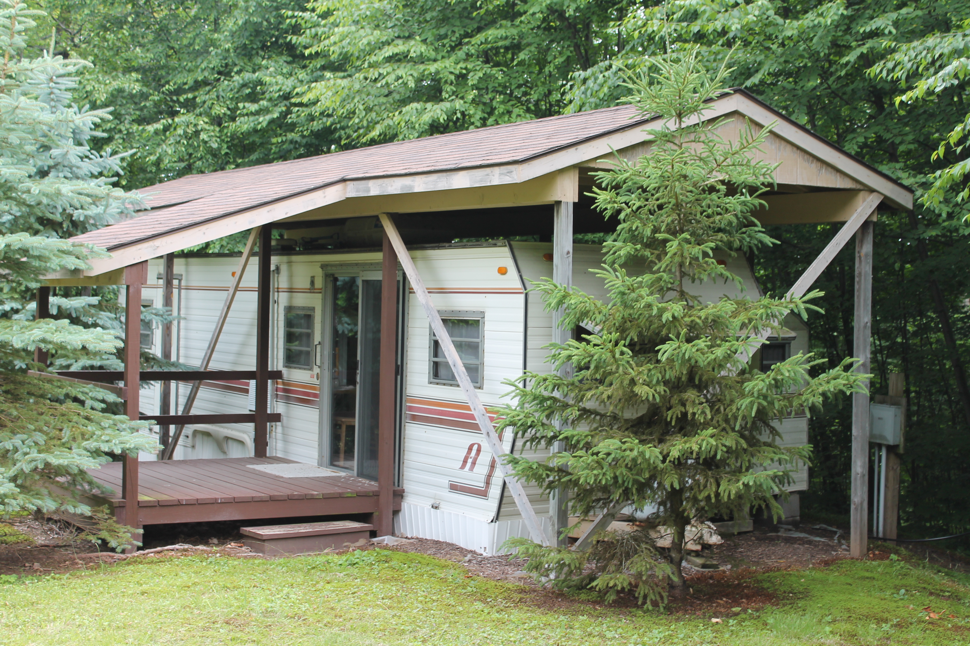

I am wondering how appropriate a post/beam construction would be for a standalone roof.
Been doing the math, and unless I want to wait another 8-10 years before being able to build my cabin, I may need to initiate plan B - parking a trailer on my land to use in the interim.
One of the main problems I see with the trailers are their very flat roofs.  Every one I have seen parked on a parcel of land somewhere remote wind up getting leaks in the roof and the subsequent water damage takes very little time to completely destroy the trailer.
If I go this route, I want to be able to build a roof system over the trailer to allow for some extra protection.  On one hand I don't want to overdo this since, well, add a couple walls and you have a cabin, but I also don't want to cheap out and have to redo it every year.
I see two basic methods when searching the internet.  The first is building a roof onto the existing roof.
(This is not exactly how I would do it but it gives a general idea)
The second method is to build something free-standing, that the trailer could technically be pulled out from should it need to be (and thus not causing any damage to it and keeping it resell-able if needed). Again I would not do it quite like this but to give an idea...
And an extension to that idea would be to make the roof wider than the actual trailer, allowing for a covered deck, possibly screened off porch to exist under there as well, but at least a deck that can remain mostly dry.
I don't see a foundation as being a workable idea for this kind of structure.  Post and beam seems like the only real choice here (also if this will be temporary I don't want to have to remove it later).  There would be typical snow bearing loads, but much less lateral loads since there are no walls.  I figure there would be a much higher need for uplift resistance with this kind of build.  So I wonder if those deck screws that go 48" into the ground would be something to consider for this kind of a build?  Or maybe a post every 4', one sonotube/cement/post - one screw/post - etc (so alternate between them)?
If I go through with this idea, I wonder if this would be a breading ground for bees and critters, wanting to live on my trailer roof since it is being protected from the elements. Would that potentially usable space be suitable for battery storage (close to the solar panels if placed on the roof)?  I don't have any plans yet, I wanted to get some feedback and ideas before making a basic plan, so I can cost it out and see if it makes sense before going through with any trailer purchase.  This would likely be a next summer project since my surgery is in a couple weeks... but might be nice to plan it over the winter so I am ready to go as soon as the snow melts next spring.
Adam there are lots of places up in the mountains of Idaho that people put those trailers under a cover as in your second photo.  They work very good.  Some get very elaborate with wind brakes and shade panels where needed and screened porch to the one side.  The way we built our deck on the trailer pad was to side it. If we are going to pull it out to go somewhere we pull the deck away from the trailer.  When we return I back it in and we just slide the deck back over.  In the winter there is a need to climb up there and scrape the snow off.  So wondering about just taking both fifth wheels down and parking them in the valley where there is not much snow or under cover at a rental storage place.  We have two a little one and the big one.  Love pulling the little one.....  We can just fly with it and actually at times just the same fuel mileage.....

UK4X4
nothing wrong with a bit of snow and a 5th wheel !
Ours was on site for 4 winters, only problem was the mice ! even though we'd filled in all the holes
We set a deck to one side and would have done a stand alone roof like the second photo above if we intended to keep it there long term.

"Traibins"... nice.  Yeah I think a cabin would be best, but I would much prefer a camper/trailer than nothing at all.  Many folks (and people I know) turn their noses to the idea, but if a camper means I can be in the woods soon than later then it's a winning idea for me!  I could also technically use the appliances from the trailer if/when I do build.  I like the idea of being 100% off grid, don't believe in TV's or even music when I am in the woods, nature is my entertainment.  I would consider some electronics to keep my 5 year old quiet, but only when I am getting desperate.

If you build the over-roof around the trailer, make sure you can get the trailer out if you want to use/dump the holding tanks.
The roofs on trailers are usually a rubber membrane. These fail after 10-15 years. Also, all the caulking needs to be checked once a year as it will crack and leak over time.
I don't necessarily think you need to build a roof over top the trailer if you take care of it.
In my opinion, building a car port for the trailer wouldn't be a bad way to go. Once you have the money to put up your cabin, you'll still have a useful structure.

So, been drawing up some ideas for a trailer port.  Looked at the metal ones but they cost over $5000.
I have some ideas for bracing using a "sandwich" technique, with 3x 2"x6" for the posts...
(X-Ray Vision courteous of Don)
Not sure how I could brace it side to side though, given that I would need to drive the camper in and out.
The narrow side would have a deck on it, and bracing could be done there... just throwing around some ideas.
