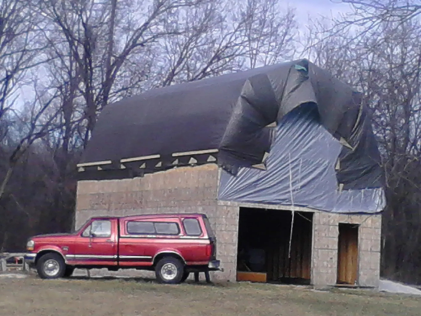

Sorry about not posting in awhile. My funds starting to run dry and had some family issues that needed to be taken care of. Plus the wife and I are self -employed (We own a small retail store). Had to get ready for the Christmas season. I did get the barn tarped  for the winter time.

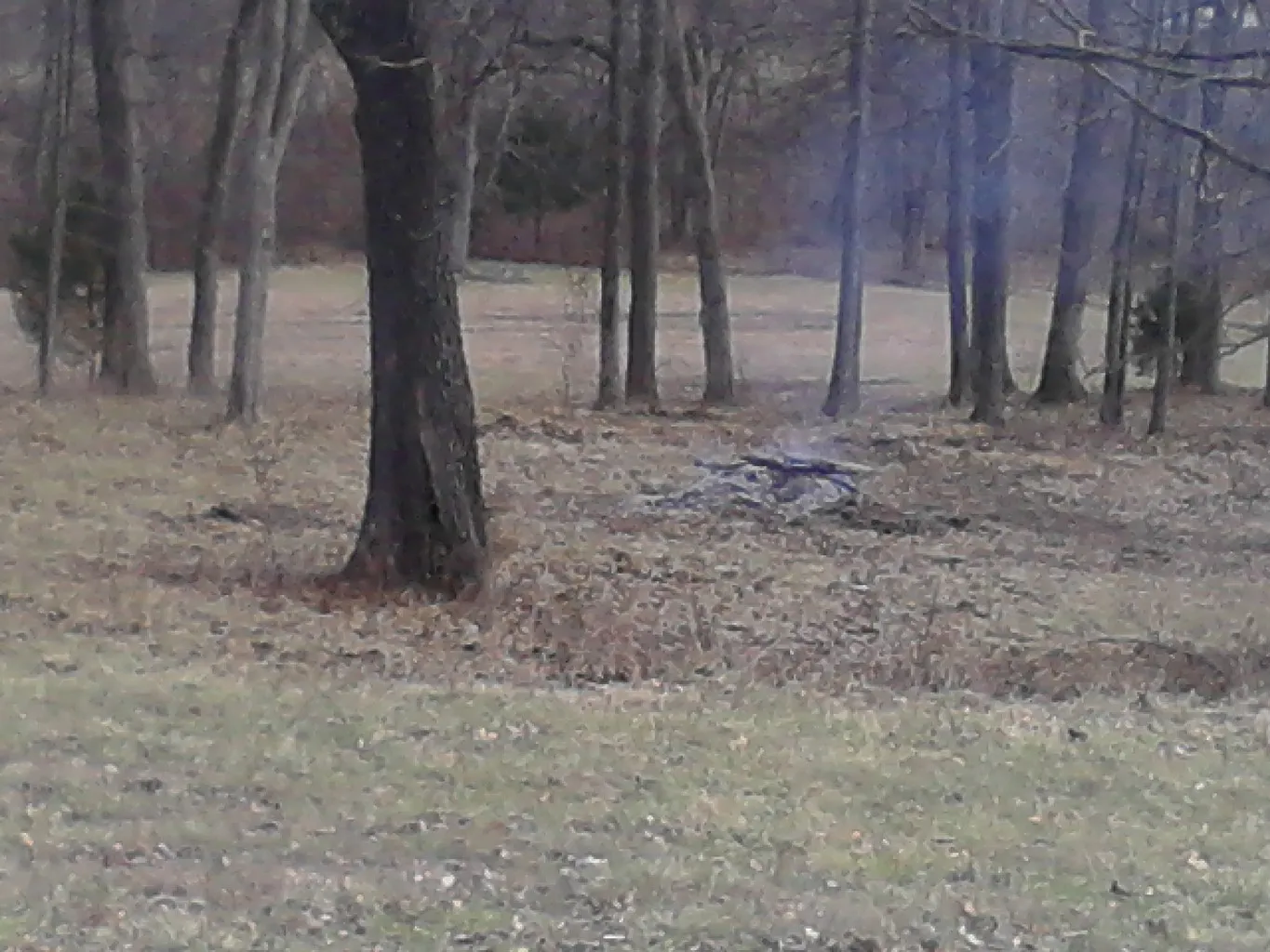

The wife and I did spent a little time cleaning up the ground that is going to be our back yard.
I'm hoping that I can start back on the barn in the next couple of weeks.

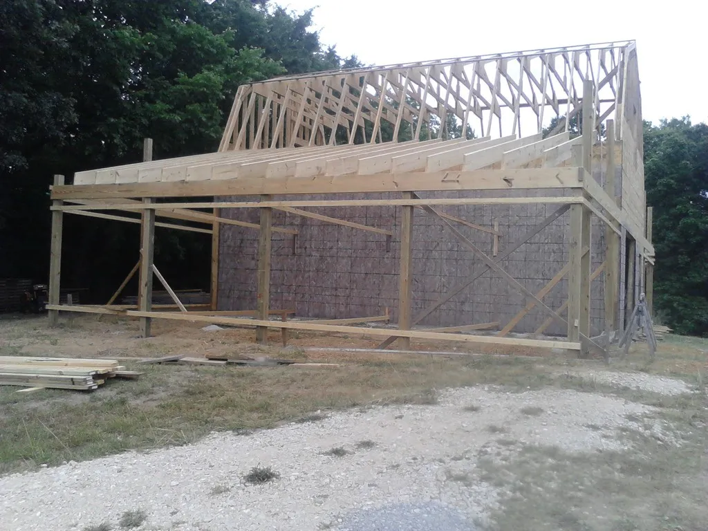

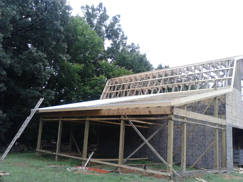

Well I finally got some time off! Got the post holes dug at  18'' dia  and put four bags of concrete in each one which gives me about a 16'' thick footing. Post are up and the header done with 3 2x12 at 9' apart. My son came out this Saturday and helped with the rafters which was a big help.  It's been getting really hot hear in Missouri in the last few weeks! Between 95 and 100 degrees so progress has been going really slow. I hope to have the metal on the roof by the end of July.

It's been awhile since I did a update! I did get the roof on before the end of July it's been so hot that I cant get a lot done . (95-105 degrees)   I hope to get the barn done by the end of the year so that i con start on the cabin.

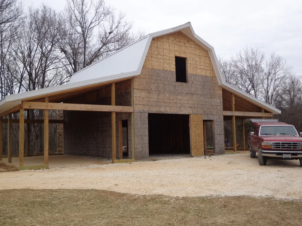

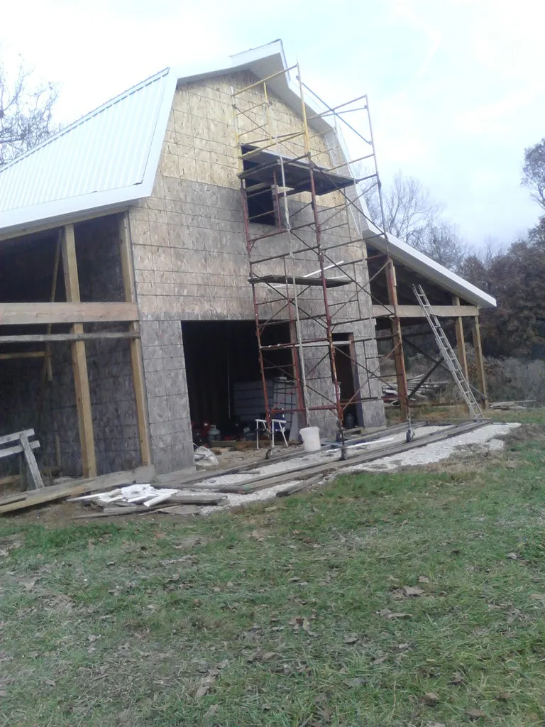

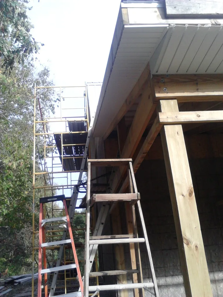

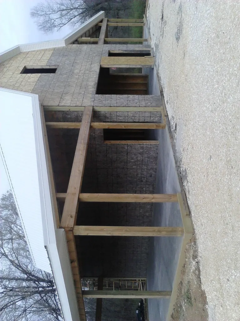

Sorry i haven't posted in a wile! I did git a little bit done last fall and winter. Got the OSB finished on the sides and the soffit finished and the corner rake on.

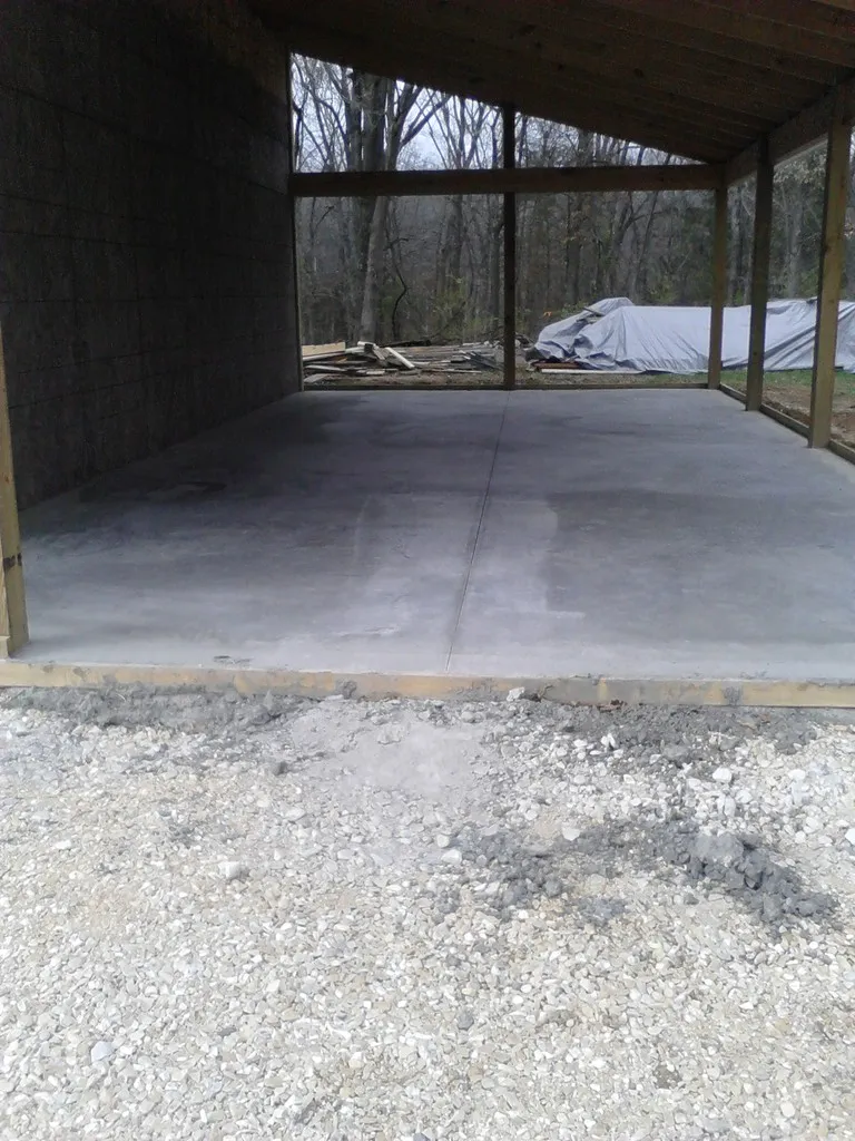

I got my concrete floors done.

dablack
Looks great!
Where did you get the scaffolding?
thanks
Austin
garyc
Quote from: dablack on April 19, 2017, 07:44:01 AM
Looks great!
thanks
Austin
The yellow scaffolding came from a friend of mine that was a fireman and part time brick layer that retired from both jobs so he sold them to me for $50 a section. His aluminum walk boards where in relay bad shape so i bought new ones at $120 a peace the walk boards cost more then the scaffolding. The red ones i borrowed from a friend that borrowed them from a friend that dose not wont them back. This barn is 26' tall! So the scaffolding came in real handy ex specialty when you are doing a lot of the work by your self.
