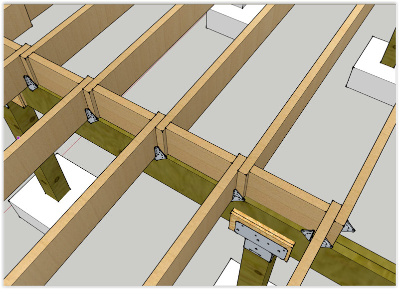

Like this then?  I made spacers of 3/4"+1/2" plywood on each side to fill up the AC6.

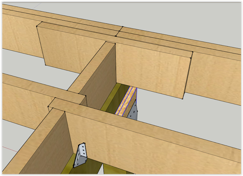

This is the opposite side of the same pier, showing that the joints in the built up beam are staggered.

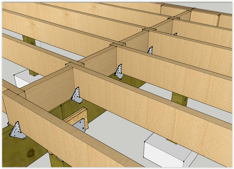

Assuming I have that right (there's that assume word again...), here's my next question...
I can't overlap the rim joist, it seems to me.  Is this an appropriate way of dealing with it?

One option you might consider is to push up the girder and butt the joists to it. You could use face-nailed hangers or nail a ledger along the bottom of the girder and bear the joists on that.
This would give you easier access to the crawlspace.
stoneturtle
Oh... oh that's smart...much less kludgey...   :)
