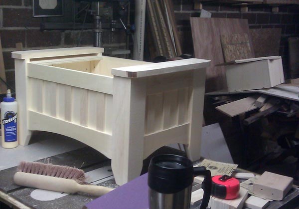

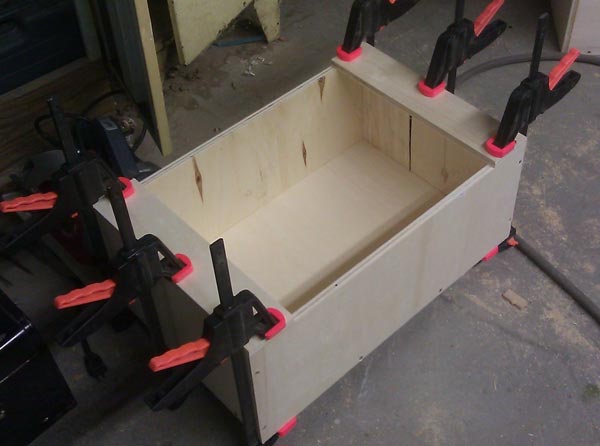

Started by building a simple plywood box...

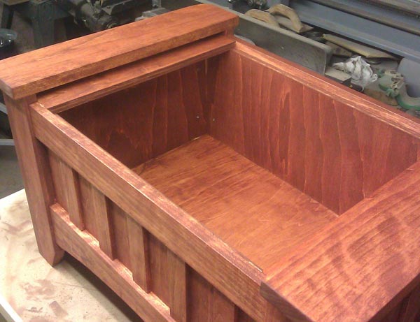

Then I added the legs and some other details to match the style of the futon frame.  You can see the plywood box and some other parts in the background of this shot..

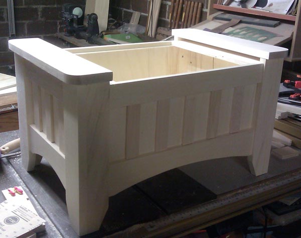

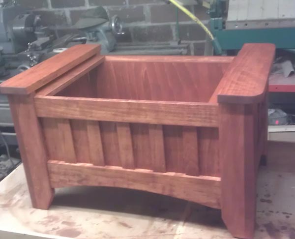

Here is a closer shot of the details...
I still have to do a bunch of sanding on the first one, assembly the second one, stain and polyurethane both of them and cut and upholster the foam removable  cushions.  We found some really neat burlap-like material with leaves printed on it for the covers.  Will post more as I make progress.

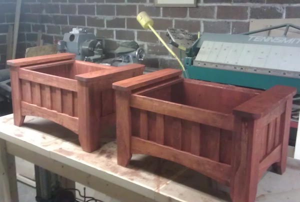

I got the other ottoman glued up, both of them sanded, and then Jill and I got them stained.  Tomorrow I will give them a couple of coats of polyurethane and then I will only have the upholstered cushions to make.  Looks like they will be ready for the trip to the cabin for Christmas.

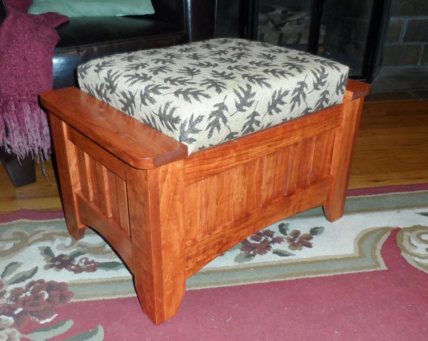

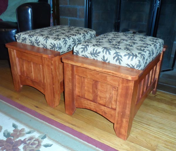

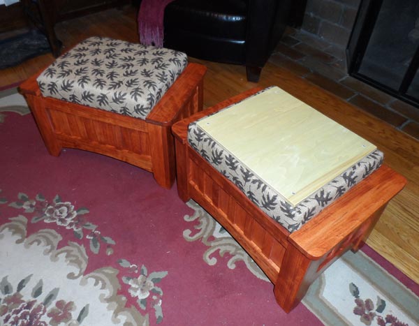

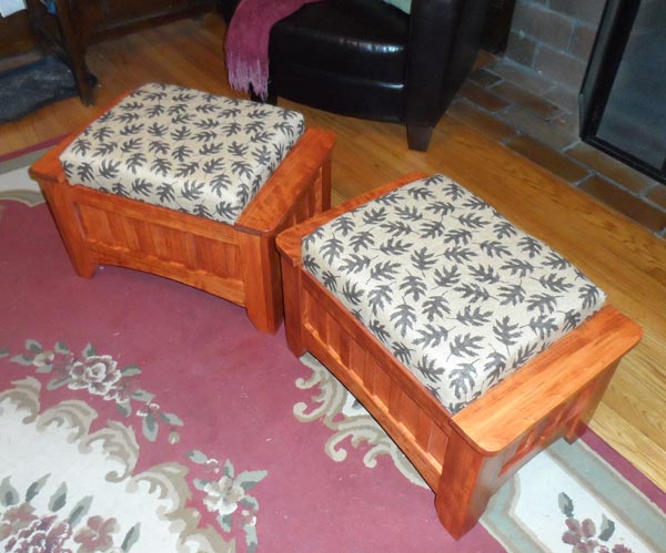

Jill and I finished the ottomans tonight.  We are very happy with the way they turned out.

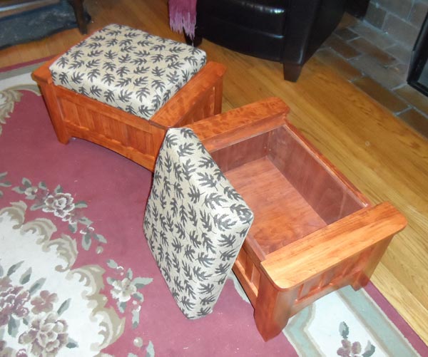

The cushions are removable to access the storage inside.
...and can be flipped over for a work surface/table.
