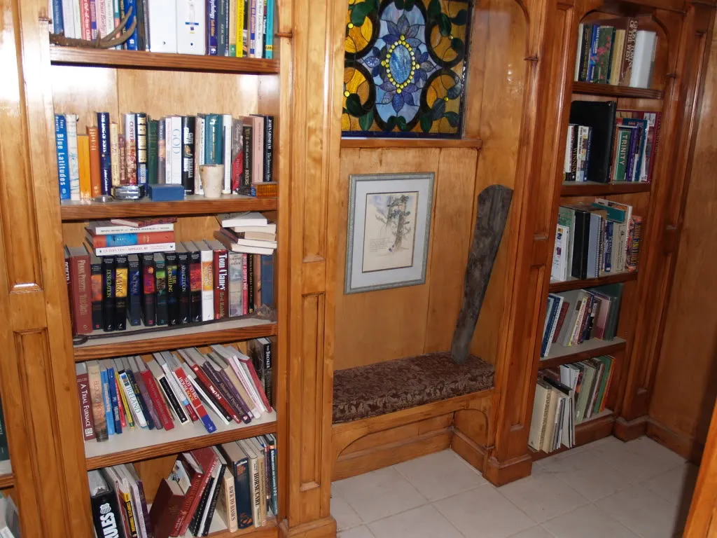

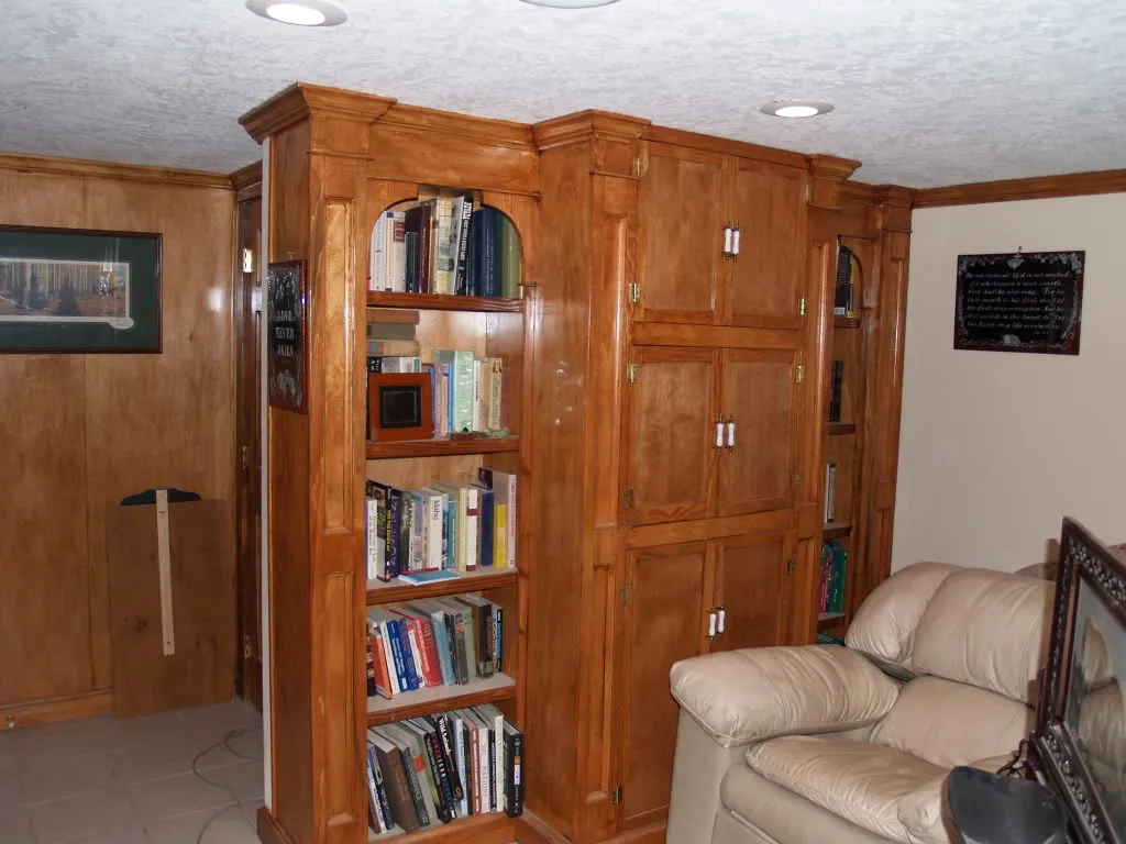

I keep wanting to post a project I did for my office a couple years ago.  Plywood was the cheapest I could find with the least amount of 'plugs' to work around.  It is of some unknown species.  Face frames are pine and moldings are pine and what ever else I could find cheap.  Whole thing still was way out there cost wise.  But it was fun to built and a joy for me to retreat to after a #$%$%$#% round trip on the train.  Like my last one, (Just got in at 09:30 this morning after all night.)  ((Whistle failed in route, first time in 35 years, I am so ready to retire!!))  So it was a lot of very slow movements over road crossings and we have well over 100.   d*  Then we did loose our air twice.  No air; no move, send conductor back to find air hose undone. c*  Go again!

That is really nice Rick.  That must have taken some time to complete.

As far as my bookshelves - Thanks!  The office book shelf project I think is the largest built-in wood working project I have done totally by myself.  Yes, it did take some time.  I am gone so much and when I am home I have to spread out my time of course.  The next big event!  Drum Roll!! The mill work on our retirement home, a 2250 sq ft single level retro Craftsman style bungalow home.  We got the plans and engineering back this week!!!  It is designed with a lot of built-ins, six interior columns supporting the room dividers, all will be stained wood.  A bunch of wainscot and some chair rail and picture rail and a Murphy bed.  Any one that wants to drop in and sand we will furnish the sandpaper and dust masks and refreshments.  Or hey anybody coming through Idaho after about the middle of August drop in and say Hi!  I promise I won't put you to work but can show you some of Idaho way-away from the potato fields.

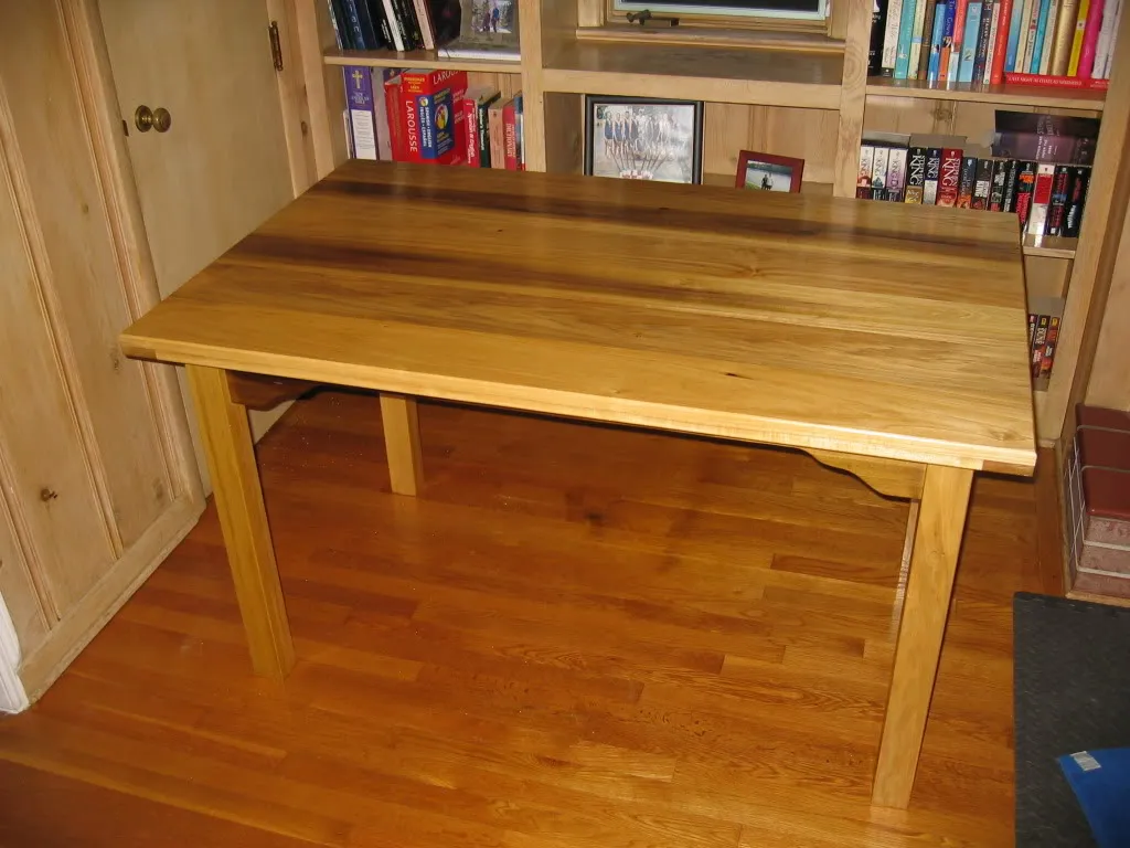

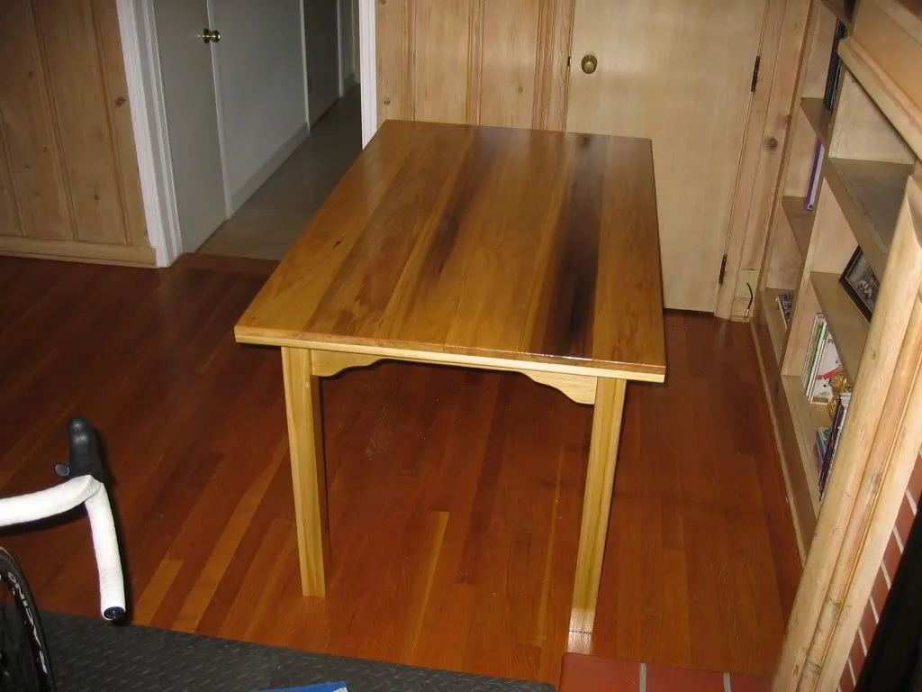

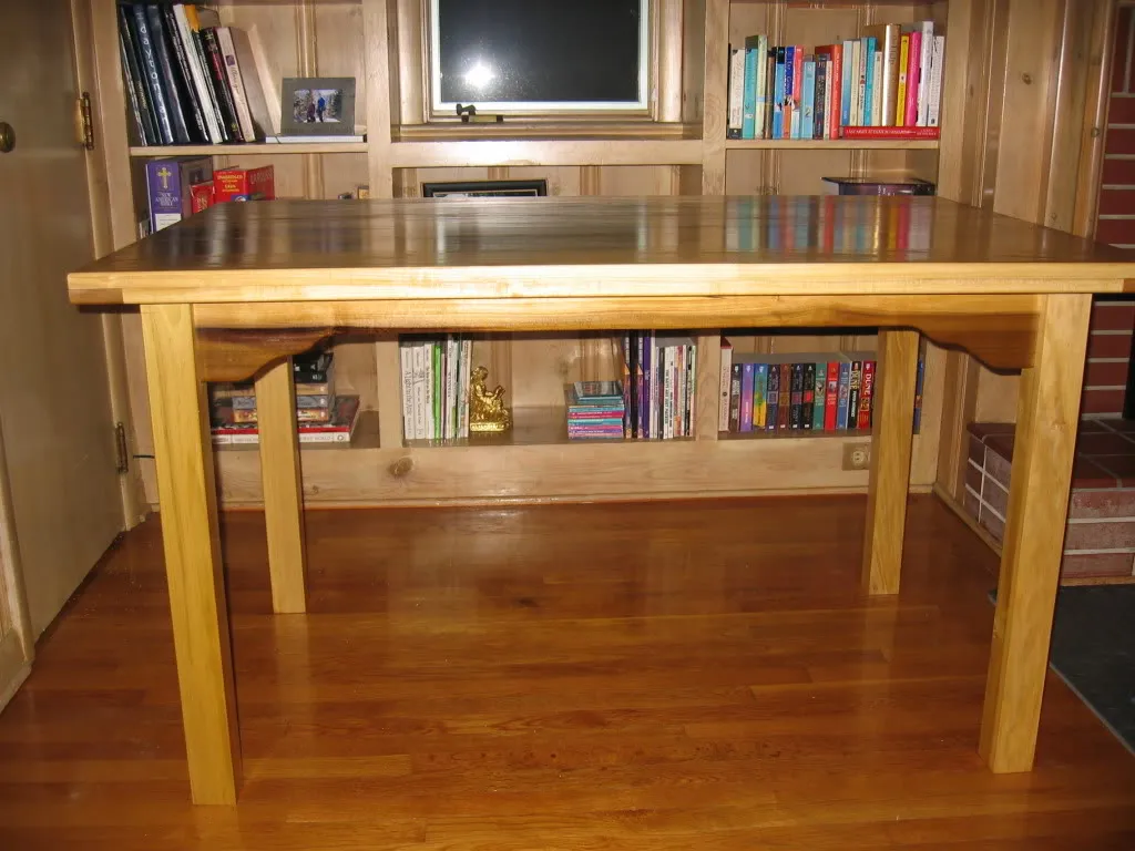

Thanks Rick, the table is basically done.  I put the last coat of finish on thursday night.  I have to admit after the last coat it looks a bit like varnish, but it hadn't fully cured so we'll see.  The waterlox did darken the wood to a nice color.  The guy at the store reccomended their semi gloss for the final coat, and I probably should have listened to him.   I'll post some pictures Sunday evening (eastern time).  Please start a build thread for your craftsman style home.  I love that style and will be interested to follow your project.  That genre will give give you plenty of options for creativity and attractive features.  I'm sure you have discovered but there are loads and loads of books out there for insparation.  Many available through the library.
Edit, pictures of the completed table added.
Also, here is the first part of the next project.  It's going to be a TV stand that looks like a sofa table.  Or maybe it will be a sofa table that functions as a TV stand. I am going to have to pick up some new router bits and a dado blade to complete it the way i have envisioned in my head.
The table turned out very nice!  That is a fun wood to work with.  I have a blanket chest cut out if it for my daughter, I came across it the other day.  It has been sitting for several years.    [waiting]
