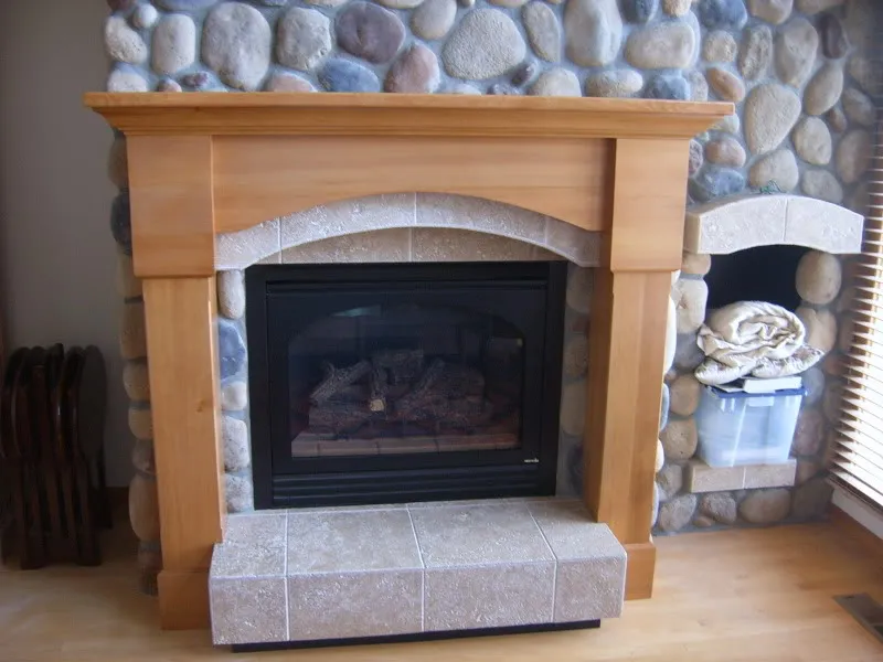

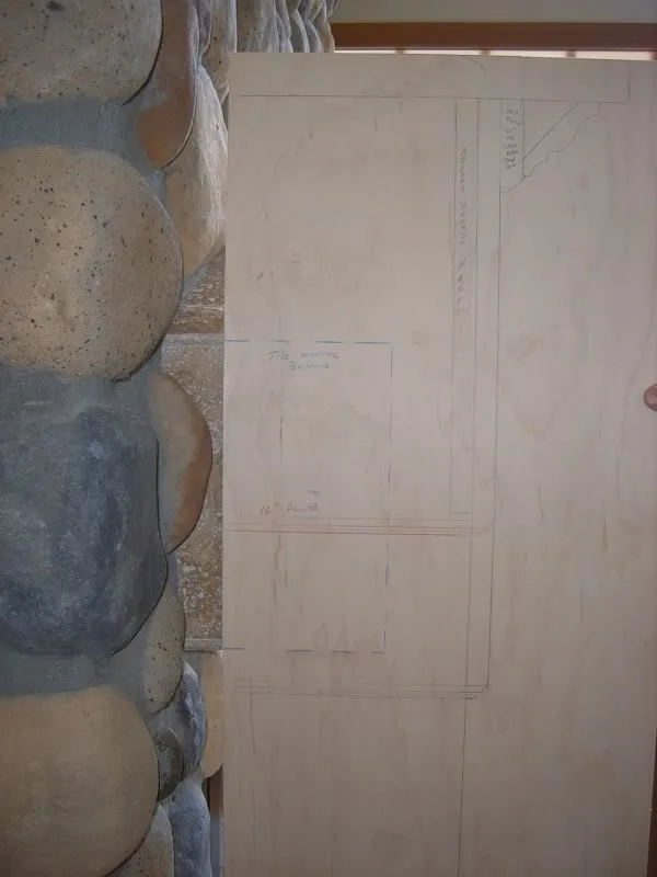

  Little VG Fir mantel,
  Still in work on it , hope to install it next weekend,

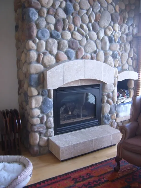

What they have existing ,
  Cardboard template for design / decision making reasons.

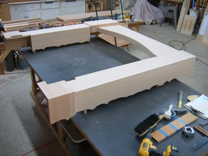

Pre fitting to the stone, I figured with all the scribing I needed to do pre fitting was wise
Disasembled for the trip back to the shop ,
Oooo! Nice. Excellent scribing. Looks like the wood grew around the stones.  :D
#484
Nice work Peg.  Shame they didn't decide to do that at the time they laid the stone it would have cut the price considerably.  I have a friend that is going to T&G a ceiling adjacent to a stone flue.  I had a hard time conveniencing him not to run the stone all the way to the ridge until the T&G on the ceiling was installed.  IMO it just makes a neater job and a lot less aggrevating.
 Thanks. They're about ten years into the house. I think at the time they didn't know what they wanted and that tile mantel was what they / contractor / home owners / tile guy maybe came up with. A lot of potential 'bad decisions' happen near the end of jobs , people just want to be "Done making decisions" which seem endless , colors , tile selections floor coverings cabinets , plumbing details etc etc etc.  So they 'pull the trigger'  on some odd things once in awhile.
 Yes,  it would have been easier to bring the stone to the wood and grout it, but hey it's work :)   It's all good.

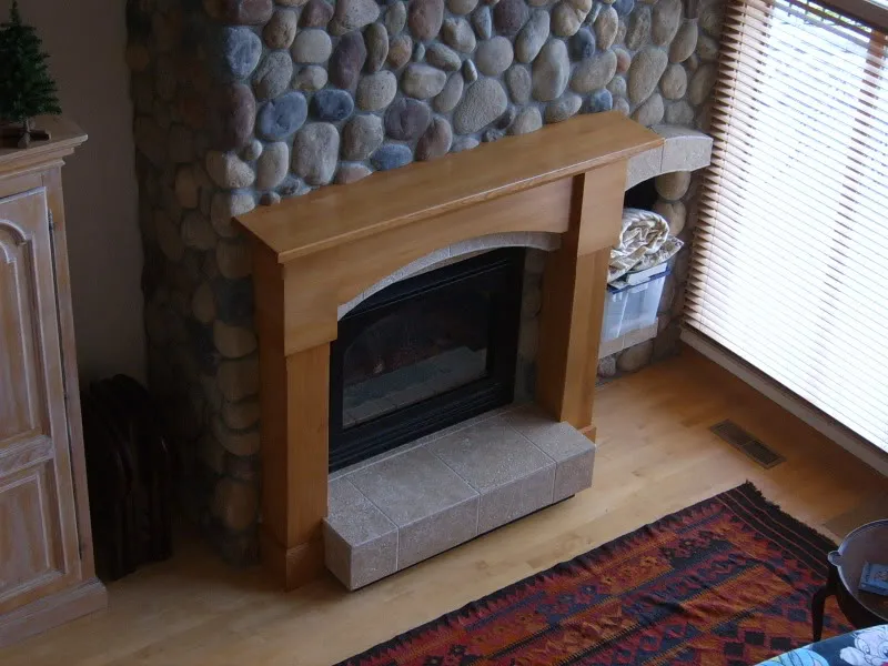

Got-er Done ,
View from above , 2nd floor balcony,
 [cool]    Looks great!  Is that one of your pieces just to the left?
Quote from: MountainDon on May 22, 2010, 10:35:26 PM
  Thanks , nope  just the mantel.
Wow, that's a beauty!  Great scribing - I bet they were really pleased with it!
Quote from: Sassy on May 23, 2010, 12:02:00 AM
They seemed to be, they payed me $200.00 more than the bill I gave them.

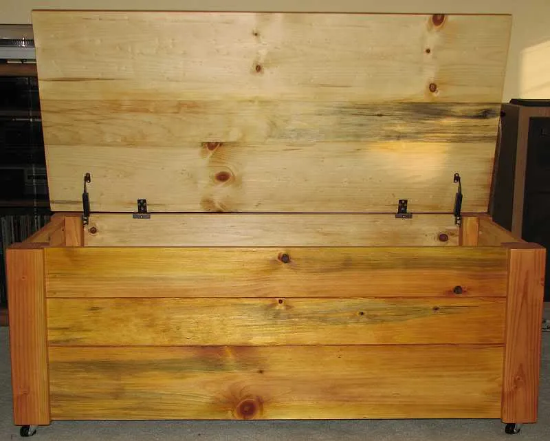

Here is my latest effort, a blanket chest made from pine boards milled off my cabin logs.  The idea was to mimic the look of the cabin.  It has casters on the corners so that I can roll it around.  It makes pretty fair bench to sit on, and we will be able to roll it under the table to give us more room if needed.
Here is the cabin...
Here is the chest from the front
From a diagonal
A with the lid opened
After the finish (Minwax WipeOn Poly over a water-based dye) is though curing I will put some red cedar in the bottom to give it that cedar-chest smell.

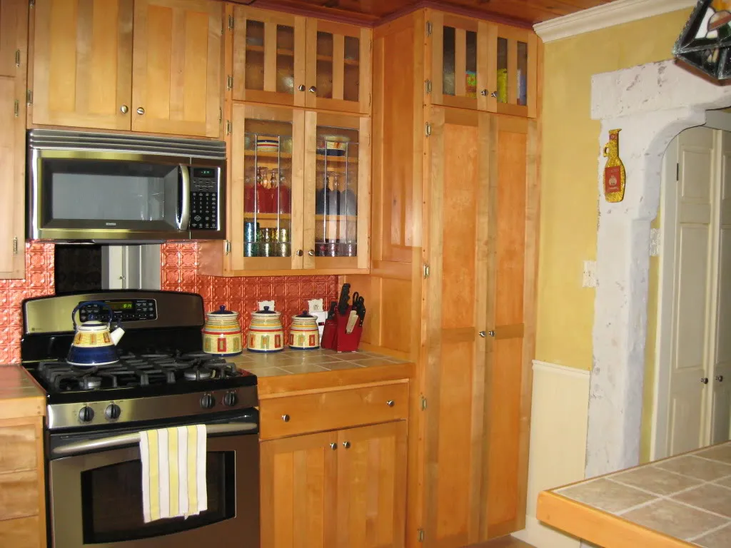

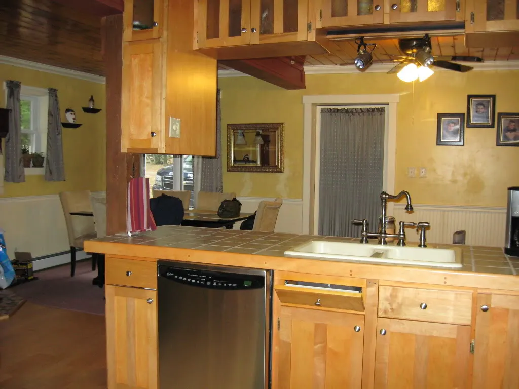

Here are a couple photos of a kitchen I built from scratch for the wife.
Mortise and tenon doors, pegged.
Flat panel, mixed maple, wash coat of stain.
Full extension shelves in the base cabs, so its easier for her to get the pots and pans out etc.
We also did the leaded glass windows ourselves, with double glue chip.
I assempled them and she soldered them.
They go to the ceiling.
The tall cabinet to the right is a pantry cabinet with full extension storage shelves (she loved this one).
Sink counter.  The two spot lights above the sink I made out of old brass plumbing traps and oar locks (she really likes those);

What species of wood was used.  Appears to be maple.
Chuck Adze
Yes it is....mostly mixed soft maples (variety), although I did used some hard maple.
The shelves are mostly tulip.
I used to be able to get rough KD hardwood for .80 - 1.25 a bd. ft. depending on grade.
