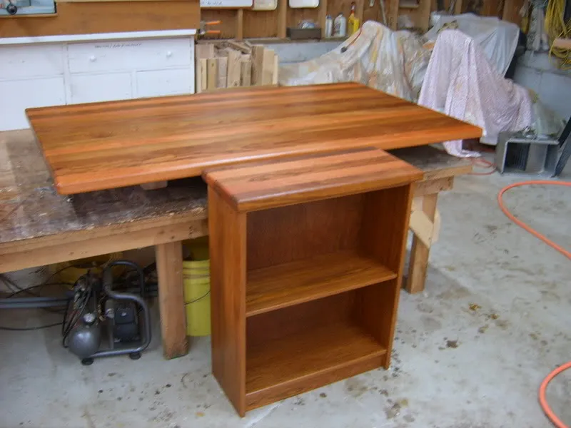

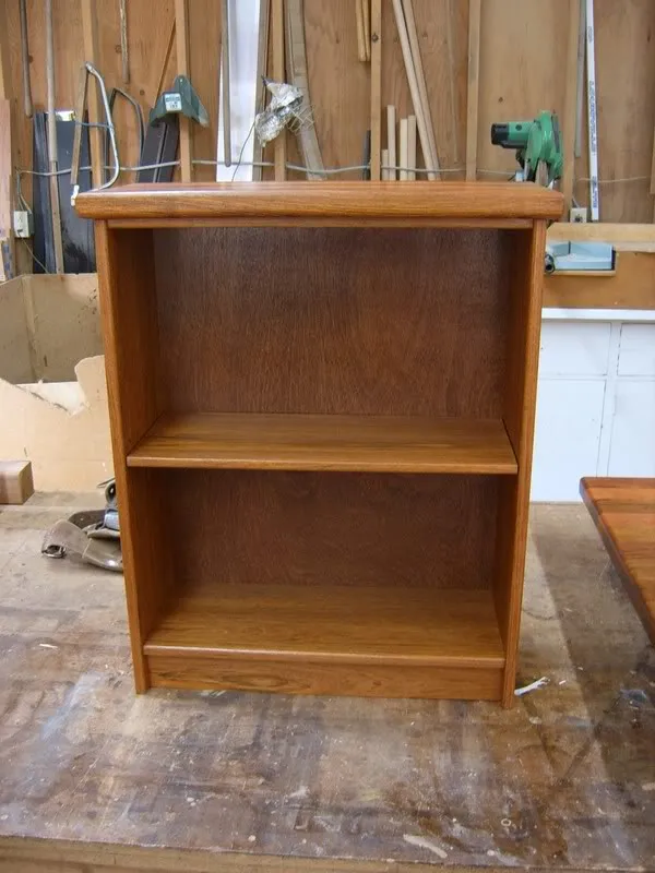

Got the book shelf unit assembled , so a couple of more coats of finish and I can install them on  Wed.
Nice Jatoba ply back as well, eh ;)
#153
Ok I confess :o the back is not really Jatoba  :-[, it Mahogany :) stained with a mix to match colour ;D
Thanks guys  ;)

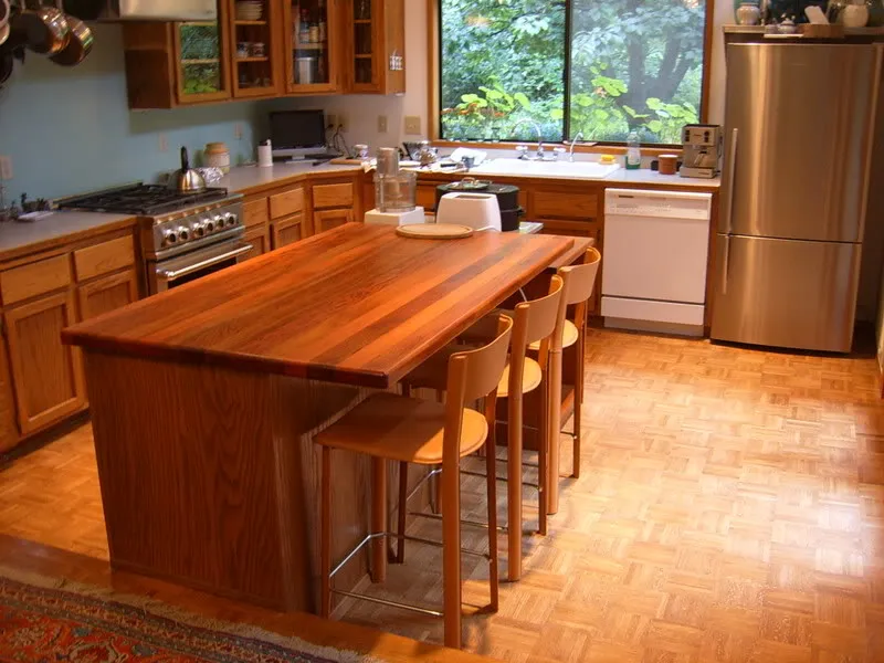

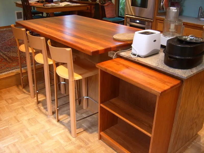

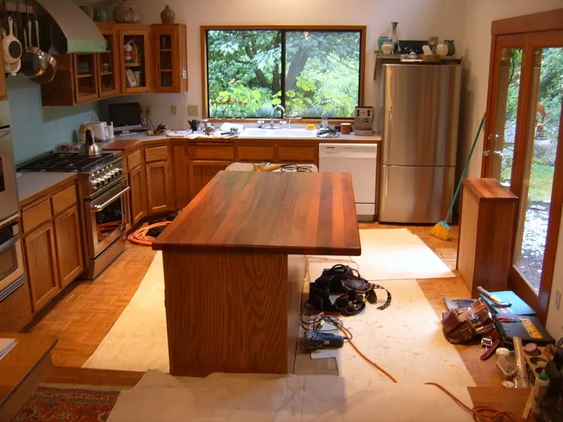

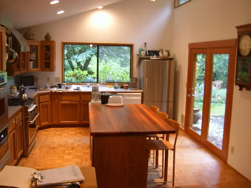

Nice unique one of a kind island.  Great job.
Wow -- I kinda sound like a real estate agent now. :-/
peg_688
 I made another Jatoba  island top about 7 or 8 years ago Mr. RealEstate man  ;D This ones nicer ;) The client said it was
"Gorgeous "  8-)

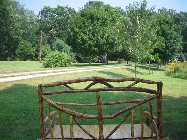

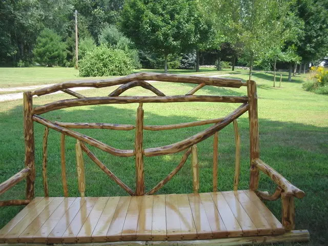

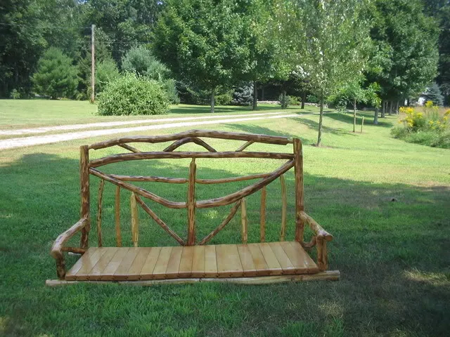

This is my first attempt so be gentle ;D  This is a rustic porch swing I recently made from pear, hickory, and maple.  The maple was rescued from the burn pile; the pieces were extra from a bowling alley overrun.  I drawknife the wood and construct with mortise and tenons with gorilla glue for a waterproof joint.  Tony
It takes some patience to fit all that together. Nice job, Tony!
peg_688
Nice job Tony  8-) It might be a LIL low though ;D
So is that ,((( Insert the name of the previous owner , Yessh I wish I hadn't deleted that PM  ;D )) , place  ?? Out in the Whipple road area.
#162
Looks great, Tony.  Did you make the tenons with the draw knife also, or just bark the wood?
PEG -- It's a swing-- you are supposed to stick your legs straight out. :)
Woodsrule
Don, Thanks for the kind words.  I do enjoy this type of woodworking. I've done other kinds, but these projects are very satisfying.
PEG, this piece is exactly the right size for me, since I'm a bit "vertically challenged."  Yes, this is some of my place, at the end of the driveway is North road.  Turn left and Whipple is about 300 feet down. The Chauvins would like what I've done with the stone as their ancestors were all masons. In fact, I've found two hand dug wells on the place.  We had to fill them in for liability purposes, but they were made with great skill, and I'm sure, pride.
Glenn,  I do rough out the tenons with my drawknife, then finish them with the Veritas tenon makers.  I used to do them all by hand, but Veritas makes a good product at a reasonable price, so I can speed up the process a bit. FYI - this piece took me about 30 hours to build, so I'm not getting rich by making this type of furniture. :)  Thanks to all for your comments, Tony

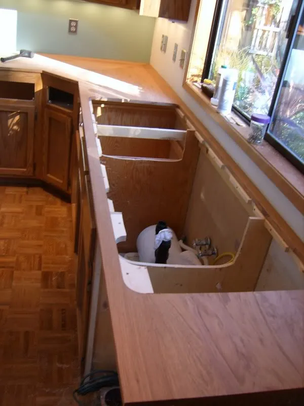

Well seeing I put the island top on this thread I'll add the rest of the Jatoba (Brazilian Cherry) top photos here as well,
big sink hole ,
Mitered corner,
Cam style "suck-ups" under corner,
Corner with Maloofs poly / oil finish applied ,

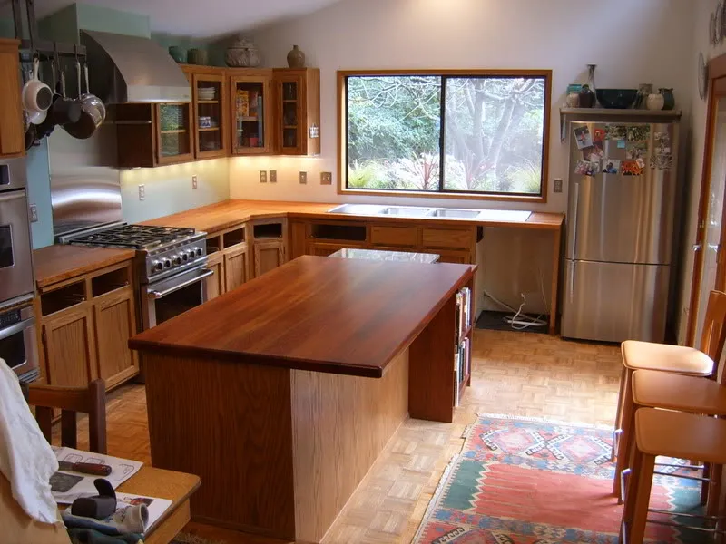

View from dinning room , things yet to do , install sink / dishwasher / S/S back splash tiles ,

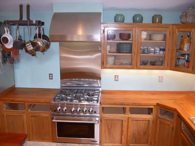

Oven wall ,

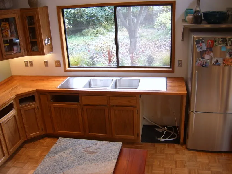

Sink wall, sink is just dropped in the hole to check fit and for photo op,
Nice work, PEG.

Looks Great Peg!  Any rough dimensions on that kitchen?  I really love the look of wood countertops.
Very nice kitchen. Those folks ought to to be quite pleased.
And that is a pretty big sink hole, no matter which one you look at.
