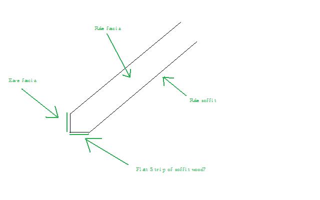

I took a bit of a break from the cabin planning for the last few weeks. I am getting near the end of drawing my plans (now I have to learn to use sketchup and make a 3D model). There have been a few small details that are bugging me so I avoided working on the plans. The most annoying issue is trying to detail the intersection between the rake soffit and the eave soffit. I want to use a detail like the one shown in A.
Also like this:
I thought that there would be a good reference for how to construct this detail but endless google searches and reading through many framing books did not yield the magic method. A number of the framing books approach the issue but they do not go into any depth (How to Build a House by Larry Haun and Housebuilding by DeCristoforo do the best job). I guess there are many possible combinations of fascia thickness and roof pitch to complicate the matter. I can figure out multiple ways to make this detail work but none of the them feel quite right. With my 9:12 roof pitch and a 1x6 rake fascia I get a 6.9" plumb cut at the rake/eave intersection. If I use a 1x8 eave fascia I would need to rip about a 1/4" off the fascia board to make this work. I was thinking I might install aluminum fascia trim rather than using a painted board. Ripping 1/4" off the fascia board would also require trimming the aluminum fascia. Anyone have any thoughts on aluminum fascia versus painted fascia board. Here is a pic of the detail that I have drawn in AutoCAD. It is pretty difficult to interpret with all the lines...
Here is another view:
Maybe those pics only make sense if you were the one who drew them.
If I use a 1x6 rake fascia then I would use 2x4 lookouts to support my 2x4 barge rafter. This results in a huge drip edge (over 1.5" on the rake and 2.5" on the eave). I am wondering if this would look odd or am I worrying about the small stuff. I could also move the barge rafter down by 1/2" to reduce the drip edge. That would also mean I would have to mess with my eave soffit details. Sometimes it feels like I am chasing my tail with this detail. I could avoid this trouble by using a "pork chop" but I just don't like that look.
That's all for now...I'll come back later with more of my frustrations.

I wouldn't leave 1-5/8 dangling myself, I'd rather rip or pad and get it somewhere closer to around 3/4 or so of hangey down... or under dangle, official terms I'm sure  :).
In your pic of the vinyl return notice the eave subfascia forms a flat at the end of the rake plumb cut. They've sort of fudged it out with the vinyl. On a wood soffit I run a flat strip of soffit wood on that level part and my rake soffit wood comes into it, bisect the angles in a miter for that joint. Now imagine if the eave sub were a 2x4 instead of a 2x6. You would simply make a level cut on the bottom of the rake plumb cut and that level portion of soffit would be a bit wider... I'm trying to be lazy and make you draw it, holler if that was clear as mud and I'll reread more carefully and sketch it if need be.

I have now read your soffit description three times and I just can't work it out. Well, the first time I read it was after a bottle of mead, so that doesn't count. I'm not really sure where the "flat strip of soffit wood" is supposed to go. I don't have my work computer with me so I can't play in AutoCAD. Here is a sweet drawing from Paint:
Am I picking up what you are putting down?

You got it  :), tune that level cut on the rake fly rafter up or down according to what you need for the eave fascia. It'll affect the width of the flat strip as you rise but that is about all.
