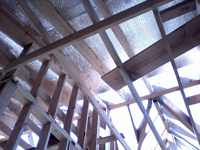

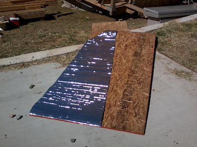

  Here's something to consider doing when putting up OSB----I had scalene triangles up 32' to deal with---No way I could hold OSB in place to mark it.
  Instead, I just carried lightweight radiant barrier material up and cut it with a box cutter right down the center of the valley and over the drip edge.  Then used that as a template on the ground to mark and cut the OSB.  The radiant barrier then got installed, with theOSB over it.
