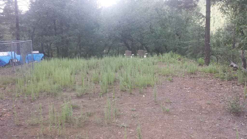

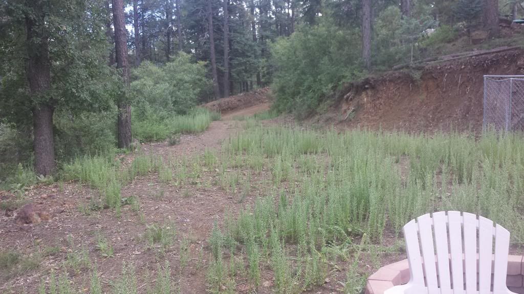

Found a piece of land I am interested in. It is a half acre on the side of a hill at about 7K ft. There is a flat area to build on that was cut out of the side of the hill several years ago. I don't know why it was never built on.  When is it advisable to get a "soil evaluation"? Before I buy ? after? Only when required to by building department? From what I have been told it can be quite expensive but also important.  ???
Also, what type of information will I receive? Will it just be the type of soil, compaction etc or will it also include advice on foundation type and setbacks from slopes?
Here is a couple of pictures
Thanks!!

Looking at your pics the soils look to be good and well drained, no obvious quagmire or clay, can't really see how much of the plot is cut in and how much is spoils, ie you want the foundation on the undisturbed portion
