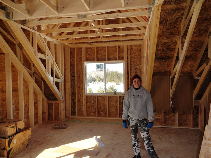

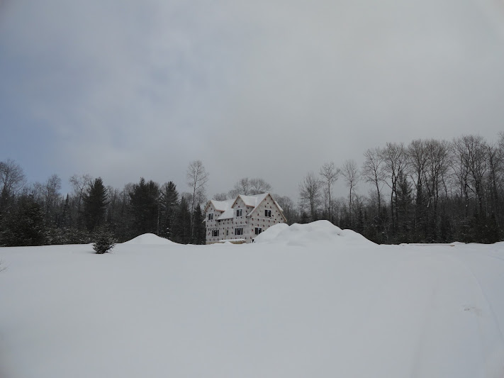

Some more views

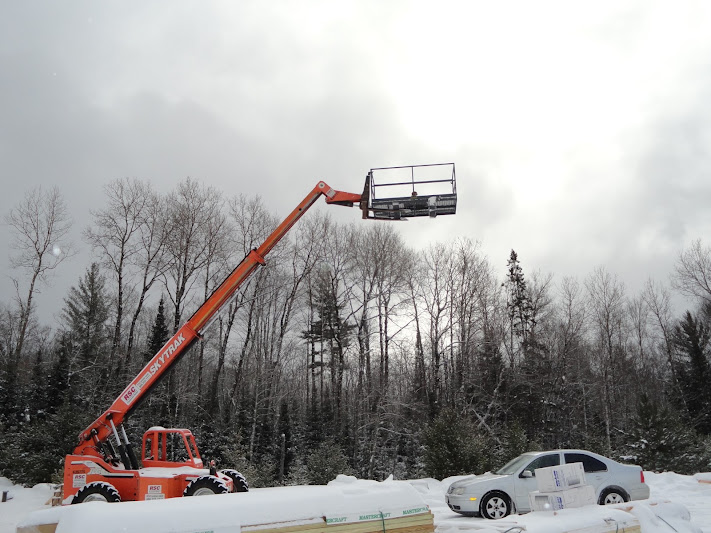

I had a little fun with the lift today.  I have some video, but I can't link directly with Picasa.
One of my best employees

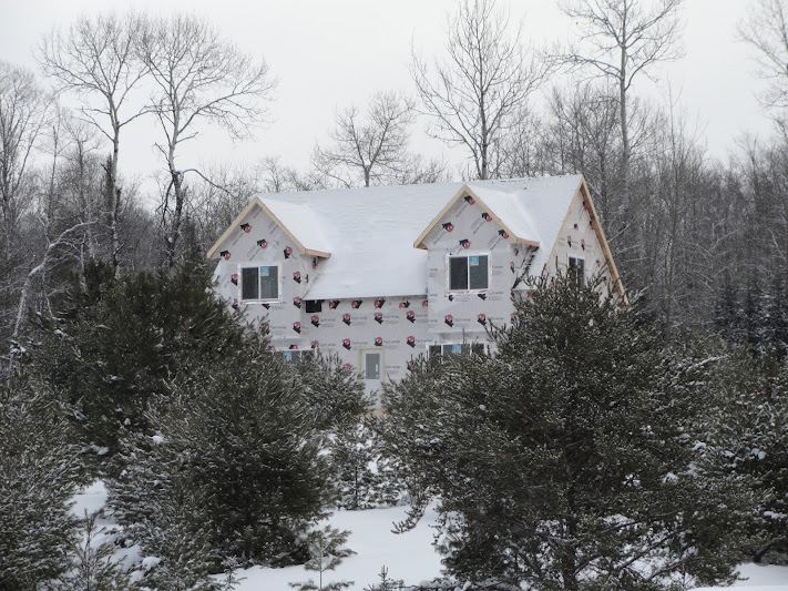

The roofing and siding will start on Monday.  They will do everything they can without the porch.

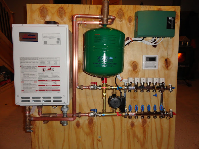

While the builders have been hard at work, so have I, albeit to a lesser extent.  Here is a picture of the hydronic system I designed and assembled to  serve as the primary furnace in my soon to be home.
It is a 6 zone system heated with a propane-on demand water heater.  I still have to wire up the heater control and install the gauges.  In-floor heat is truly a wonderful thing.
Please ignore the galvanized piping, it was used for "mock up" purposes only, and will be replaced with regular gas piping.

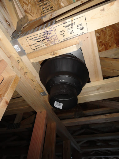

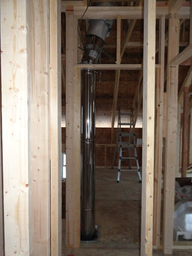

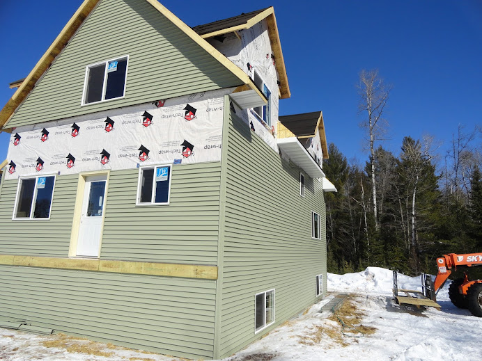

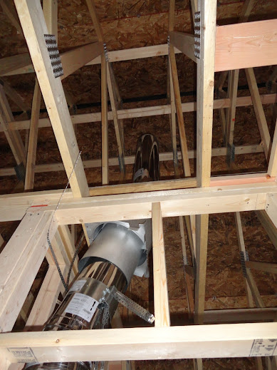

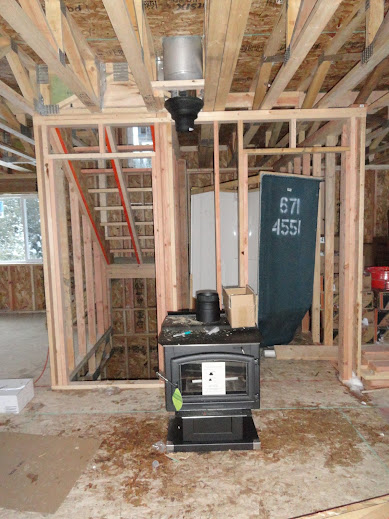

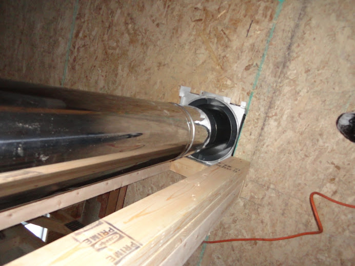

A good weekend at the building site.  Some of the roofing has started, along with the siding.  My wife and I were able to assemble the woodstove and most of the chimney.  We decided to move it from the original location so it would be more centered in the house.  We feel that the original location would have taken away from the clean look of the house, as it required a very large stack with supports.  We were also able to move many of the building materials out of the elements and organize them inside.

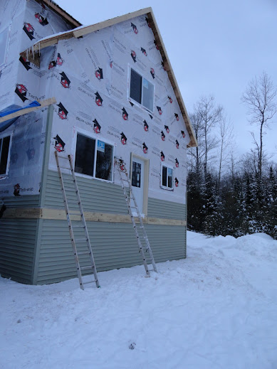

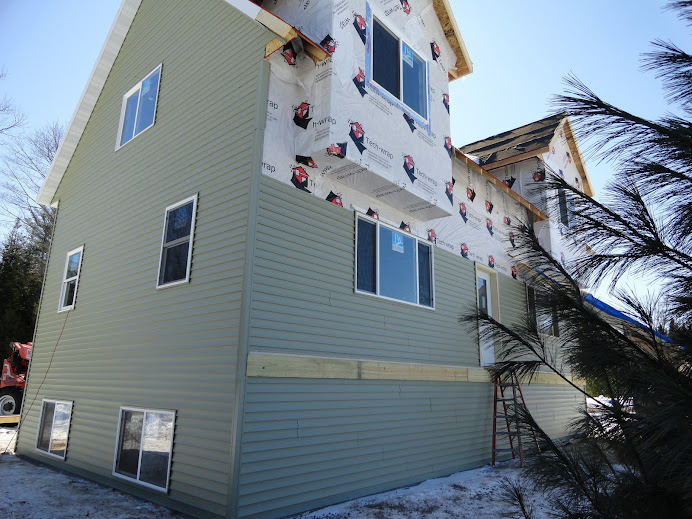

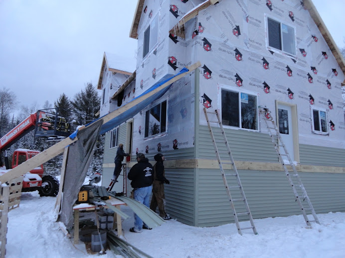

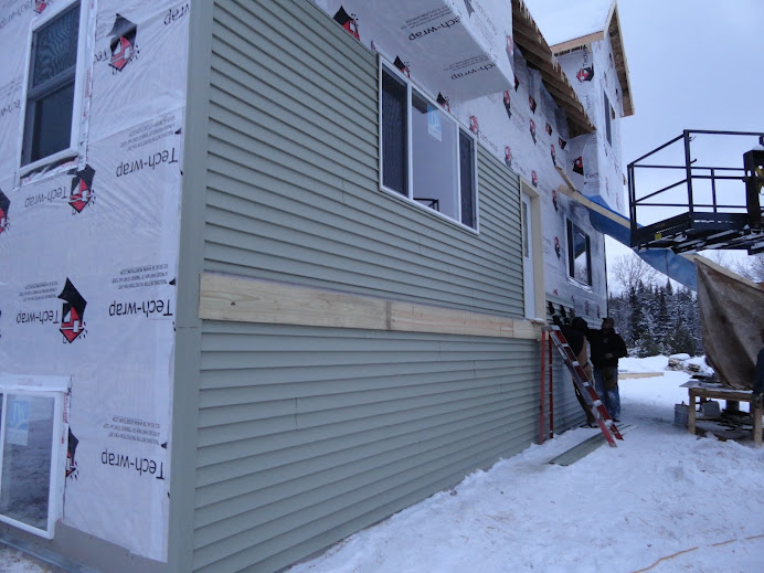

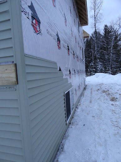

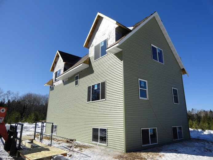

Pictures from the weekend.
They made good progress with siding, and some soffits and fascia.  High winds and snow prevented further progress.

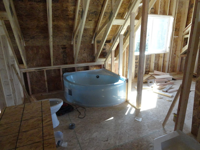

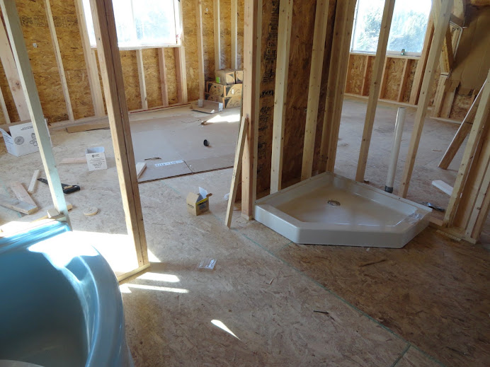

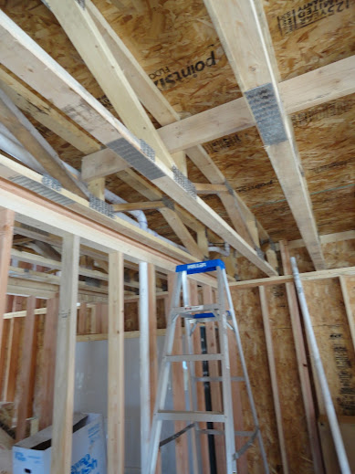

My wife and I started work on the plumbing.  The upstairs tub and shower stall pan is in and connected.  The corner tub was especially tricky, as the drain was on one side of a floor truss, and the overflow on the other.  It's difficult to see, but there was just enough room to straddle the truss and run the overflow through the webbing  to rejoin before the trap.

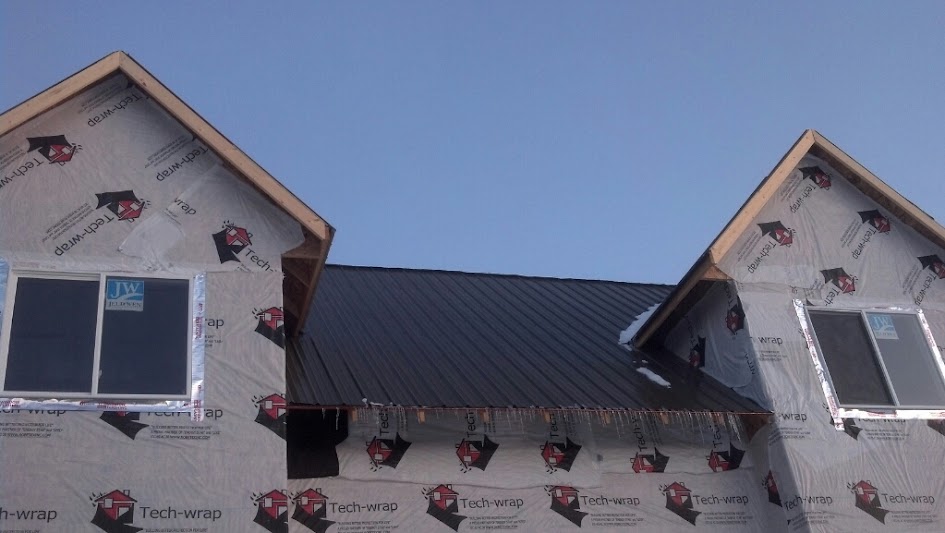

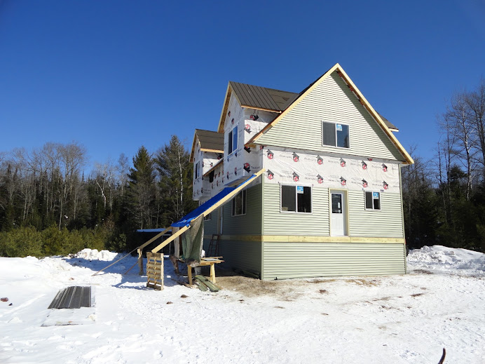

Time to post some progress pictures!  The time spent there was shorter than expected, but much was accomplished.

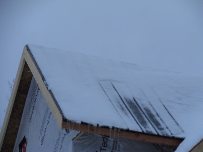

The roofing on the existing structure is nearly complete.

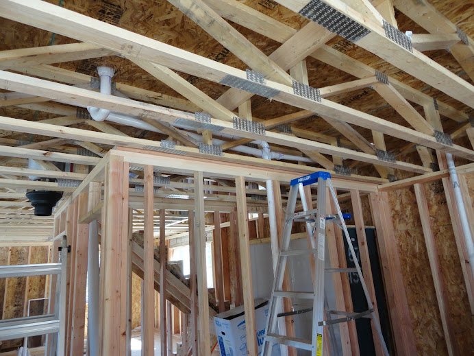

Good progress was also made on the plumbing.
Kitchen Sink
Bathroom Sink Stack
Bath Sink Stack Vent Merge

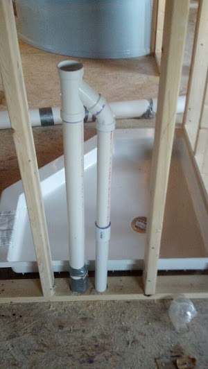

Upstairs Toilet-this was tricky.  The location of the drain was a bit to close to the wall to clear the tank, but immediately in front of the drain location is a double floor truss.  To solve this problem, the tank is going to project into the wall a bit, which is why the studs have been removed.  T&G is going to be installed behind this toilet to cover and provide support for the stairwell drywall.
Upstairs Shower Trap, Shower and Bath Vent, along with the Kitchen Sink Vent.
Kitchen Sink Vent merges with Bath/Shower Vent
Sanitary Tee for 2nd Floor Toilet

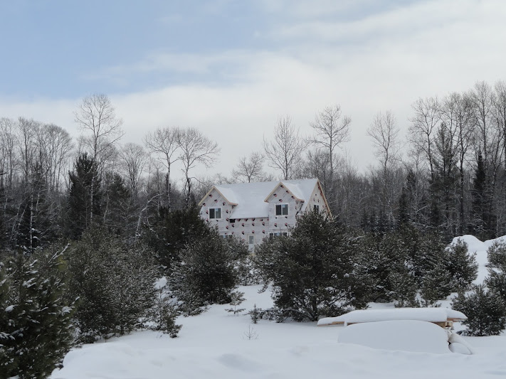

Thursday Morning View
Probably a little late to mention but they do make an "offset" toilet flange that will give you a couple inches.
mgramann
I had never heard of those, very interesting.  Thanks for the suggestion!  Now that I did the work, I think I'll stick with my other plan, as it has an added benefit of having the toilet project into the room less.
