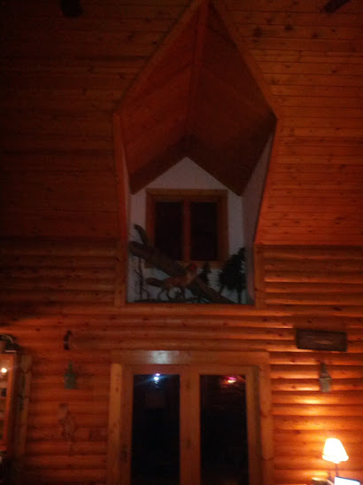

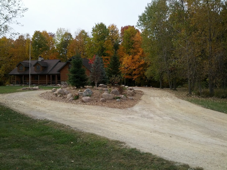

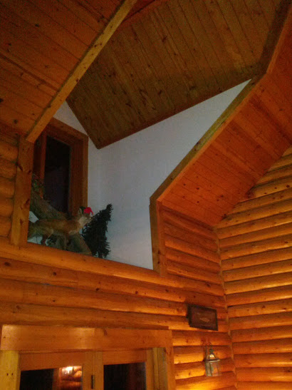

    In regards to your single dormer looking lopsided, I put 2 dormers in my log home with a 1/2 loft.  One dormer is in the 22' cathedral ceiling of the great room and adds an interesting feature to the ceiling.
    SouthernTier
    Thanks for the input.  Those are beautiful dormers!
