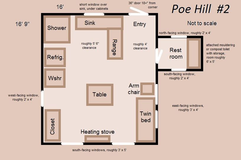

I roughed up a small plan for the cabin's inside and thought I'd post it to see what others think.  It's not the first and probably won't be the last so any and all comments are welcome.  A couple notes on it - I just eyeballed things in MS Paint but on paper I did scale everything and figured measurements to be sure it fit.  And I noticed I got the site's slope wrong in the first post.  Not sure how I messed that up but the ground falls to the southeast (and the plans are set like a regular map so the top is North, right is East, and so on).
P.S.  I know the print shows up pretty small in this one.  On the next I'll make sure it's bigger.
