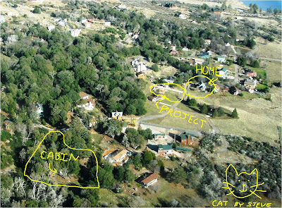

    Here's where the various projects are situated.  If I can buy the vacant lot uphill from where I'm building now (the cottage) we can walk between them all without crossing anyone else's property

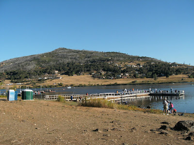

  This is from the lake looking back where the neighborhood is.  The top of North Peak is just under 6000'.  The cottage project is at the top of the meadow across the lake.  The meadow is floodplane so no one will ever build to block the view
