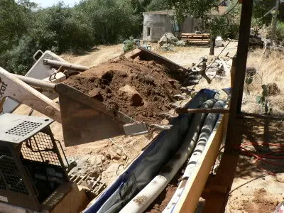

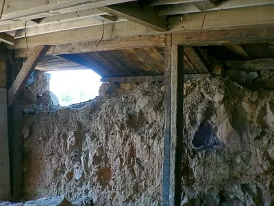

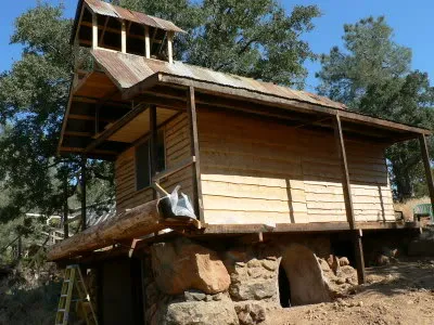

I got the West walkway covered clear out to the end now -- I drove the Bobcat over the parking area with a full bucket - should have weighed in at about 14000 lbs.-- Half of that was supported by the bridge timbers .
Getting more cave-y looking all the time.
My buddy gave me that big stack of corrugated iron the other day so I can continue to expand at no cost. :)

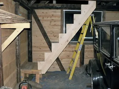

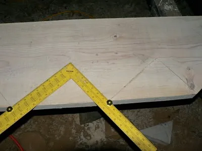

I cut a 2 x 14 for the steep stairs and started laying them out.  I am limited for space to get to the loft so went with a 9 3/4 rise to 7 1/2 run.

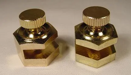

I set the stair gages for that rise and run to make layout easy.
Here they are on the square for laying out the stair.

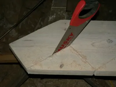

I cut to the corner with the skill saw then finished with the hand saw to keep from weakening the stringer by overcutting.
After I made the first one I tried it - made a couple of slight adjustments then it was ready to use as a pattern for the other stringer.
The thickness of the tread must be taken off the first riser.  The top riser must come out flush with the second floor so be sure to allow for it.
There are different ways to do the stairs -- this is just the way I did mine - note that this is not a code stair.

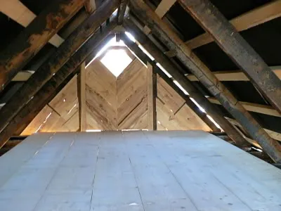

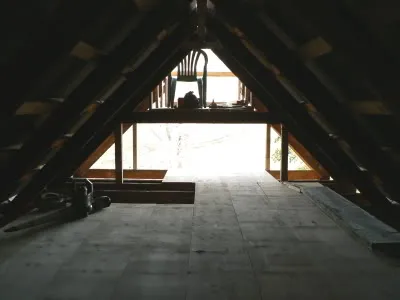

The grandkids were up Saturday wanting to do something, so we put extra joists in the loft to cut the floor span down to 24" spacing.  This way I could use 3/4" boards and conserve my good logs -- still plenty of bridge timbers left.  Danny, our friend from the valley came up to help with the floor.  He considers it his recreation.
I cut 1x16"s 20 feet long for the loft floor decking.  They are green and will shrink about 7/8" overall -- the gaps will be big enough to fill with strips, and , hey - it's just a storage loft in a garage. :)
Thinking about putting a tempered glass with wood diagonals over it here.  Chair is in the cupola.
Holes are almost small enough so I won't lose any small children through them. :-/

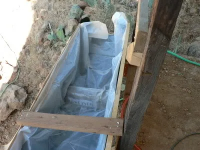

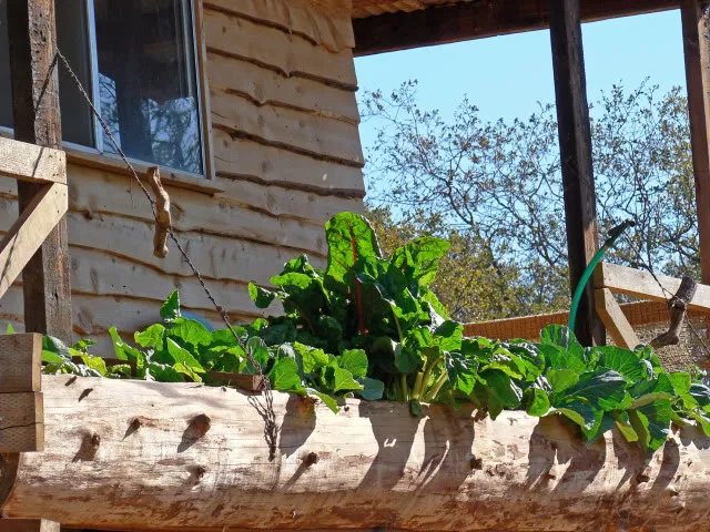

Our friend, Danny came up today to help do a bit more on the Garage.  Project of the day was getting the planter done so we could get a crop in before winter.  I needed a guard around the front - rail coming soon, and a place to keep plants away from the large rodents we call deer.
The planter is made from a log slab - first cut cap 20' long.  It is about 16" deep and 18" wide at the top.  I wanted to be able to grow root crops.  Also by using a slab I could tell PEG it was the log that was crooked - not my building.
We put boards under the plastic to make reservoirs about 2" deep in the bottom - also gave us an easy way to splice the plastic by lapping over the board.

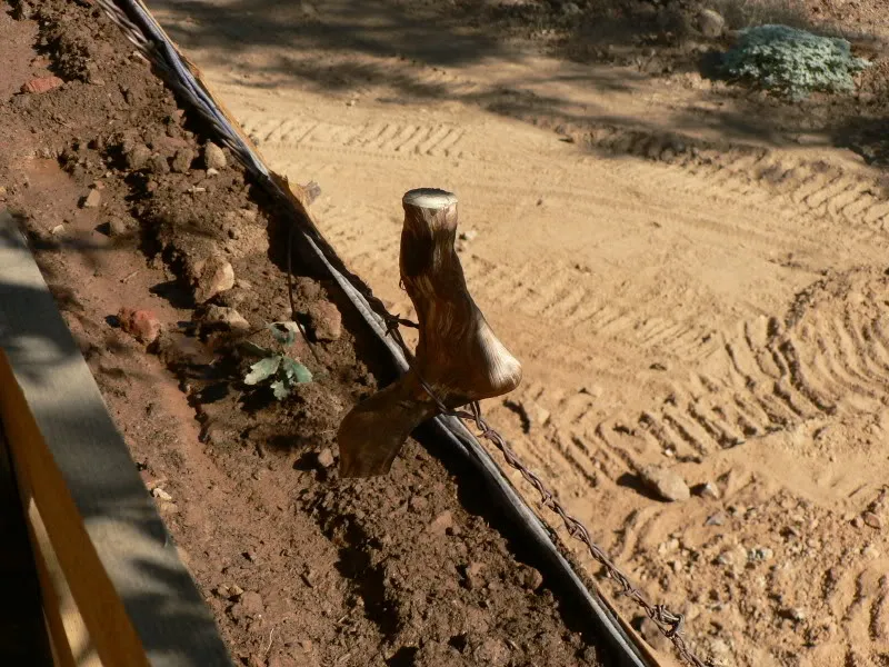

Roots need air and water to grow so we put 4" drain tubes in the bottom with socks over them to prevent clogging before putting in the compost.  This will also store water to keep things growing well.
I wanted the supports to match the scheme so used old barbed wire to help hold the weight.  Note the dogs leg bone used as a winder to tighten the wire. :)
Just kidding there --it's really a piece of wood that looks like one --- yeah -- I know --I'm one sick puppy --- maybe because I'm missing a hind leg--- doggone it-- I have to stop this. :-/

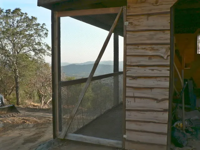

Well - more progress today but not because I wanted to or had time.  I went to water the plants in the planter and the stupid deer had eaten about a third of them  --- so deer proof the walkways to the planter.
It takes about a 7 foot fence to keep them out so I made gate frames and covered them with aviary netting.  Then I had to put up hand rails to make a fence so they wouldn't jump behind the doors.
The hinges were made from reinforced fire hose cut into rectangles on the table saw then shot on with 1/4" crown x 1" staples.  Latches were made from bent nails.  The fencing is jute landscape erosion control netting stapled to the hand rails and floor framing.  It should last about a year unprotected from my previous experience.

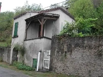

And maybe something along these lines.  This is somewhere in Tuscany but a definite italian cousin to your building.  Maybe you  and Sassy need a guesthouse near that future pond.

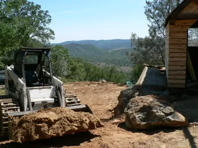

Tore up the mighty Bobcat last weekend - told my buddy,Al and he was down here determined that we were going to get it fixed immediately.  We ganged up on it, tore it apart on Sunday afternoon -- clear into the belly of the whale-- and found the problem.
While working on a bit of fine grading around the outside of the bedroom on the Underground Cabin, the idler shaft lock nuts came loose allowing the shaft to drop into the chain case and the final reduction idler gear to roll around loose in the case.  With Al's determination and ingenuity we were able to repair the shaft, replace the damaged bearing cup, get a spacer from Chicago and get it back together tonight.  Not bad for a couple of good ol' redneck boys if you ask me.  We are working some barter on my old truck for the labor.  Trading is good. :)

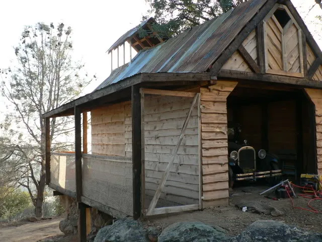

Expansion time has come.  We made the rock walls around the raised garden beds beside the garage, and now comes time to fence out the deer before they eat everything in sight.
This couldn't be a simple straightforward fence job--- no way.  Before I do that I have to put the addition on to the right side of the garage as the fence has to hook to it.
Can't do that until I regrade the drive to keep water going the right direction.
Can't build the framing until we pull more nails out of the bridge timbers.  Get a bunch out and am not satisfied with the quality of the timbers so have to get more.  Then comes grade- I decide to brace posts and level with a 4 foot level.  Stakes are driven into the claystone and rock soil. Posts are drilled and stood - beams fit as necessary to hook into the RV garage.
Two things are key here - it must be near free.  It must look decent and old.
Just in time a friend brings over a load of 2x4s and timbers, and mentions he has corrugated metal at his house for me.  He was going to bring it in a couple weeks but I said I would get it as I needed it now.  There goes -- blew my budget.  40 mile round trip in the Dodge uses about $9 worth of diesel.  Then nails --- had to buy roofing nails at the store.  Bummer that cost $2.59 a lb for 2.5 lbs -- there goes another $6.50.  Wow - this hurts. :'(
This area is to be used for the steam engine and other old antique machines - a bit of a museum.  Sassy wants room to sit around out there in the shade also -- guess I'll have to see if I can make room for her. :-/  Hope she doesn't get mistaken for an antique. :o
Pictures in the next day or so.
OK - I wasn't ready to show you this but I didn't want you to think I wasn't doing anything so here it is in all of it's unfinished glory.  More to come soon.
Following the progress, such that it is   ;D  . Can't hardy wait wait till the end of May rolls 'round and I can take off for the mtns. all summer and get some work done myself.
Every time I try to do one thing I have to do six other things first.  Clean up piles of lumber - steel dirt etc.  But -- it continues one thing at a time. :-/
