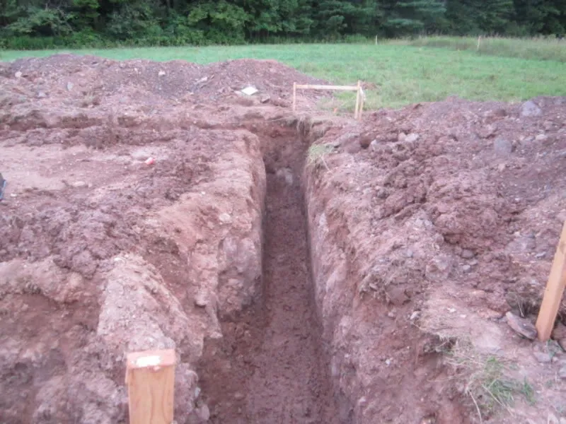

Yes this was my first time with an excavator.  I have worked a few front end loaders, but not backhoe's, at least that I can remember.  The ground was harder to get through than expected.  The machine was pretty easy to work.  They have the joystick like handles and it swings just like a digging arm.  I found it is easier to chop away at the top and work your way down, as opposed to trying to scrape up a vertical side.  When you hit a rock, it is easier for the machine if it is not pulling the 3-4 ft of compacted dirt with it.  Also to break the shale, I pulled the bucket as far out as it would go, and pushed it down against the rock. This would give the full force of the machine and its weight to break the rocks.  Some were so big, I had to dig around.  You can see that in the third trench (the right 30' side).  It was probably 3'x3'x2'.  With delivery, diesel, hours, damage waiver, and cleaning it was around a $50 an hour learning experience.  Well worth it.  I did find that either it is very difficult to keep an exact depth or I lack the skill to do it with this machine.  I will not be using an excavator for my septic.  Because I only have to go down 13" through silty loam for my grey water leach field, I will be renting a trencher.  Because I can put it on a trailer, it is a lot easier on the wallet too.

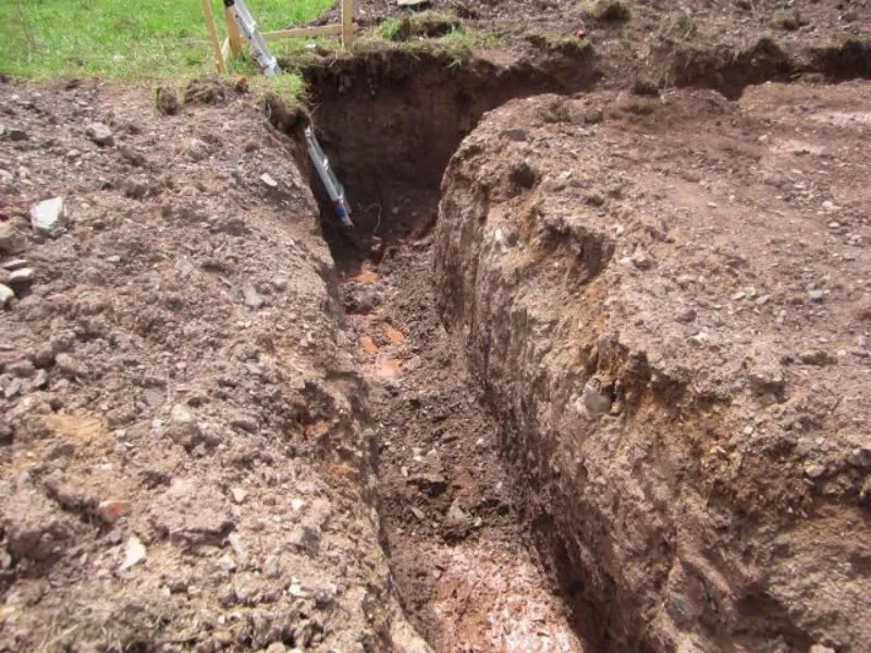

I went deep, way deep.  Oops.  My plan was actually to go a few extra inches over 48", around 54".  Some areas are 60"-66".  Again my inexperience.  It is hard to shoot the grade too when the batter board strings would be in the way.  I will have to fill it in and compact it.  On the plus side it is very easy to fill it in.  Just walk along the edges and tons of dirt just falls right in.  As you can see, I piled it along the edges.  I left the corners open with the expectation to try and shoot the concrete down them for the footing.

Geotech is way outside my calling. Basically they want you to be on undisturbed soil, signs of filling and tamping have always been grounds for "call an engineer or remove it to virgin soil". Gravel with just a little settling will be better in bearing than the soil in most places, under a footing the depth difference is not a problem. You could also pour it all and just level the top... it's a time/labor/money equation. I'm pouring 6 yards for the footing for the entry stairs tomorrow (architects  :D, but they will look cool), it got a couple of inches deep in one end but it's cheaper all things considered for me to just pour a little more.

I know I've done over 1000 residential excavations in resent years and I can tell you your not the only one that over digs their grade. I would agree with your friend and the inspector that leveling and tamping will most likely be fine.  What you should do anytime your soil is in question or even anytime period is probe it. Any reputable excavator dose and is usually the first and only thing a geotech will do if asked to check your sub grade.    Take a piece of 1/2 rod 3' or so long and weld a short piece to the top as a handle to form a tee shape.
check your grade by placing your body weight on the tee handle. The probe should not penetrate more then 1 or 2 inch's. If it penetrates lets say 6" a geotech would suggest compacting and then re-probe or take out the 6" of loose soil. Your not on bearing soil till you reach that point whether its 2" or 10'. Some soils will never pass a probe  like clean sand but thats will be obvious. I've mentioned the importance of probing your soil in other threads and I'm sure I will again. My opinion is if it doesn't pass don't build on it.

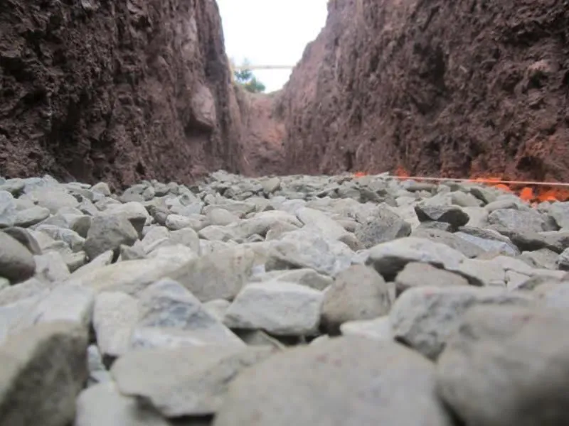

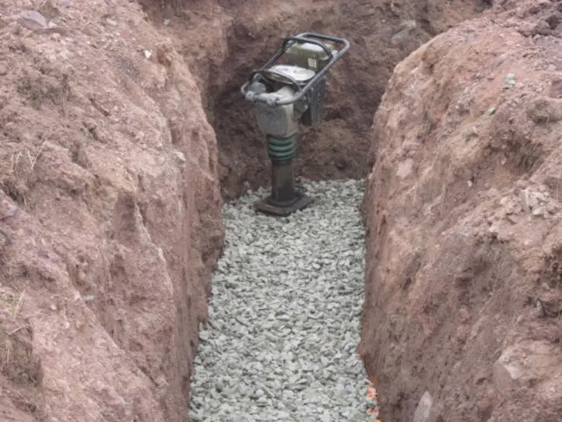

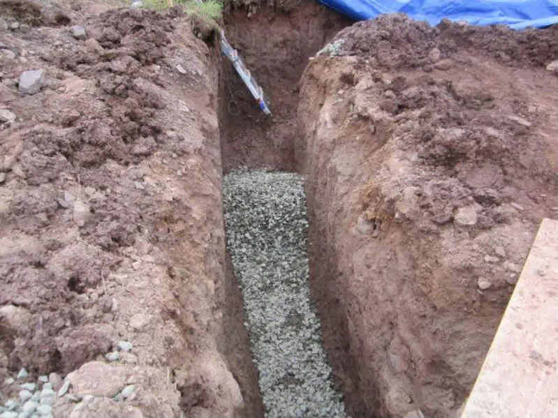

Filled with a 3-6 inch gravel base to get it level.
Tamped with a jumping jack.
It's been raining for two days while I built the forms and it is holding firm. Pictures to follow next week.  It is in Otsego county.

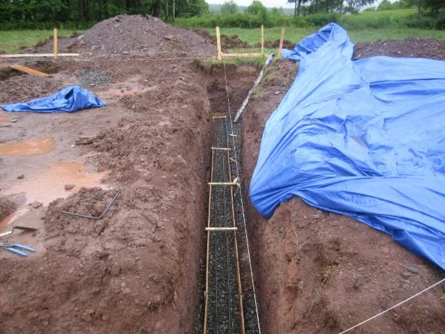

Footings are in. More pictures later.

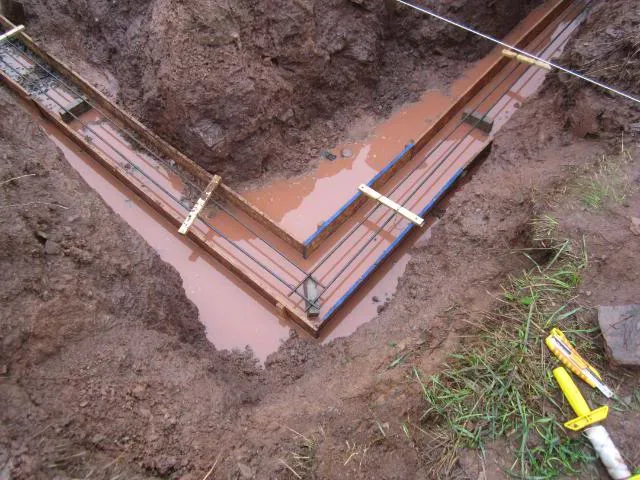

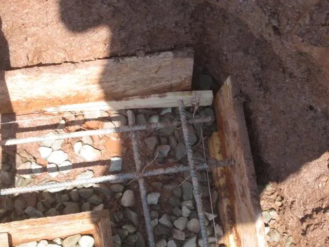

So in the rain I scrambled to cut the rebar and install the forms before the building inspector arrived.  I expected to be done by that day, but I had to spend a day shoveling out all the mud from the fill dirt I put it the hole.  I don't have many pictures because I was really scrambling.
It was good enough to pass inspection, but the inspector said, if it blows out it is my problem and that I should brace it more.

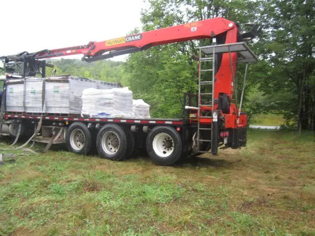

6 pallets of blocks and 65 bags of mortar showed up too.

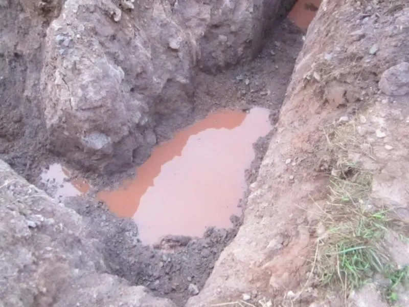

The next day I was going to level the forms and pour concrete, when I woke up to this.
It was like building sand castles in the surf.  I called and canceled the concrete.  By midday the hole was empty again with a bilge pump.  The deeper areas of rock tamped down an extra inch lower than the other side so the forms had to raised and braced.  I ordered 3 yards of concrete to make up for the low spots and spillage.

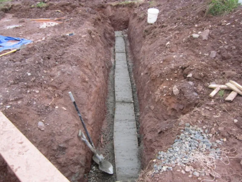

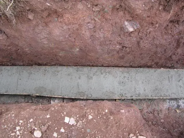

I called back and they said they probably would be able to pour the next day and it was supposed to rain the day after that.  So I asked if I could still get it that day.  They said at 2:30.  It was 12:30.  The fact that the mix was almost solid with no slump, they didn't charge me for the "empty" concrete fee and that the time was required to be 2:30 and not 3:00, I surmise it was left over concrete from another job.  Oh well it got done.  That is not an optical allusion. The forms bowed in certain areas and ended up being 16" wide in some spots.  I used almost all 3 yards according to the driver.  He was able to put the shoot in the center of each wall and reverse as he poured.  He only missed the forms a few times.  It sure tore up the site.
After spending hours setting up the batter boards AGAIN, to find the exact corners to set the blocks to stay square.  I fell off the ladder when using the plumb bob.  I landed with my spine on a large rock/clay ball that came off the side wall during the pour.  I can barely move and can't lay block the two non raining days of the week.

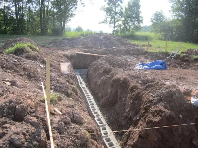

Rather than stare at a project I couldn't work on or push myself into a serious injury.  I went home. This is how I left it:
