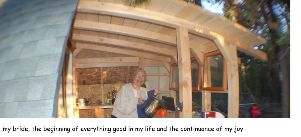

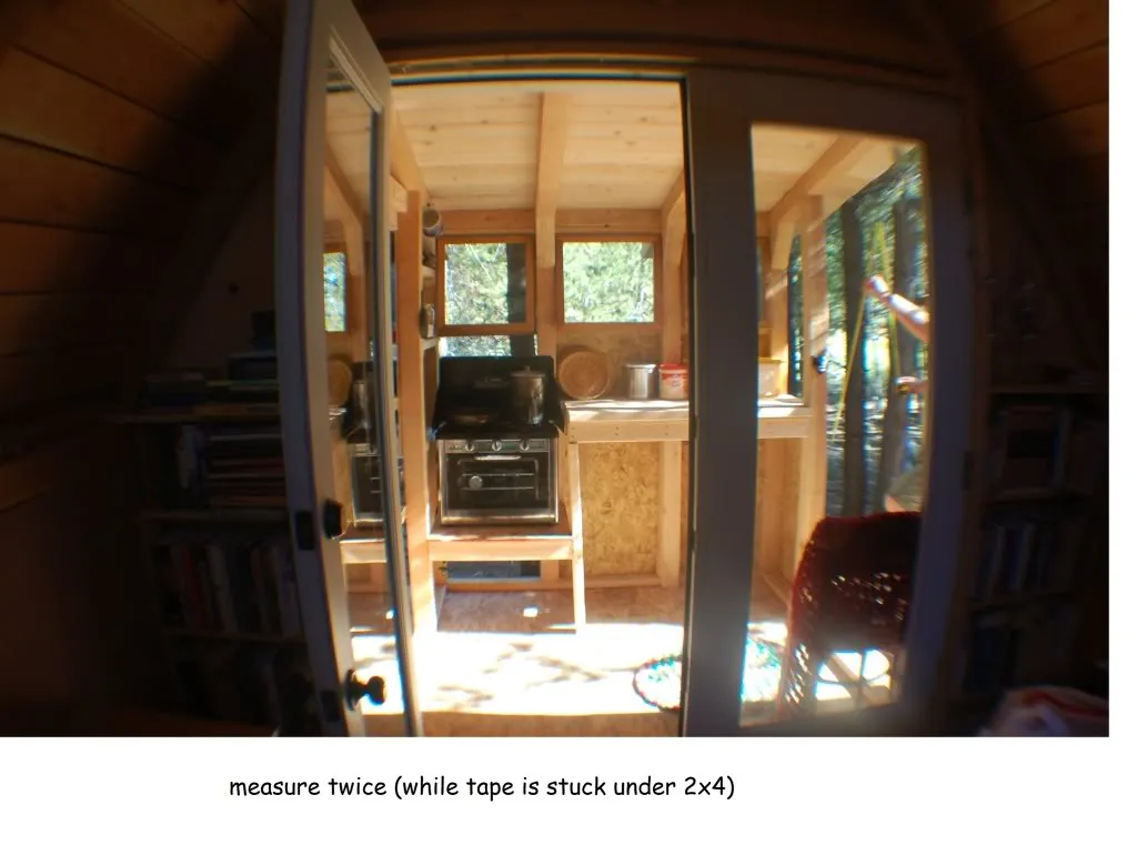

Weren't going to, but we did zip down to the cabin this fine Labor Day weekend.
My bride and I closed in the little kitchen, and installed my homemade windows.
I am now fully re-convinced that finish work is for finish carpenters....actually any carpentry is for carpenters, but it sure is excruciatingly fun for this wood butcher....and it's a cabin for cryin' out loud (of which I did a lot of...pain and suffering...)
speedfunk
Gary O
Thank you speed
Under much duress, I was able to snap a pic of my bride.
Sumpm special about warm coffee on a cool September morn', poured by your smilin' mate.
Havin' that first cup with each other is the best start of another beautiful day...can't go too wrong.

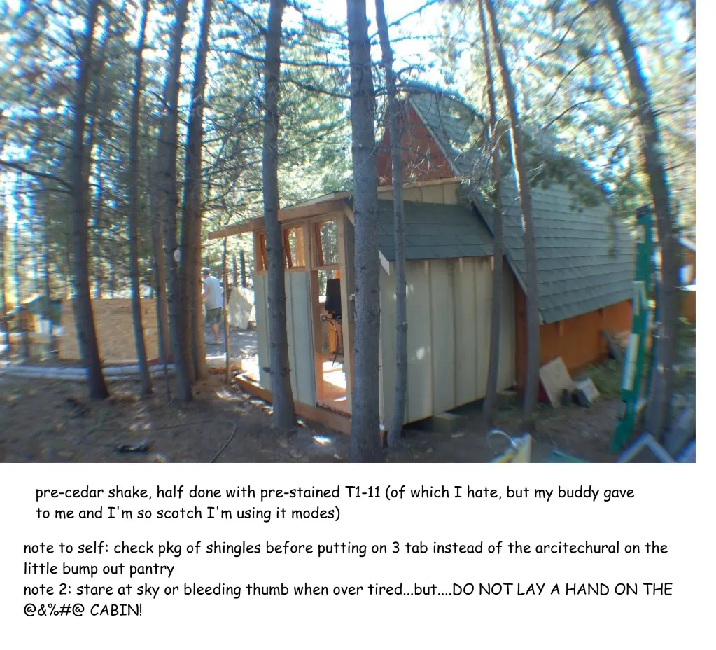

Gary O

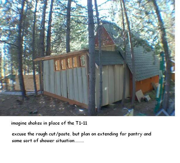

Here's where my mind is goin' at present;
Cedar Shakes will cover the sins of T1-11 and a better window situation, but my hand got tired
No dims yet, just brainurisms forming behind my eyebrows
a couple extensions with a deck in between, and it may just be livable 'til the real cabin gets built...or I take a dirt nap...whichever comes first

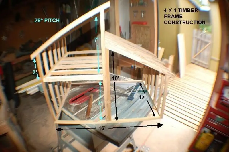

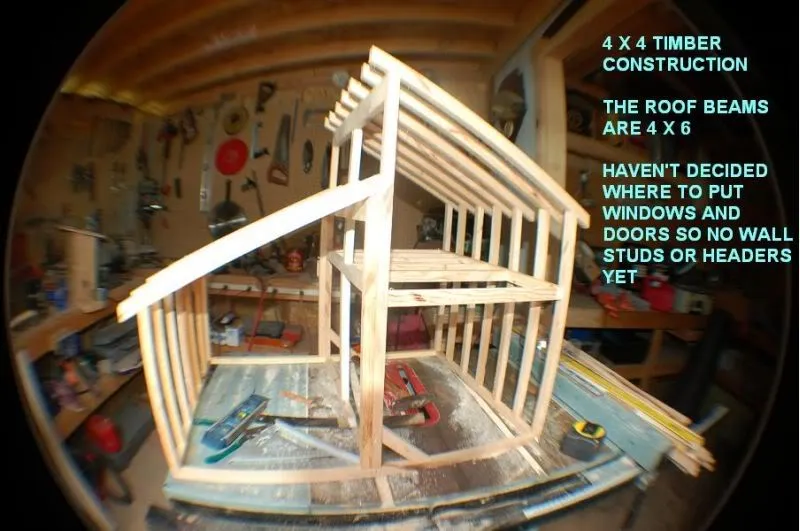

Models
OK, I seem to abhor technical jargon. Prints, drawings, specs drive me to the local watering hole, even my own sketches.
I do sketch things on quad paper, but somewhere between my frontal lobe and elbow things get a bit foggy when making connections/angles.
I've heard there are three types of learning, visual; seeing it done, written; studying technical data; and hands on; performing, doing, best in the presence of the master or instructor.
I am of the latter, without the instructor.

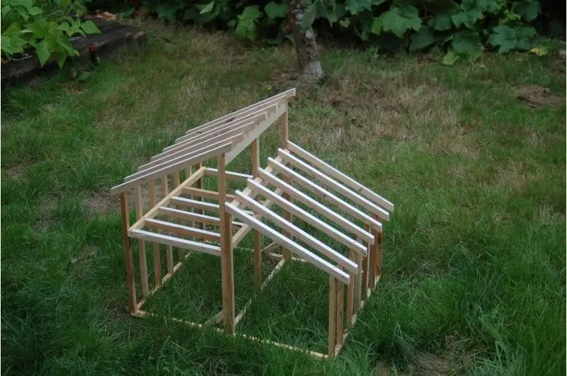

So I make scale models to prove out my thoughts, ripping pine to 2x, 4x, and 6x at 1/8 scale.
This is where a combination of laziness and ego make their manifestation.
I love to entertain the thought that I can create something in the realm of a cabin all by myself, but my patience is weak, succumbing to outright laziness enshrouded in the guise of saving time (and my back).
I have built sheds and cabins, no finish work, thank goodness, and have always ended up with something a bit less than I'd originally had in mind.
Mountain Don's little saying at the end of every post is missing one thing, my photo. Nothing's failed, and remains quite functional, but well, my creations fall a tad short of best.
Thus I over build.
I'm happy with our latest cabin, however.
Even though we'll be busy adding to it, I'm preparing for another. Still small, 200' initially, but I'm going for optimal yield of function within that footage, stove placement, loft design, and structure integrity.
I'm asking those in the know to critique, tear it apart, make subtle or pointed remarks, sparing no words.
I swear I won't get upsought. Just need some pointers to the skeletal framework.
Just no disparaging remarks like 'lay the saw down, Gary, and walk slowly away from the shop, any shop'.
Cause if I see that, one morning you'll be sitting on the back deck, and suddenly drop yer coffee mug in yer lap when seeing a herd of slugs stampeding across yer lawn.
Juust kidding...slugs don't stampede...at least that I can tell..., and they are a great excuse of mine for a poorly yielding garden.

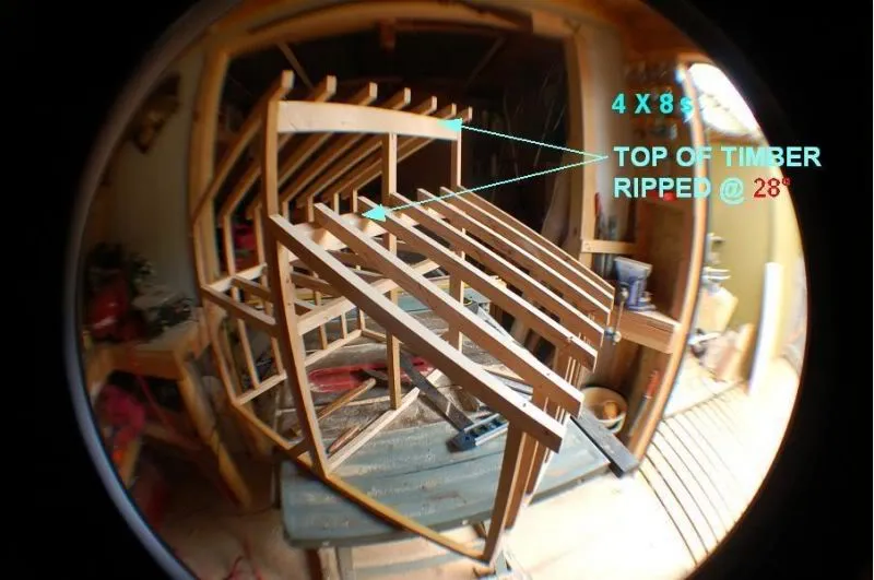

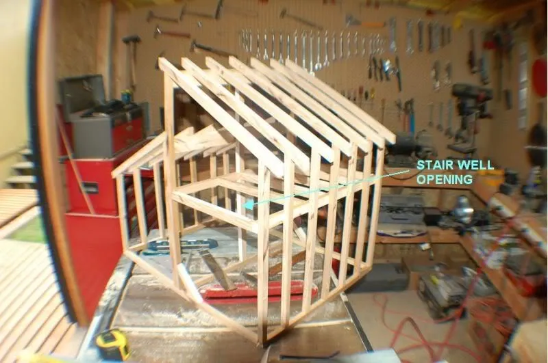

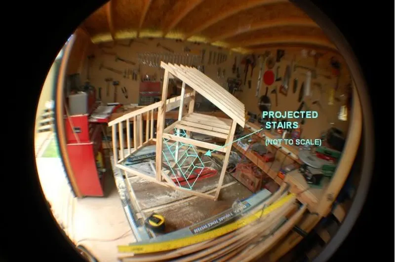

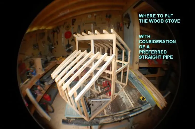

Here's the model...and yes, it's the one Rob_O so shamelessly (courageously) posted in one of his threads to depict style.
OK, don't all jump in at once.
Maybe (in my always overdone vebiage) I wasn't clear. Just askin' for a little help in structure design.
Example: 'Gary, if it was me, I'd do something other than rip 28° down those beams'....and go on to say what's best (IYO).
Or, if too many things to correct: 'Gary make another model......show us all something else with which to chuckle about, you hopeless neophite....tongue outta cheek, there will be 45° braces throughout....nothing left precarious, but may go with something wider than 24"oc
Gary O
I think you may want to forgo the 28 degree rip on the beams and use them flat so that the rafters don't want to slide off of them.  That would then require making birdsmouths in the rafters like a normal house roof uses, but that would make them stay put rather than want to slide off.
I would go up to 4x6 posts and let the ribbon in to the side of the 4x6's for the loft support, and better insulation unless you want boars showing insied and put foam on the outside of the wall for the rustic look inside..... OK ... you know me too well... likely I'd drive 60d spikes into the posts through the ribbon for support but it seems that the way I told you would be better.
PEG or Don P. are better at this stuff than me, but I thought I would just throw a troglodyte steel guys opinion in there.  [waiting]
Gary O
Hey, thanks Glenn
Yeah, bird's mouth is probably 'the way', just flirting with other ways.
And 4x6s is something to consider.
The beams will remain exposed, and initial roofing w/be 2x6 T&G or cardecking.
Not terribly concerned with insulation, but foam board is something to consider.
