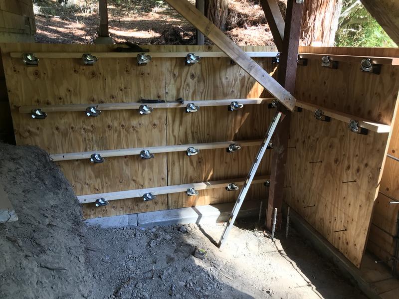

Another successful weekend working at the cabin, unfortunately I wasn't able to get away as early as I had anticipated on Friday so I didn't get up there until 9:30pm Friday night. However my dad had gone up Thursday afternoon, so he was able to get things prepped for us (stripped the forms on the footing, got batter boards in place, etc). So Saturday morning we were able to hit the ground running. The first thing we did was to move one of my temporary posts so that it was more out of the way. Then my dad started tying rebar while I built the forms.
I'm using snap ties coupled with Jahn A brackets to hold the walers, so far I'm liking this method. It makes putting a wall together go pretty quick. Especially since I had predrilled all of the holes in my plywood, so all I had to do was cut the plywood to the height I want my wall, oil, and set into place. What made it even better was that my wall is five feet on one side and three on the other. So one cut and I have to halves of the form ready to go.
I'm planning one more trip at the end of the month to dig out along the existing cabin foundation and form the final wall. Then I will pour the walls, but as I mentioned I'm hiring a pumper for that, so I'll just be running the vibrator.
Here are some pictures from the weekend...
Half of the forms in place with snap ties, and the rebar for the tall part of the wall:
My dad tying rebar on the lower sections of wall:
Starting to set the forms on the inside:
Forms for the three walls pretty much complete:
A look at the snap ties and rebar:

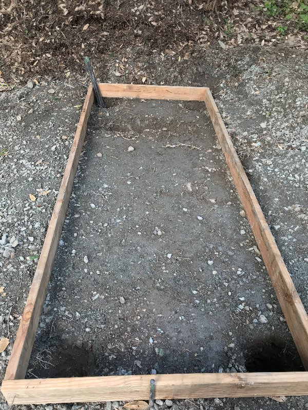

Heading up in a few weeks to get my rebar and pea gravel in place for the basement floor. While there I'll also measure for the lumber to frame up the walls and hopefully fill in my void.
pmichelsen
Did a quick weekend trip up to the cabin, I'm definitely still acclimating to working with a toddler. Our daughter is now 17 months old and I'm finally starting to realize and accept the fact that I won't get nearly as much done during our weekend trips when it's just my wife, daughter, and I.
But nonetheless I was able to go to the quarry on Friday and get a load of pea gravel and form/pour my one void. Saturday I got my floor drain roughed in, spread the pea gravel, and got my rebar dowelled and tied.
On our next trip I'll get the front wall framed so that my temporary beam/posts can come out, and dig/form my generator pad. Assuming I'm able to tackle that I'll pour the floor and generator pad the last day of our next trip. Slowly but surely.
Some pics:
Void filled in:
Gravel, floor drain, and rebar in place (final drain height will be determined after I decide how thick I'm pouring the floor):

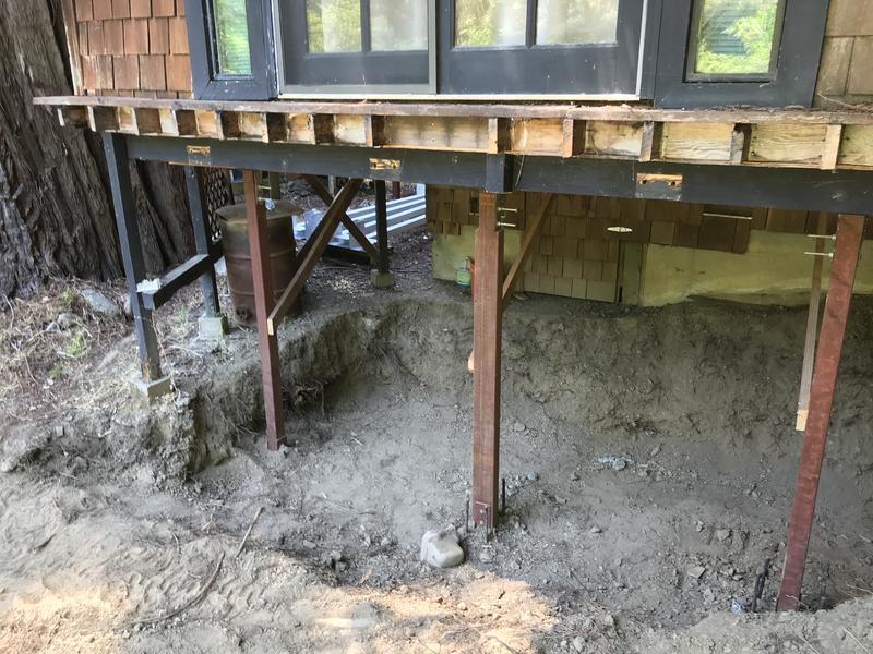

I had a productive weekend up at the cabin. Friday morning I unloaded all of my lumber, hitched up my trailer, and headed to the quarry to get some more pea gravel. Once back I jumped right into digging the trench for my conduit that will go from the generator to a back board I'll mount off to the side. After I had the conduit in I fixed my forms by adding the extra foot. With the forms fixed and conduit in I made sure my pad would have a consistent thickness using pea gravel to fill in the low spots. Then it was time for rebar, it's kind of a shame that no one will really ever know/see the time and effort one puts into make a nice grid. With that done and the weather being decent, I fired up the high brush mower and started mowing down the grounds and doing a general clean up in preparation for Memorial Day weekend.
After dinner I turned my attention to the cabin. At this time the cabin was still being supported by my temporary posts and beam. Before Monday I would need to remove the temporary stuff and actually frame my wall in so that I could pour the floor of the basement. The first step to framing the wall was to remove the blocking that was between the old deck joists to expose the cabin floor joists. By the time I had finished that it was a little after 8:30 so I called it a night.
Saturday morning the weather was still decent so I jumped right in and snapped a line so that I could cut all of the floor joists. The plan was to cut them back enough allowing me to nail a rim joist that would sit behind the sheathing. With the rim in place I attached my double top plate followed by my pressure treated sill, now I was ready to try and level her out. I used so blocking and three bottle jacks to slowly lift the cabin up off the temporary beam and as level as I could (this part is always nerve-racking for me, especially when up there all alone). Then it was just a matter of cutting studs to fill in the gap. After dinner I pulled out my temporary beam and posts, felt really good to hit that milestone. What didn't feel good was trying to maneuver the 20 foot long 4"x10" beam by myself.
Sunday the weather was pretty crummy so I spent most of the day just cleaning up. The big milestone for Sunday was my help showing up. I feel as though I can do a lot of stuff, and I'm willing to try mostly anything; however trowel finishing flat work is not something I feel comfortable doing, especially on something I have to look at for the rest of my life. So I placed an ad on Craigslist looking for a concrete finisher and I found someone, but you never know if that person is actually going to show up. So when my random helper from Craigslist pulled up in his RV I had a huge feeling of relief.
Monday morning as promised the rain came in hard and heavy, fortunately I had a canopy setup for the generator pad and the basement floor was obviously covered. Everything went off without a hitch and I had estimated my concrete so close it scared me. I'll upload some pictures tonight after my daughter goes to bed. But this last weekend was a huge milestone for me and I'm glad it's now in the past.
Oh yeah, of course the weekend couldn't go without any issues... my water heater went out on me Sunday night during my shower. I knew I was on borrowed time. So this weekend I'm bring up a new one.
