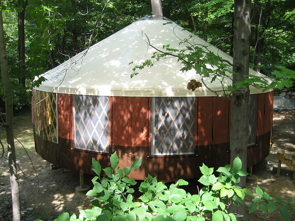

Last summer I built a yurt on our property in NW PA just a few hundred feet back from the shore of Lake Erie.  Here's a photo:

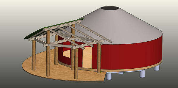

This summer, I'm going to build a porch, but one of the drawbacks of a yurt is that you can't attach anything to it.  So, I'm essentially building a pavilion very close to the yurt . . .  In any case, I plan to use ash logs that came down in a recent windfall as the posts.  They are long and straight and plenty long.  See the following drawing for details.  I didn't put any dimensions on it, but the posts form a rectangle of 12' x 16' and the rafters are 4' on center.  I plan to use 4 x 8 for the beams and 4 x 6 for the rafters.  I'll use 2" T&G for the roof sheathing.
I'd like to make the center post that supports the ridgepole be one log that goes all the way up (about 14' from the deck to the peak).  If I do that, what's the best way to join the beams to the post?  The way I've drawn it makes the most structural sense, but I don't like how the log will have to be cut.  One solution might be to bore a slot out of the log for the central beam, but I don't think I've ever seen that done.  Any suggestions about this, or suggestions in general about the porch?

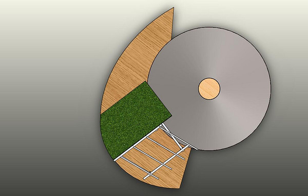

Here's a top view so you can see more details.  The deck will wrap all the way around to the other side which faces a creek, but I won't get to that this summer.  Thanks for any advice!

Are you locked on having a ridge supported by midposts? I'd be tempted to build 2 trusses on 4 posts and run purlins horizontal across them. The decking would then run up and down the roof

Glad you came out of hidding :)  Nice looking yurt...I'd love to see some interior pics if your willing to share :)
Really like your deck shape too.
Most people seem to want an overhang in the door opening of their yurts I've noticed.
very cool.
I'm starting to think that's a better idea.  What's the typical way to create a flat on the beam to fasten the decking?  Do people rip the beam and purlins, or do you rip a 2x4 to the right angle and attach the 2x4 to the top of the beam/purlin?
Thanks for all the advice so far!
Normally, rip a flat on the top surface of the log. If you don't have the means to do that you can also use a level at each end to mark a plane, chalk lines down each side and power plane or hew the flat.

Great yurt.Is it a kit or did you do all the work and sew the cover?  [cool]
What will you do about snow sliding off the roof and on to the yurt?  ???
