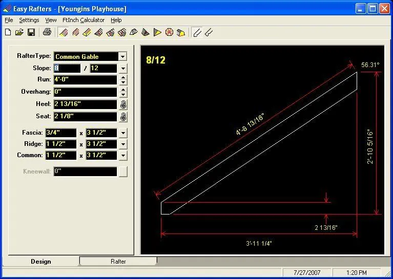

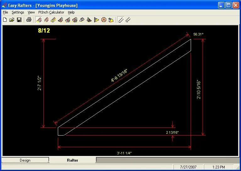

I have been playing around with EasyRafter (Free version) and have come up with the following:
I am trying to use 2x4 stock. Does the configuration above look ok for what I am doing?
"A spoonfull of sugar helps the medicine go down.."
You are using the clipped rafter detail - no eave overhang? :-?  If so it looks right - I think. :)
You have a 2x ridge board it looks like. that will give you 4' from the centerline to the outside of the rafter. Is the rafter seat what you want (3.5" assumed)?
You will block out a fascia I assume.
This is actually easier to do sometimes with a chalkline or pencil and a framing square on the deck.
I would think that at least a little overhang would be a good idea.Keep the rain from running off the roof and directly down the wall.  YMMV

I have to admit that trying to figure our the rafter is a bit intimidating.
I am just looking for a really easy gable roof solution. I figured using clipped rafters would give me less to mess up ::)

With the clipped rafters you could just gutter the front and back as in the illustration for the little house.
 Do a over hang Chris , the birds mouth cut is just a plumb cut where your seat cut is as you show it. Let the rafter tails run wide , install your rafters ,  then decide how long you want then , mark the end two rafters with a plumb cut , snap a line to connect the two marks , cut tails install facia , repete on the other side . Simple , you can do er big guy  ;)
  Lay it out on a rafter,  take a photo of each end ( the layout deteails , I'll check it out before you cut.  You'll cut one pair , check the fit on the shed , remember to reduce each side  for  1/2 the thickness of the ridge after the dry run set. Check the fit at both ends , incase your buildings not the same exact size on each end.
When you dry fit them the ridge cuts should meet all the way down the cut , the seat cut should sit flat and the plumb cut at the birds mouth should be touching either your framing (top plate ) or your wall sheathing  IF you ran it all the way to the very top of your top plate .

Your welcome , nice computer work BTW 8-)
