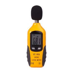

This is the sound pressure level meter I borrowed (close to it at least)
With the enclosure all opened I get 74db right next to it.  I get 60 at the house, and 30 inside at the nearest point.
With it all closed up I get 58 next to it, 40 and fluctuating at the house and 20 inside, which is about the same with the generator not running even though I can hear it.  I imagine there's a fair amount of ambient noise I tune out like my own breathing, the fridge, etc....In any event it's acceptable noise level inside and not bad outside.
