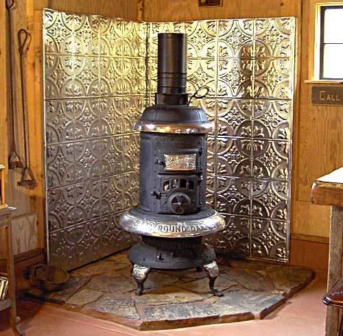

T, while browsing through the site you posted, I came across a Round Oak stove - one of the 1st airtights - looks just like the one we have except a slightly different casting on the nickle skirting & front vent - neat to see another one like ours  :) .  The tin is a great idea for wall protection - put an air space behind the tin tiles - you could  eliminate the wood framing behind the tiles & use a light metal frame + you have the reflective properties...
A few years ago we toured the Hearst Castle in San Simeon (California coast) - there were a lot of fancy ceiling tiles, including gold plated ones.

Is that what they also call a Chunk Stove? Never noticed that pic. The tin ceilings have been making their come back. I like them (nice change).
I tested the finish that these folks apply to the tin and it does appear to be pretty tough, though it can get scratched to some extent so I would probably limit its use on a wall depending...  Prior to using it myself and because these would be used as a back splash and subject to 'stuff'. I took steak sauce, lemon juice and anything else I could fine and let it sit on it over night and it didn't do a thing to it. The paint they provide is 99 % as close as you come to the original coating so wall plates and touch up is still possible.
As a non-flammable material yea it should work fine.. I would take a sample and place it near a working stove for a while to see how the color coating would hold up (but that's just me). In your pic the color is the actual tin, not sure if it was coated as are the other colors avail. To add to a frame idea you could simply stack fire brick behind the tin in iron channel of sorts or back it with a lot of perhaps fiber glass or any of the fire-proof material avail for this purpose. Maybe having the air flow behind would actually safer, better to consult those who know... In that pic, I imagine they screwed it to something... perhaps used spacers off the wall as opposed to using a liquid nails glue as I did.
