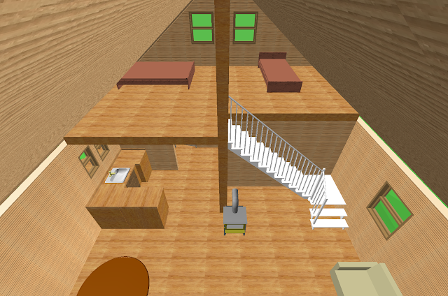

As promised, I am starting this thread to solicit comments on my plans for my cabin, which hopefully will get started in 2014.  Want to finish up the plans this year so I can get the permits.
I have details of where I am building in the thread linked above.  I am in the southern tier of upstate NY.  I started out designing the cabin layout in IMSI floorplan 3D software, but when I got to the details, I switched to TurboCAD.  I probably should have checked out sketchup as I have seen many nice renderings here using that, but too late now.
The FP3D plans aren't tied into the TurboCAD design, but here is a few FP3D renderings to get an idea what I am attempting:
FP3D is somewhat limiting - the dormer is not really what I have in mind.  But it does give a chance to "look inside" to get an idea.  Here are some renderings using a super-wide-angle view, which makes it look way bigger than it actually is:
One last screenshot from FP3D.  This shows the approximate floorplan and areas:
OK, switching to the TurboCAD renderings, here is an overall view of what I've come up with:
I'll follow up with a next post to go over some of the design decisions.

A picture is worth a 1000 words:
You can't see the loft floor in this elevation view because it is hidden behind the top plate.  I would have an intermediate "top plate" below the loft joists as well as shown.
Is this enough headroom under the loft?  I think so.  I would be using full uncut 8' studs in the front of the cabin.  That means under the loft joists (which would be open to below - no ceiling; you'd just see the bottom of the T&G boards), there would be 7'-9 1/2" head room, which should be plenty (and is well within code).
Here's a perspective view:
Note, in this view, I hadn't yet adjusted the beam in the middle of the loft, so you see it sticking out.  That gives you an idea of how much the floor was lowered.
Both these images still have the 10/12 pitch - haven't adjusted that yet until I head what people think.
Of course, with the rafters sitting on top of the floor, I don't get tie-in for spreading resistance.  But since I have a ridge beam, that isn't a problem.
Thoughts?   And speaking of Don_P - I'd love to hear any comments you might have on this or the rest of the upper framing.

Thanks guys for keeping the thread alive while I went back to the drawing board.  Took a while.
Where we left off, I was taking Don_P's advice and replacing my 3 x 9-1/4" LVLs with 2 x 11-1/4" LVLs since these also did the trick, but just were taller.  That (taller) became less of an issue when I took the advice to not notch the rafters and have them sit on the beams, but attach them to the face.  Also, I needed to go from a 10/12 to a 10.5/12 pitch in order to get enough headroom to meet code for 50% of floor space > 5' was also > 7'.  This also meant lowering the floor, forcing me to use 2x6 joints @12" oc.  So I get a stiff ridge beam but a flexy (but strong enough) loft.
And finally, the barge rafters would be supported by vertical 2x6 lookouts rather than extended top plates.  And these would just be 2x6's, not 2x12's like the real rafters.
This is what I came up with (just noticed I forgot to trim those top plate extensions - ignore those):
I also increased the slope of the porch rafters up to 4/12 and increased the size to 2x8's.  The dormer will dump onto the porch roof, which is problem discussed starting here.  So I may increase the number of rafters below the dormer from 2 to 3.  Note, the dormer spans from the ridge beam to the wall, so there is no load on the adjacent common rafters.  I haven't shown the dormer sidewall framing here.
Both the ridge beam and the rafters are 11-1/4", so there is some stickup above the beam.  I understand this is better than the other way around because the rafter is in compression rather than tension under load.  That said, it is about the same price to go to a 11-7/8" LVL or to plop a 2x4 on it's side up there.  But I will leave some space to allow the venting out the peak.
Here's the side and back view:
Since we are still working our way from the top down, here is a look at the support for the loft rafters:
Here I have the back wall turned off so you can see.  The bedroom wall has a door in the middle, with a closet on the right, and space for a pocket down on the left (slides out so I can access under the stairs as a closet).  Above this wall, I have a 6x6 that spans from the 6x6 center column holding up the middle of the ridge beam, and a 6x6 column I have embedded in the back wall to hold up the back of the ridge beam.  I don't intend for this 6x6 beam to be bearing the whole loft.  Rather I intend to have the bedroom wall under it to be a bearing wall.  Specifically, either side of the door will be built quite stout, providing support at about the 30% - 40% intervals (not counting on support above the pocket nor the closet door).  I am bringing this up now as it will come into play when I discuss the foundation.
In case you are having trouble visualizing that back view, I learned from this board about homestyler.com and ginned up a model of the first floor.  In plan view it is here:
Still working on the floor arrangement.  I mentioned I am not a fan of corner sinks but I did put my cook top there (no oven in this cabin).  But I also no I am no interior designer.  I did change the kitchen from a "U" to a "L" for more space, but overall, this needs more work.
Comments welcome as usual.

I guess my redesign of the rafters and loft passed muster, so now to continue working down.  Next layer down is the joists (and floor sheathing).  Cutting to the chase, here is the floor joist layout:
If you recall, the dimensions are roughly 22' x 28'.  So in the front I have close to 14' span, and in the back close to 11' span connecting to a girder.  The 14' span in front required me to go to 2 x 10's @ 16" oc.
In the back, the span tables say I can go to 24" oc, but decided with a couple of exceptions to be conservative and go 19.2" oc.
Exception #1: I left a full 24" spacing just past the midline of the cabin.  I did this because throughout this design, I am designing not just to be functional and hopefully not too ugly (I guess I failed on that with the dormer, though) but also to minimize waste.  So I wanted to minimize wasted floor sheathing, so I came up with this arrangement which uses 96% of the advantec flooring I would need to buy:
Those first cross-wise joists are 16' from the front of the cabin, hence the ~24" spacing after the front 14' section.  Now on the right hand side, that's where my stairs will be so not much need for extra support there anyway (just lightweight storage under the stairs, and the stairs supported by their perimeter), but I may throw another joist in the left since that will be in the kitchen.
Exception #2: The back 12' aren't an even multiple of 19.2" so I needed to place two joists closer together somewhere.  I decided to align them under where walls (non load bearing) were going:
So that's the thinking.
Let me know what y'all think, and if it looks OK, then we will move on down to the foundation.  As you can suspect, I will be supporting that midline through the cabin by having a full (walkout or semi-walkout) basement in the front, and a crawl space in the back (sloping lot).  And the girder in the back, if you recall, is below load-bearing wall holding up the loft joists, so I didn't even bother sizing it as a clear span - it will require intermediate supports.  But that is all for the next post.

On the ugly, well I'm still smarting on that front this morning, I believe the term I heard yesterday over the phone regarding something I had drawn was "that looks like some butt ugly adirondack trail shelter" ;D. So... to be pc, the aesthetic of the dormer does not speak to me. Gable dormer? The hallway on the main floor is wasted space in a small house. Try to get rid of hallways whenever possible.
To the floor, the sheet layout and orientation doesn't work. The long axis of the floor sheathing needs to be perpendicular to the joists. Joints need to be offset between rows. remember you're not just covering joists, you're weaving together a strong diaphragm. The waste floor sheathing is my stair subtreads and landing.
Offline SouthernTier
  • Senior Member
  • Posts: 236
Re: Soliciting comments on cabin design
« Reply #24 on: February 27, 2013, 07:14:54 PM »
More good advice, as usual.
This arrangement uses the same number of 4x8 sheets (20 of them) and I think it meets the overlap criterion best I could considering my joists switch direction halfway through:
To make this work, though, I had to go to a straight 19.2" joist spacing all the way through the back half, which should not be a problem.  Still have a joist under my stairway wall, and only the short, non-bearing hallway wall lies between joists.
Note, I was wondering why nobody brought up the hallway before, for the reasons you mention.  The reason for that hallway is two-fold.
First, it is to provide a wall against to put the fridge and kitchen counters/upper cabinets.  Second, it is to provide a small mud room space upon entering.  A place with hooks to hang up jackets, and not have blasts of cold air go into the main areas.  Also, for the corner unit of the kitchen corner, I plan on installing under-counter access (shelves) from the *hall* side to store wet boots, hats/gloves, etc.  makes good use of under counter space that is usually not well used, at least I think so.  I suppose I could do all that without a wall, although there would still be the kitchen counter there, since I switched from a U-kitchen to an L-kitchen.  I suppose I could move the fridge to the other end of the counter.  I'll give that a try in homestyler.com and see what it looks like.
The dormer is ugly simply to make it easier to build.  The purpose there is to provide a little more headroom for an upstairs bed.  Also more building material conservation.  I plan on a metal roof, which comes in 3-ft wide sections.  The dormer starts 3 feet from the back gable, and is 6 feet wide on top (not going to have much overhang on the side eaves).  So not much metal cutting nor waste.  But the consensus is that it is ugly so I will think about it some more.
