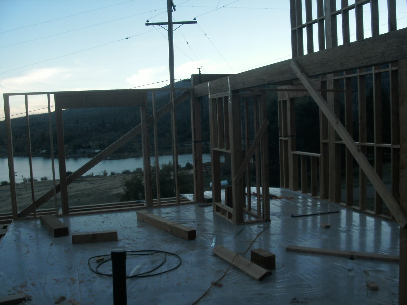

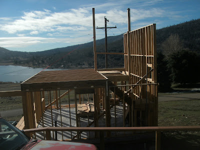

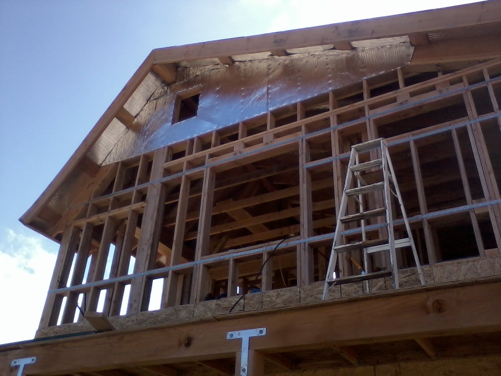

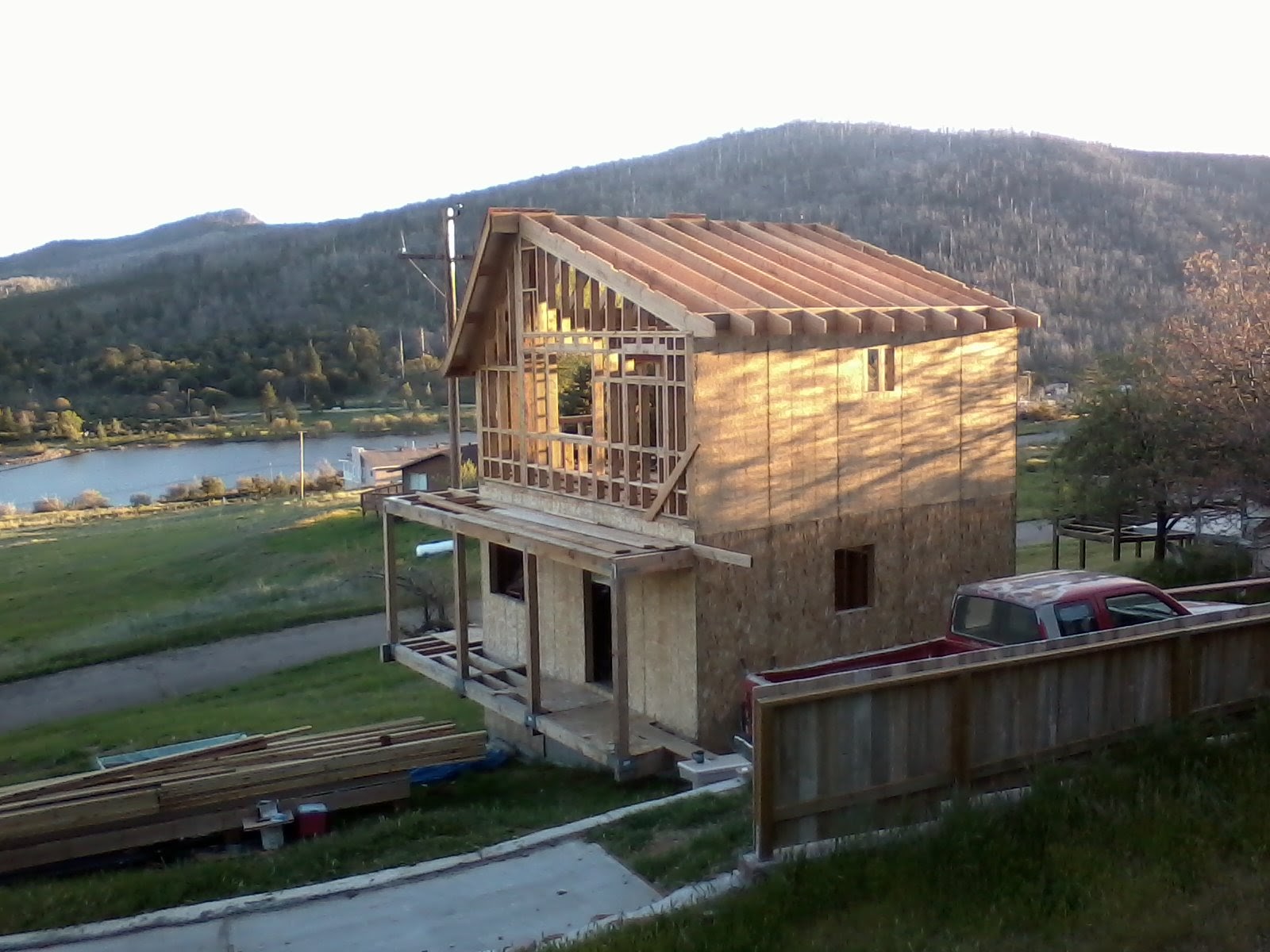

Well, you still have the same lateral hinge point, at the bottom plate---(X a lot with the leverage) but there's plenty of support from all around.  I'm attaching pics from my last build where I did just what we're talking about.  There are three columns supporting the ridge pole--one is a continuous 6x6, 23' long, framed into the balloon framed wall (I still filled in the top with gable frames) The middle one rests on the huge beam running across the livingroom, the load being transferred to two 6x6's that straddle the fireplace.  The third column simply rests on the plate (beefed up framing below) with those HDU's holding it.
  (you can see how the beam is well supported either side of the fireplace)
   Something that's pretty interesting is how much structures can wiggle and move around at the framing stage.  Once you put the roof decking on though, everything really stiffens up.  I don't think that hinge point you're talking about can move at all once you get some decking tacked down.  Prior to that I wouldn't lean a ladder against it though
