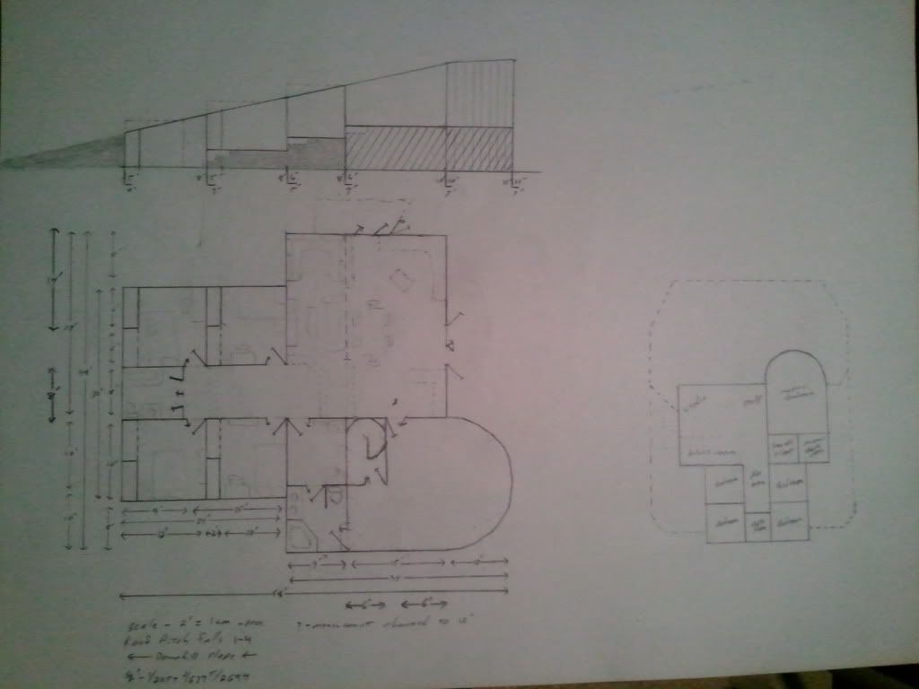

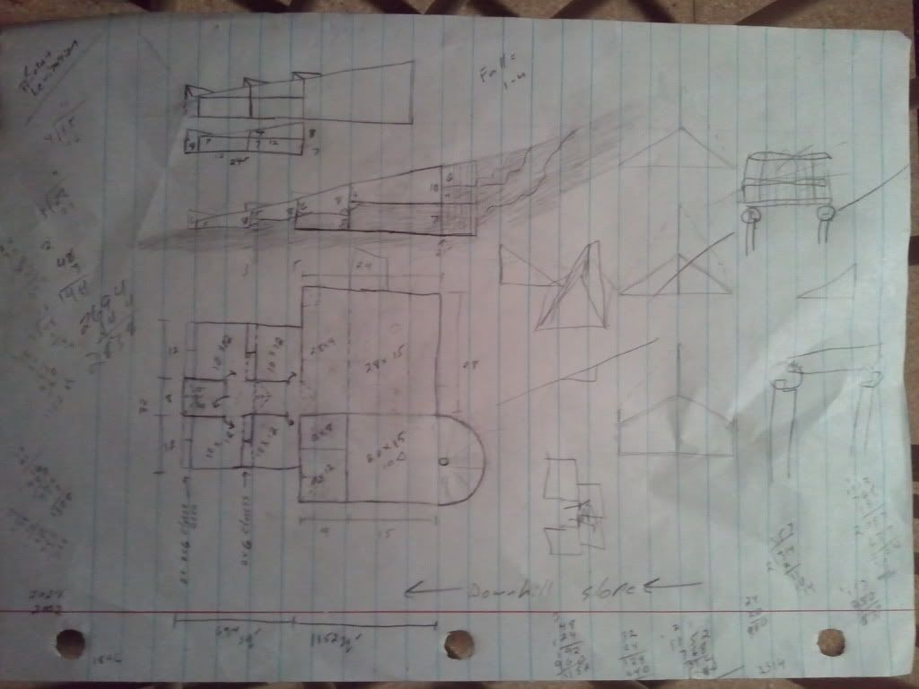

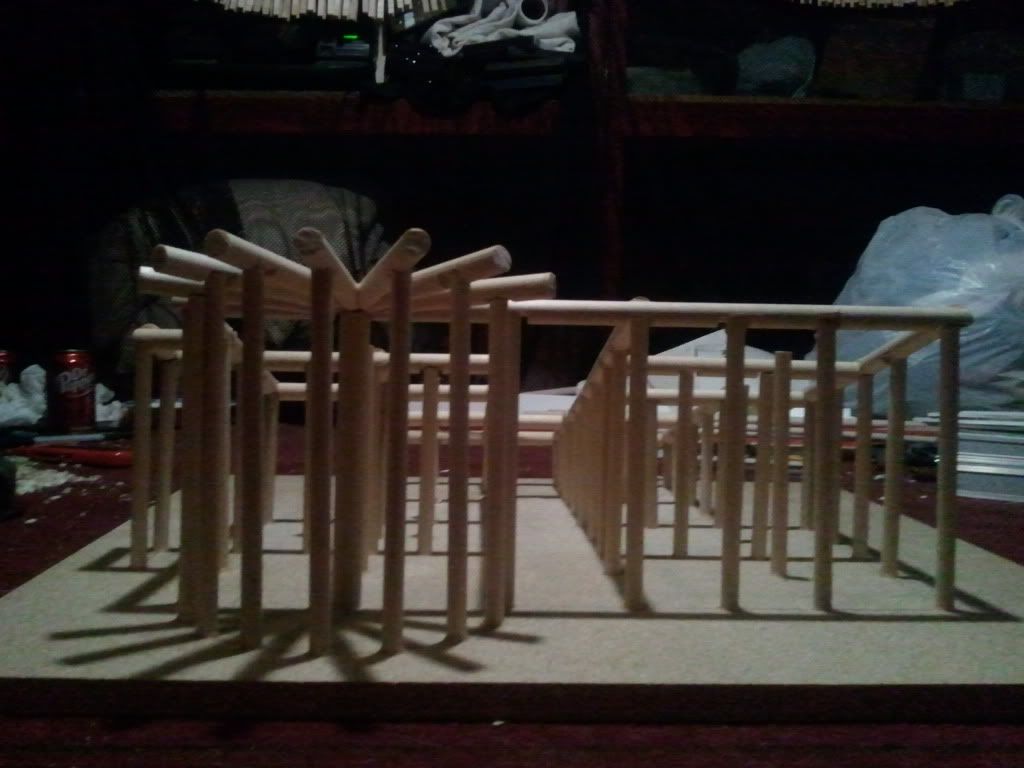

Next step... (in my mind) .... a floor plan.... after lots of discussion, and sketching and talking and sketching, we settled on an idea I thought was a little big and she thought was a little small, so that would make it perfect... LOL
And then some re-working and drawing to scale....

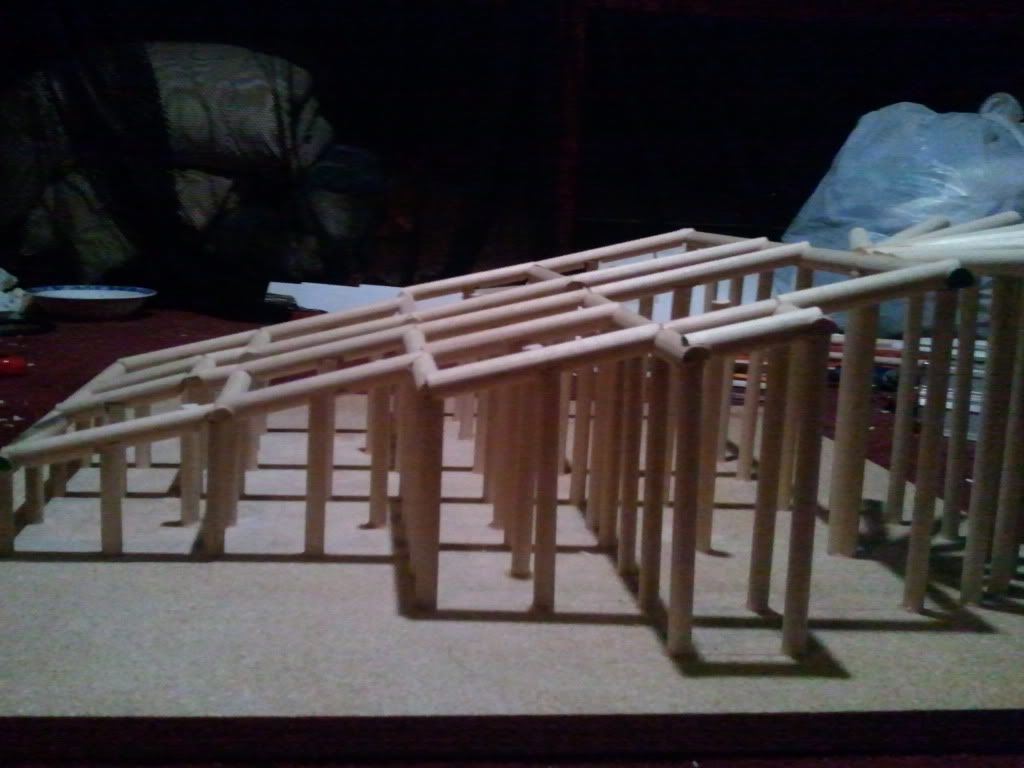

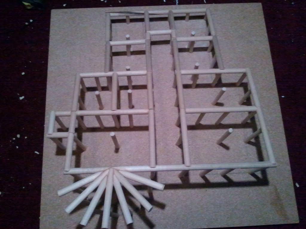

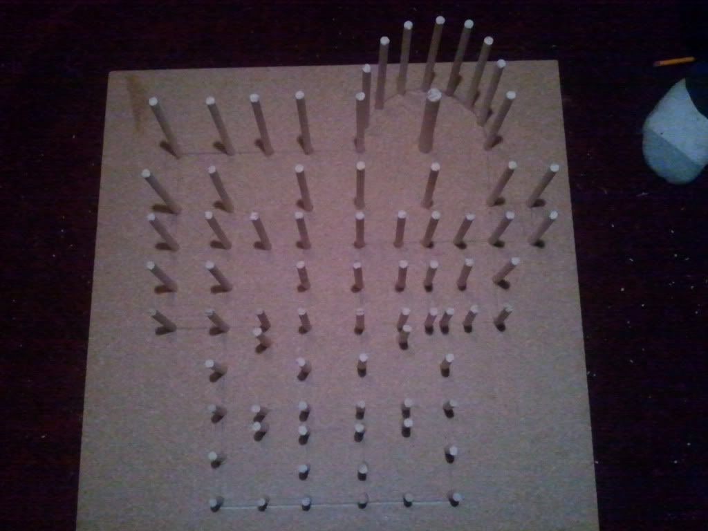

And then came the idea of building a scale model...

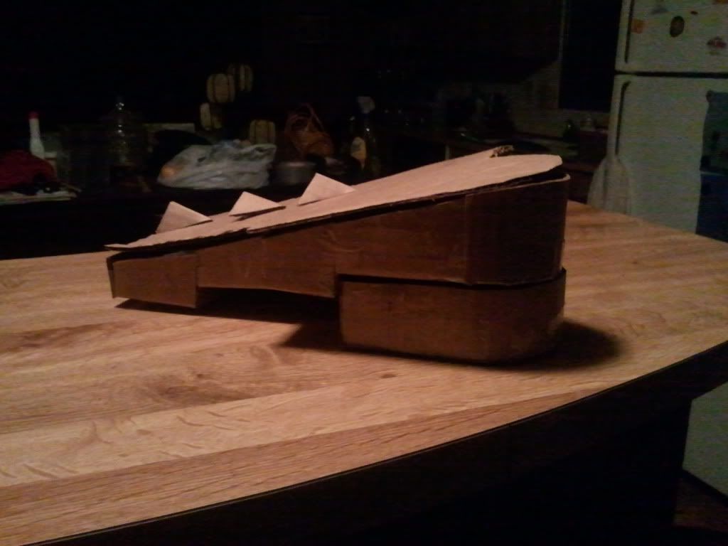

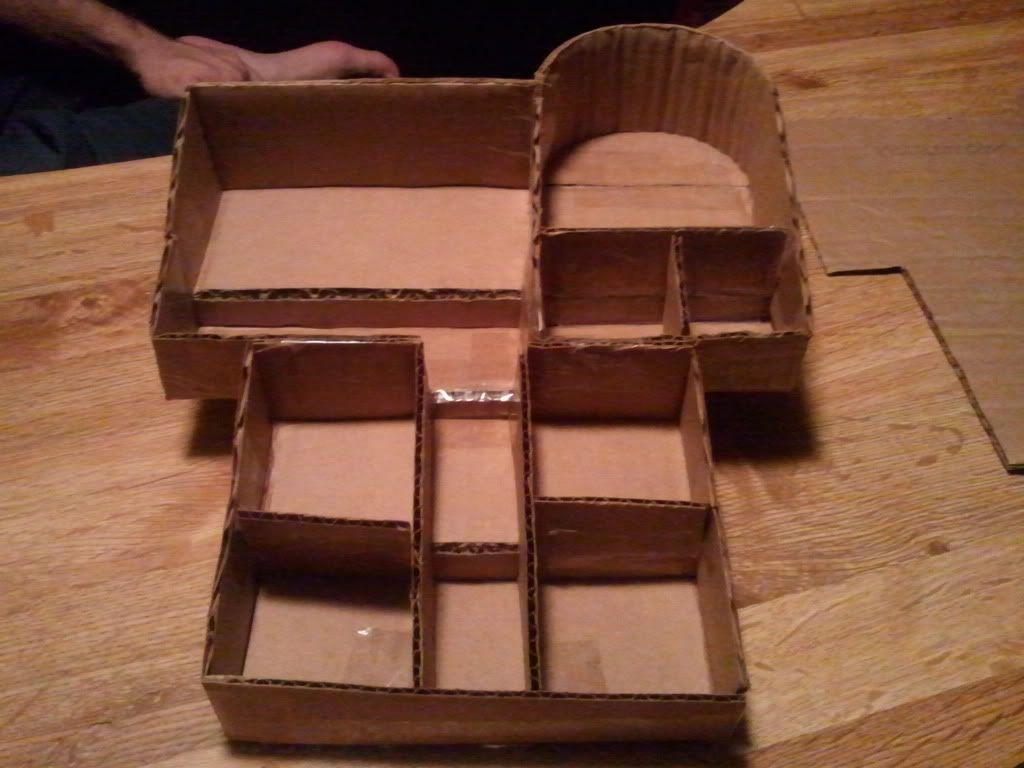

Cardboard was the first effort, just to get an idea of how it would "look"
And we agreed that we liked it... but some things needed to change, so we re-thought and re-worked a bit... and liked where we were headed.... so it was time to sit back and scale up the model a bit using wood dowels and such...

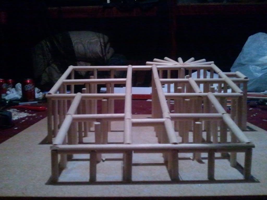

We have since added walls and windows and floors to the model using PVC board and some Plexiglas, mocked up a roof using fiberboard... could post some pics of that if anyone is interested....
But it led us to figure out some re-working of the general idea, like moving the 3 gable windows from the center hallway to 4 gable windows above each lower bedroom allowing light in and a second egress from each room... (just in case....) Moving the closet area of the lower 4 bedrooms to the 'upper' end of the rooms, also moving the stairwell to the "basement" under the circular master bedroom to the side wall to provide for a false wall in that area and hence, a "semi-secret" entrance to an underground room in an underground house... also, off the opposite wall, on the other side of the kitchen area, an off-shoot dug in pantry/root cellar.....
Which led to other ideas, see, she has 4 children, (the reason we needed the 4 lower bedrooms....) and I wasn't sure if the 1 bath at the end of the hall would accommodate 2 boys and 2 girls entering teen years for morning rituals.... so we are currently considering placing a bathroom in between each room on each side of the lower hallway allowing for a girls "powder room" and a boys "john"... and the end of the hall could be transferred to the heating room.... I... um/we... LOL like it to be in the mid 70's, and it would seem that all underground ideas report that the temp remains the average lower temp of the area.... fine, but if the area average is in the 50's... we definitely need more heat than A/C... and since the house is sloped on different levels, placing the heating unit... i.e. (wood stove) at the lowest point seems to make sense....
And with a firm idea in mind and something we could "see" in front of us... it was on to looking for a place to build....

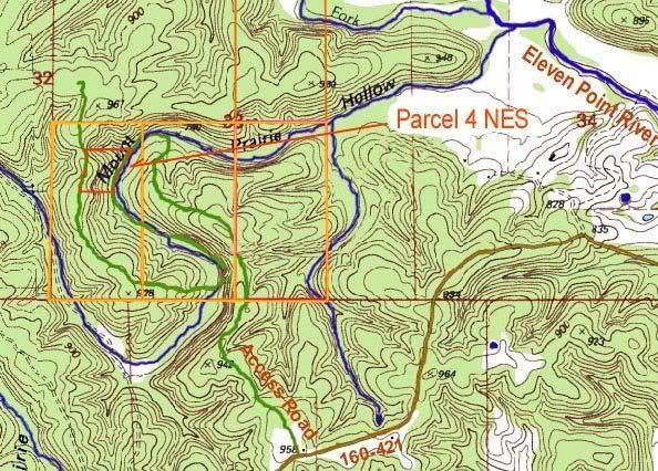

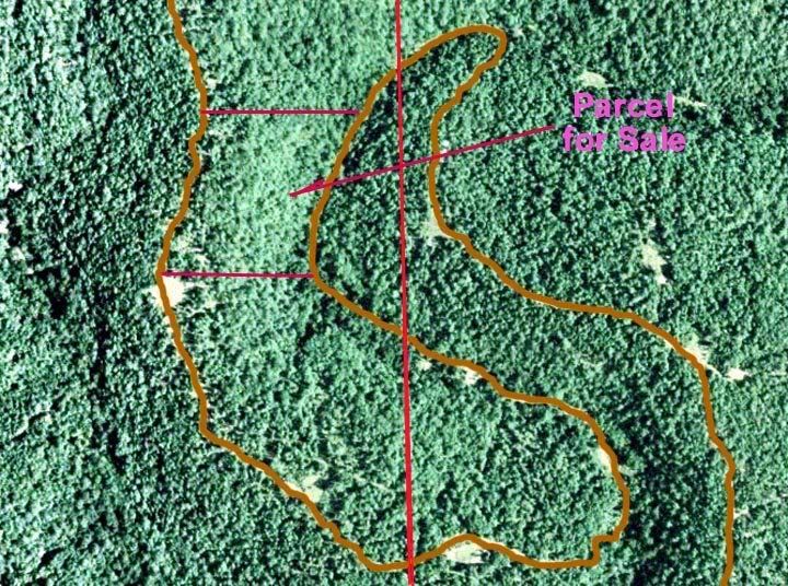

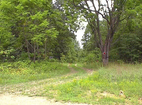

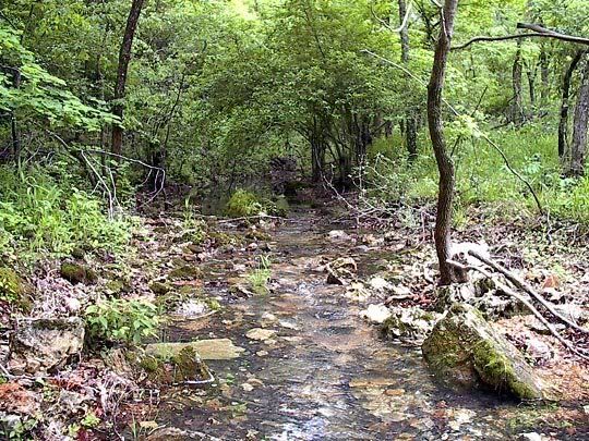

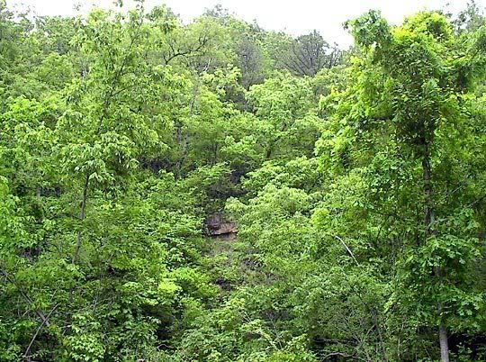

We were lucky and got a great deal on e-bay and bought a nice 14+/- acres in southern Missouri... (Her mother lives in SW MO. go figure!!!!)
The land was bought sight unseen, but with these pics... (and lots of research of the area and google earth... LOL)

From some real shady math and rough calculations I figure the land has a rise of 1-5 at the south and 1-6 at the top, and the house was planned with a rise of 1-4... so that's a small issue.... (though the seller has another 20 acres just south but not bordering with a good rise of 1-4 (by my S#$%@y math mind you...) but on an exact opposite ridge face... meaning....
at present, morning light would enter the gables for the lower bedrooms, and afternoon-evening light would enter the kitchen/master bedroom wall of windows and uphill patio... (but not later evening due to the ridge to the west....) the other piece of land lays the exact opposite.... hmmm... to buy as a back up or not to buy... that is the question.....
(or to buy secretly and build a "MANCAVE RETREAT"..... LOL J/K)
The BIG issue.... I hear that that area of the Ozarks is mostly Clay and Bedrock... not the best digging at all...

Nice to see the models. Makes it a lot easier for others and yourself to visualize what is going on. :)
That's pretty cool how you made the scale models! w* If you build underground you'll be able to benefit from lots that we've learned to do & not to do - Glenn doesn't play w/models - he just plays w/the real thing so sometimes it's trial & error d* :)
Post all the pics you want - we like em!
Thanks Glenn and Sassy!!!
I will say that I definitely think the models helped a lot not only for others to visualize our idea, but for ourselves in planning to see the slight but major flaws, or rather, the NEEDED "re-evaluations of the idea" Things seem to look good 2D on paper, then when it's 3D and in your face there can be a lot of: "um, well, hmmm, if only that was there, this would actually fit better over here, and.... "
it's currently a bit of work that keep evolving, but I hope to see it to fruition one day.....

Jeramie, I'm sure others didn't want to bring this up but... cardboard will not work for your walls underground. ???
Quote from: Weasel on January 30, 2011, 02:58:16 PM
What's with that waxed cardboard from the produce boxes? That might hold up better.
Darn it! and here I thought I was really onto a new technique, eco-friendly, recyclable, inexpensive...
Back to the drawing board I guess!!! LOL
There are a lot of above ground cardboard shelters in Fresno..... a growing trend with the burst housing bubble... the waxed ones would be considered a luxury. [waiting]

A plan related question for the masses:
(please excuse the rough plan drawings using MSPaint)
ok, reconsidering the lower end of the house, the area planned for the 4 'children's bedrooms' and the second bathroom currently looks like this:
However, after some thought, perhaps another bathroom might be necessary for the 4 children...
preliminary thoughts are to place one on each side of the hallway...
the 'first thought' process says to place the bathrooms in between the bedrooms to provide 'equal access' and turn the end of the hallway into a location for a devoted water heater and a wood stove for house heating...
but no other real benefit that I currently see...
on further thought, locating the bathrooms at the lower end of the house might place them closer to the 'considered' spot of the septic system below the house...
(and allow for easier modification of the model.... he he he)
or, placing them further 'uphill' might 'sound insulate' the bedrooms from the living room and laundry room areas and drive morning traffic towards the main part of the house... and allow a larger 'room' area at the end of the hallway, perhaps an area for a grey-water storage tank etc....
but then there is the idea of placing them in tandem on one side of the hall, allowing for another room to be added on the other side, or making the hallway branch like an upside down 'T' and placing them off the sides or with another room at the end of the hallway.... or more...
(It's probably late enough for me to be 'over-thinking' this really!!!!)
But I was wondering what other opinions might be.... if any...
personally I hate hallways, waste of space, the cabin I am renting right now has one, for no structural or design reason what so ever, that wastes about 40 square feet of a 600 square foot cottage, you have to pay to construct them, then it is additional volume you must heat cool and light.

The land looks pretty awesome ...nice creek..very cool.
Land is so important. Keep you design fluid b/c a well done house will work with the landscape. Its impossible to fit a house without knowing what the land is about. Some book I've read have said to just "sit" at the land ...taking it in..this way you can make educated design that works with it rather then trying to fit the predetermined house into something that wont work.

Paint is a great tool for roughing out drawings.
I also am not a fan of hallways and prefer to arrange rooms - offset rooms from a main room etc to eliminate hallways.
We have 3 wood stoves so we can heat areas as we choose.
As Jeff mentioned - seeing the land and fitting the house to it helps. I find that wider is sometimes easier than long down hill due to elevation drops and keeping sufficient drainage. My lowest pitch is about 2 1/2:12

anti corridor here too !
Note I only have 1 child that lives with me............so I'm no expert
but would kids not prefer a large kids clubhouse area, and just have small bed "caves' to sleep in

I have always been Pro-Hallway... (and yet always lived above ground as well.... LOL)
I feel hallways provide for a defining environment charge to areas... i.e. once you enter the hallway it should be a quieter area, because it states "bedrooms are present"... and I find that guests are less likely to wander down hallways then peer into areas offset of common areas... To me, hallways seem to provide defining areas for different 'energy' levels, and (although I may be a bit strict...) rule defining limits as well... i.e. "when you get up, teeth and hair should be brushed by the time you reach the end of the hallway, after 9pm all lights out past the hallway," stuff like that... LOL
living in a 2 story at the moment... and I find people seem to feel free to wander the ground floor during get togethers, but people rarely brave going upstairs, and telling the kids that in the mornings, they should have 1, 2, and 3 done before they come down stairs seems to work well enough...
Another concept that made me strongly consider hallways is that plumbing, electric, etc... could be routed along the hallway.... the idea being that it's easier to repair, replace, add something down a hallway then to have to work in a bedroom space for a while...

Some general pics of the place:
And the stream:
A rock formation we have began calling "The Grotto":
And a ledge nearby that I shall someday use to preach to my gathered masses: ;D (kidding of course!!! ;) )

Pic of your property #8 would lead me to believe you have a natural spring there....
When advertised they stated that the land had a year round creek and several natural springs... I was hoping to do a real search for said springs but the leaf pack was just to intense for the time we had... the rock outcroppings like in #6 and #7 were dripping like sieves, but as I had mentioned, there was wet weather the day before....
Locating the springs would be #1 before thinking where to build...
My thought as well!!!
We plan to do a more intensive search/perusal of the land in June when we relocate near the property and have more time and hopefully better weather on our side!!!
This was our first view of the land, and more of a 'feel it out', 'see what we got ourselves into', kinda trip... LOL
