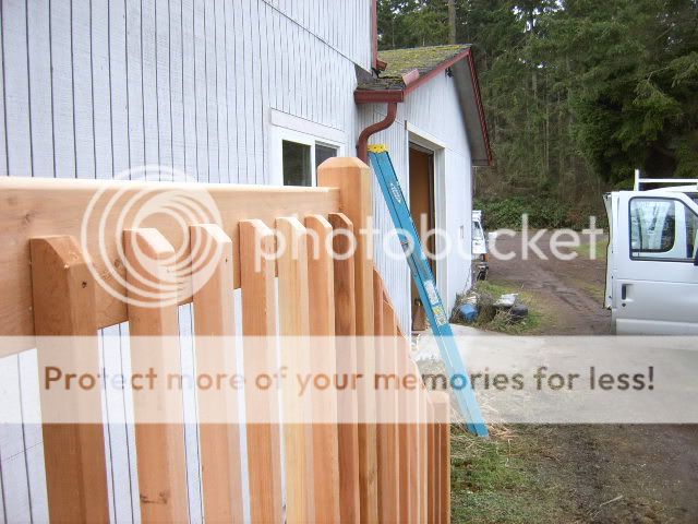

 Here another idea for a deck guard rail .    This a slightly sloped deck that is a roof and a deck .  No stair system is used here.  And you'll see some details that I try to hold to for ease of const./ crew familiarity / constinstancy.
 Notice we try to do our bolts and screw placement in a pattern , consistant nature , I also like to put the Vertical grain side of the post and ballisters out to the public and the mixed grain side towards each other.  Some times what your not seeing is the" calm " of a project , how it flows so to say.  This might be sort of a masters class , but you all can be "Masters" once you know the details of it  :)

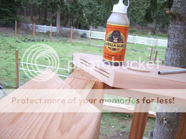

 Here's a few more details / how to's / ideas .  Most;y same old stuff , just a few different ways around it .
 Newel posts at the bottom of stairs can be floppy / loose , the rebar pin driven into the landing and a lag bolt , or two if theres room can stiffen that up ,
 Drill a hole up into the post bottom , then use a block to drive the post down onto the rebar, I bored the hole up into the post then cut off a 1/4"  section and used that cut off to align the hole for the rebar , so it was a template of sorts .
 Hand railing is set at 35 1/2" plumb up from the nose of the treads , guard rail is set at , no less than 36" at it's lowest point . Also note that the railing is a "gripable " railing , no greater than 1 1/2" in cross section , wide / flat 2 bys do not make a good railing  ::)
I use thru bolts with nuts and washers where I can , makes adjustments easier , and 1/2 " lag screws where there is more meat / dbl . joists for the lag to grab .
 This deck had 2 x6 joist so I let the post extend below a bit the corner posts are fun the dap out / recess in as the cuts do not run thru so a bit so hand chisel work is required , or maybe a router and a jig , I did these by hand as there where only a couple of three to do.

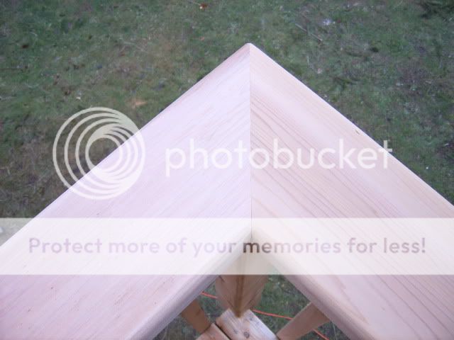

Another thing I'll point out is the way I attach the guard rail cap , from underneath.
The 2x2's balasters / pickets are nailed to a flat 1x2 first, then a 1x3 is nailed on the INSIDE >:( , and  a 1x2 is nailed on the OUTSIDE >:( , as you can see this DIDN"T >:( happen as I DREW IT UP  >:(, on paper and explained the WHY we're doing it this way  >:(, but that being that, really it doesn't bother me , MUCH any more .
As you can see this section is not straight , the guard rail is so as we attached the two componets the section was pulled straight , and screwed to the rail.
 The point is no fasteners are exposed on top , so we assemble it all sand it with 100 grit with the random orbit sander , run the router around it the detail sand for effect.

I just want to mention two things that really grabbed my attention on PEG's handrails; 1 - no fasteners showing in the rails/guards and 2 - the biscuit joined corners.
