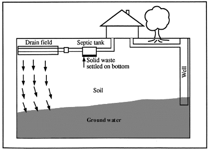

In a modern septic system the outflow of the tank is distributed equally over a large drain field where it percolates down into the soil where additional microbes working in the top few feet of the soil purify it further. This process is the same one that happens on the rest of your land where rainwater, rotten leaves, dead animals and their droppings are all composted and the water flowing through this process is recycled down over the years to rejoin the water table where well water is supplied.
As such it is a closed loop system (not unlike the “still suits” of the science fiction story “Dune”) where you are ultimately drinking your own urine. And we’ve been doing it all our lives.
A cross section drawing of a house and the land under it. Waste runs from the house to a septic tank, marked with a note that solid waste settles on the bottom, and on from there to a drain field on the left. Rows of arrows show liquid percolating down through the soil into a grey band of ground water that runs under the whole site. On the right a well shaft reaches down into that same ground water.
Septic overview with groundwater loop
