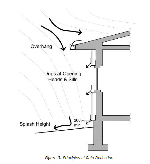

The first line of defense is rather obvious - stop the water that falls or splashes against it.
Cross section drawing through a wall, from the footing up to the roof eave, with a window in the wall. Curved arrows show wind driven rain pushed against the wall and thrown clear by the roof overhang, by drips at the heads and sills of the openings, and above a splash height off the sloped ground, where a dimension is marked 200 min. Captioned Figure 3: Principles of Rain Deflection.

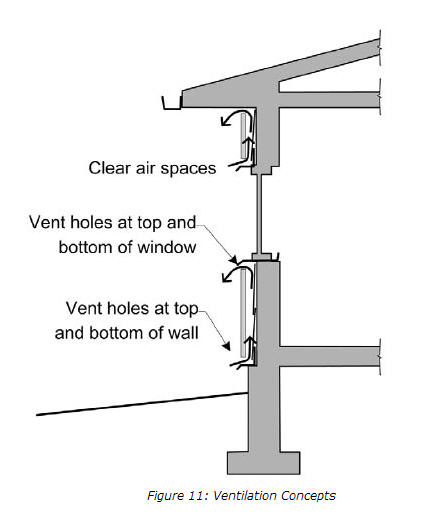

The same wall in cross section again, this time showing air movement. Labels read clear air spaces at the eave and behind the siding, vent holes at top and bottom of window, and vent holes at top and bottom of wall, with arrows running up the gap behind the siding. Captioned Figure 11: Ventilation Concepts.
This drawing demonstrates the concept of a vented rain screen behind the siding that allow moisture to escape and dry the siding from the back.
