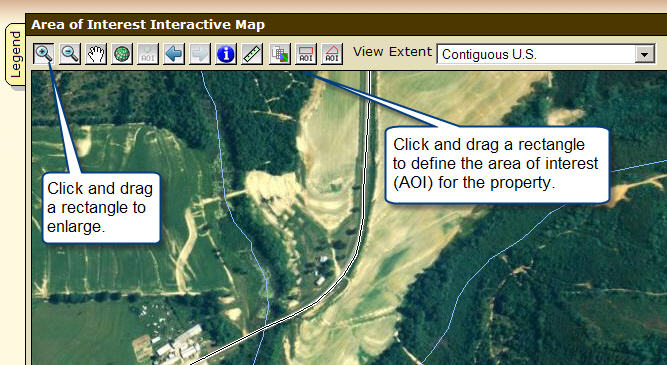

First, use Quick Navigation (left hand panel) to locate your land by address or by browsing via city & state. Then use the +magnifier to draw and enlarge areas as you drill down. The hand icon will help uncover sections outside the window.
Once you are over the land you want to explore use the AOI icon (red rectangle on the map toolbar) to draw a rectangle over the target area. It should then turn into a hatched area. Now, click the "Soil Map" tab on the upper part of the window.

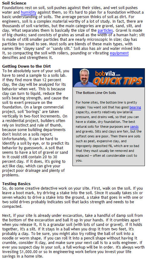

The article below is from Bob Vila's website where he does a good job of explaining the importance of soil properties for the owner-builder and property buyer.
Bob Vila article on soils

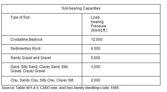

So, what can this soil information tell use about what type and size of foundation to build?
Soil Bearing Chart from CABO
Here is a useful chart of soil bearing ratings for different types of soils. Short of doing expensive engineering studies you will have to make an educated guess as how much weight your soil can bear. The soil types from the USDA database can be compared to this chart for an approximate capacity for your soil, and from that, your footing design. When in doubt use a lower bearing capacity and build larger footings. This will spread out the weight of your structure over a larger more supportive area.
Let's do an example problem. A standard footing under a pier in a foundation plan might call out a 16" diameter by 8" deep footing. That footing covers an area of 1.4 sf (1.7 sf if a 16" square footing). If you use the standard 2000 psf soil bearing that most building departments assume you can carry 2800 to 3400 pounds on the pier above it. If, on the other hand, you have "Gravelly sand" at footing depth you might easily be able to support 5000 psf on such soil. That would let me safely double the weight that pier could support with the same size footing.
