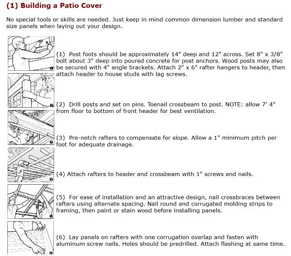

Six numbered steps for building a patio cover, each with a small drawing: setting the posts on anchors in concrete, pinning the posts and toenailing the crossbeam to them, pre-notching the rafters for the slope, attaching the rafters to the header and the crossbeam, nailing crossbraces and molding strips between the rafters, then laying the corrugated panels across them and fastening through predrilled holes.
Building a patio cover, drawn step by step in the Natural Handyman article linked below.
