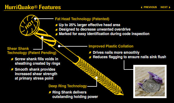

Labelled drawing of the nail on a black background. Fat Head Technology, patented: up to 25% larger effective head area, designed to decrease unwanted overdrive, marked for easy identification during code inspection. Shear Shank Technology, patent pending: screw shank fills voids in sheathing created by rings, smooth shank provides increased shear strength at primary stress point. Improved Plastic Collation: drives nails more smoothly, reduces flagging to ensure nails sink flush. Deep Ring Technology: ring shank delivers outstanding holding power.
Features of the super nail.

The downside is that they are designed for power nailers and they are no fun to pull out. :o - So, you better have that window in the right place. :D
