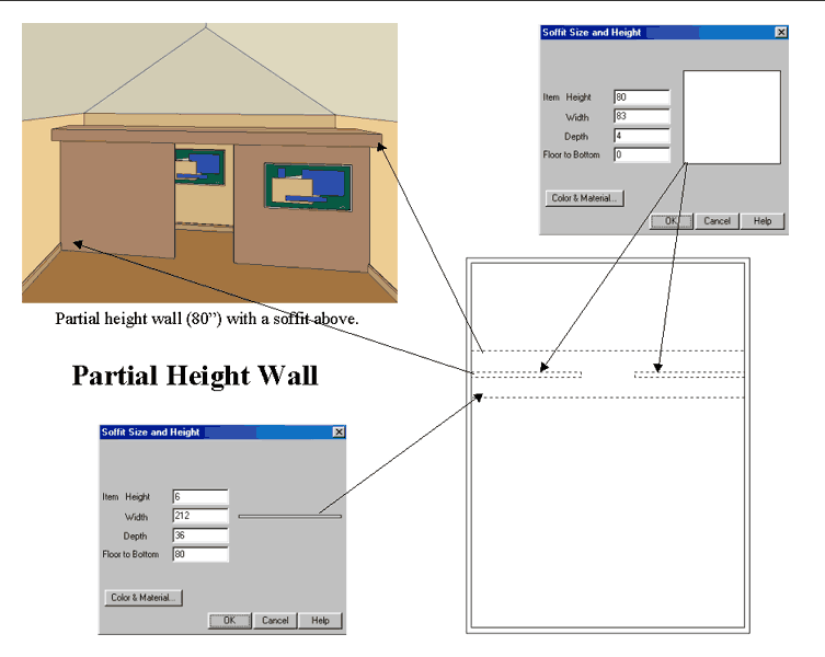

Partial Height Wall
How to create a wall that is free standing and a different height than the rest of a room. This example also includes a soffit to top the wall for a better finished look.

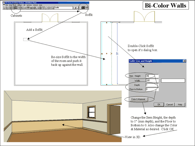

Multi-Colored Walls
Shows how you can apply multiple colors to a wall. This is done in rectangular areas. Mainly used to create a different wall color/texture above and below a chair rail. But don't let that limit you!

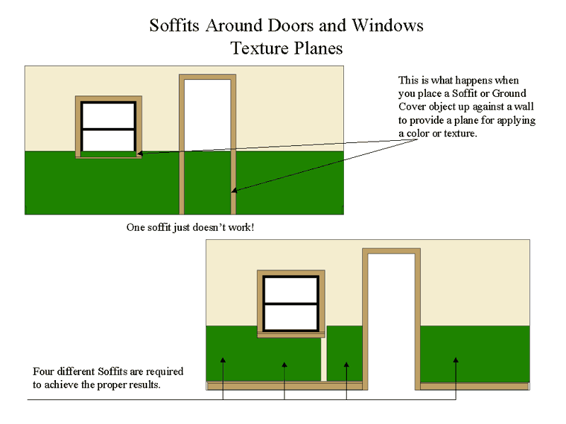

Wall Coverings
Using the Ground Cover Tool or the Soffit Tool to cover a wall with a different color/texture. This will explain why you need to build multiple Soffit type objects to cover some of your walls.

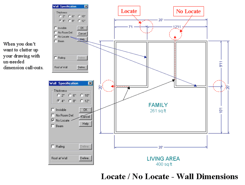

No Locate Wall Property
Just a visual explanation of what will result by using or not using the No Locate property for a wall.
