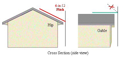

What is Slope / Pitch The slope of a roof refers to the angle the roof line runs compared to the horizon. In 3DHA the default slope (or Pitch) is 6-in-12. This value can be changed to fractions such as 4-1/2 in 12 or 5-1/4 in 12. The numbers refer to the distance the roof will RISE compared to the distance that it RUNs along the horizon. So for a 6 in 12 roof, that would mean the roof Rises 6 inches for every 12 inches you move along the horizon. (in cross section) |
Various Pitches Some very common pitches would be 3-in-12, 6-in-12 (shown above), and 12-in-12. The drawing to the right shows the general difference from one pitch to another. |

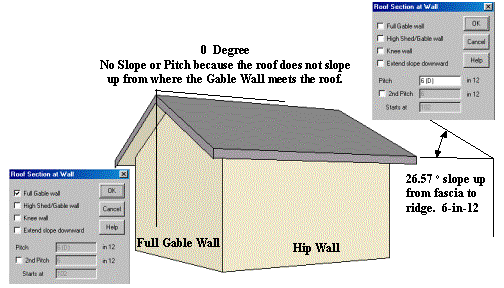

Hip vs. Gable Roof Section When viewed in a cross section, a Hip roof has a slope running from the top plate of the wall UP towards the ridge of the roof. A Gable wall runs past the top plate, all the way to the roof, turning 90 degrees when it meets the roof. In the drawing to the right you are looking at the Gabled End of the house on the left, but seeing the angle of the Hip roof on the right side. The drawing on the right has you looking at the house from a side that has a Hip roof, but illustrating the Gabled end and how it is at a 90 degree angle to the wall. (No Slope) |
more on....Hip vs. Gable Notice that the Pitch text box is disabled (grayed-out) when the Roof style is changed to Full Gable Wall. (lower left) That is because a Gable end wall has no Pitch or slope running up from the top plate to the ridge. The distinction between a Hip wall and a Gabled wall is very important if you plan to make 3DHA produce the roof you expect. 3DHA will create a single roof style if you select that roof style in the Make Roof dialog box, but 3DHA will change the roof style of individual walls if you override them in the Roof at Wall dialog box of different walls. |
