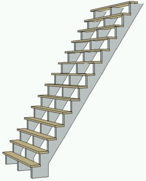

| Stairs and How they Work | I have included a refresher picture in case you are new to or are a little rusty with stair terminology. This lesson was not meant to show you how to create stairs in 3DHA, but rather to get a better understanding how different values in the Stair dialog box effect other values. Before reading this lesson you should have read the 3DHA manual in order to learn how to create stairs. |
Treads are the planks that you step on as you walk up or down the stairs. The Riser is the vertical wall between each tread. The Riser Height is the distance between two successive treads. Sections are groups of Treads and Risers, separated by Landings. Landings are areas larger than the treads that separate different Sections. They are used whenever the stairway changes direction, but can be used even if the stairway continues in the same direction. The Rise Angle is the angle the Stair Section rises in relation to horizontal. Best Tread is the Best Tread width, in relation to the Riser Height, for climbing. |

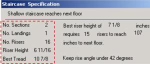

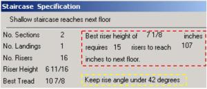

The very first thing you see at the top of the informative sections is whether or not the staircase reaches the next floor. Also, it tells you whether the staircase is Shallow, Normal, or Steep. If you have more Risers than required to reach the next floor, then the staircase is Shallow, as shown in the picture by the No. Risers being 16 and the requires __ risers being 15. The right number of risers make the staircase Normal, and too few risers make the staircase Steep. |
The section inside the dotted red box shows you the current settings of your entire staircase (all sections and landings). |
The next picture has two dotted line boxes. The red box is the section where 3DHA shows you the best settings to build a stairway that is comfortable for humans to use. The yellow box never changes as this is the maximum angle that is comfortable for humans (and generally legal under code). But you can go beyond what is recommended if you need to fit your stairway into a tight spot (in 3DHA). Just understand that your friends, relatives, and local building code representatives may not be happy with the stairs you build. |

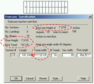

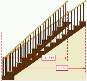

Standard Staircase The dialog box to the left shows the values for a standard staircase. This is evident by the verbiage at the top that does not include Shallow or Steep. (NOTE: the following examples show 108 inches to the next floor. Normally it would be 107. (96 + 11) This is because these stairs were built without a building.) The best riser height is derived by: Inches to Next Floor divided by the No. Risers or (108 / 15). The Tread width comes from: Length divided by the # Treads or (141-3/4 / 14). |

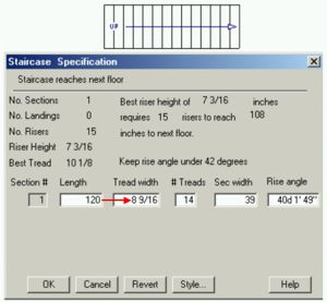

What happens when you change the value found in the Length text box? The Tread Width will change. If you make the staircase longer or shorter, the distance must be made up by changing the width of each tread. In this case we change the length from 141-3/4 inches to 120 inches. (141-3/4 - 120 = 21-3/4) This caused the Tread Width to go from 10-1/8 inches to 8-9/16 inches. The difference in each tread width comes from the difference in length divided by the # treads or (21-3/4 / 14) or 1-9/16. (10-1/8 - 8-9/16 = 1-9/16) The # Treads stays the same when you change the length, but the Rise Angle changes due to the shorter stairs. |

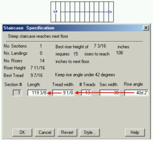

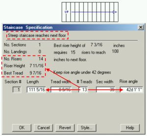

Steep Staircase When you change the value for the Number of Treads, many values change. In this case we changed this value from 14 to 13, creating a Steep Staircase. The picture to the left shows the other values that change to match. The length changes because there is one fewer tread to make up the stair section. One fewer Tread means one fewer risers, changing the No. Risers and causing Riser Height to change in order to reach the next floor. When the Riser Height changes the Best Tread value changes to show the best Tread Width for the Riser Height. But the actual Tread Width does NOT change automatically. When the Length changes but the distance to next floor does not, then the Rise Angle will change. |

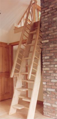

Alternative Stairways When it comes to custom Stairways, 3DHA is rather limited. The Alternating Tread staircase (also called the Jefferson stair as it was invented by Thomas Jefferson) is shown here. It is an example of one that 3DHA will not produce. However, this type of stairway can be used as an alternative to a ladder or very steep stair. Building codes generally restrict the use of steep stairs to lofts and upper floor areas under 200 sf in size. Areas under this size limit can have any type of stair. (Check with your local codes for more information.) Another alternative stair is the spiral stair. For code level access to an upper floor, spirals are usually required to be 5' or more in diameter. You can find this stair under "Fixture Library, Utility, Circular Stairs". There are 48" and 54" diameter stairs shown which could be used for lofts. Resized to 60" diameter your code may allow this as a primary stair. The stair at the left was found at: http://www.akastairs.com/ALTERNATING_TREAD.HTML |
