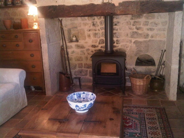

With respect to the fireplace you indicated you are planning on a propane furnace, why not consider a propane fueled fireplace?  I know EPA approved wood burning fireplace inserts get pretty expensive.  Since you already have the framing you could install a direct vent unit in one day...

Dan, we'll be doing a gas fireplace in the downstairs large room, but upstairswill be a wood burner
I own 10 acres of aspens on the same mountain- only no road access ! ATV only for now- the GC is going to look into the legalities for me this winter as a home project, he has some experience with solving these problems on the front range in CO, so hopefully we may have a logging house build in a few years !

Originally we were looking at an Inset, but minds change and we want to fit a stove, sort of like this
But being as thats in the UK its all brick ! and not 2x's
So I need to research how to turn my inset framing  into an inglenook and make it suitable heat proof !
anyone have a vermont castings defiant ?
