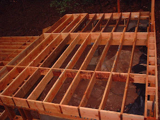

You can see how the joists just clear the top of the boulders underneath

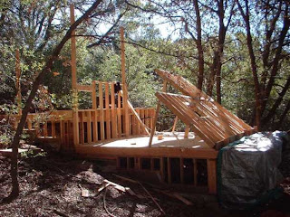

Tipping up the big wall----I used a come-along and a tree to keep it from falling
The curved rafters....They allowed the clearance for the upstairs window, and kept the place from looking like a pre-fab

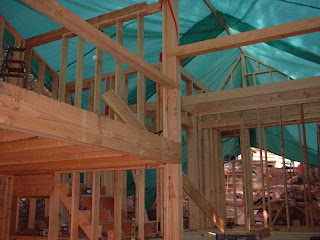

Some of the interior framing.  There's lots of heavy timber

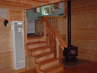

All done interior...I didn't want a post to the floor for the kitchen counter.  The rail down to the livingroom extends up and supports the counter instead.  The loft is above half the livingrooom

How did you do the curved rafters?

  Well, first I got the four different points in place---the ridge, wall, beam, and edge beam of the porch.  Then I cut three 2x14's on the bottoms where they met their resting points (the ridge, wall, etc) and figured out the splices at the two points they joined, and rested them in place.  So you have to imagine the three top edges were still straight at this point...Then, I attached a string to the very top, and draped it over the very bottom.  Then I 'sagged' the string until it was the curve I needed, clearing the 2-0x2-0 window (There's a name for this sort of curve REAL architects have told me but I don't remember it) I spray painted over the string and it left a very clear mark where to cut.  Took the three boards down, and used each as a template to replicate 7 times.  (If you're cutting curves, set your skilsaw blade to just the depth of the material.   DO use a circular saw as you'll get a much better cut than with anything else)  The roof sheathing was t&g so it would follow the curve well, and looks really cool from underneath
   I can scan pictures of the process if you need
