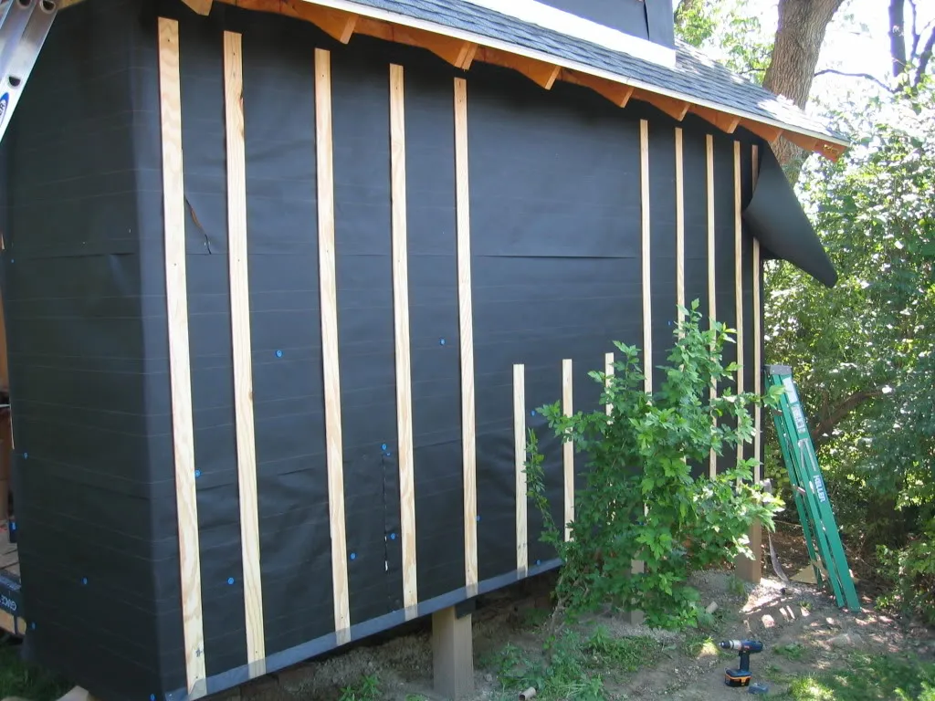

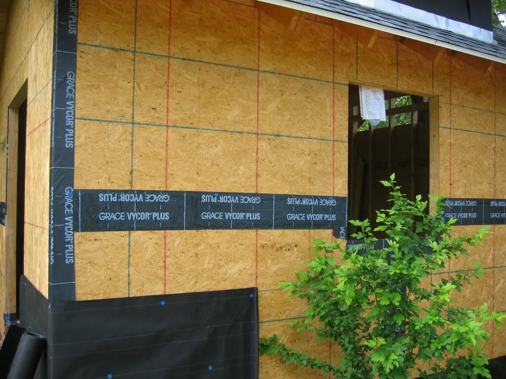

I've been sealing seams, flashing window & door penetrations, putting up felt and building a rain screen.  The felt is tough to put up well by yourslef.  I'm going to have to do it in smaller sections from here on out.
In the proccess of sealing seams.
Siding and trim ready to be stained.
Site built rain screen.  Will have to fix that felt I ripped.

if its not too late i would run 2x4's on end verticly on top of the pine sheathing 4' apart. lay 3" foam between them. that. leaves a 1/2" air gap for venting.
CjAl
oops, nevermind
i didnt notice there was a second page
Mike 870
It's not too late, and in fact, that's part of the plan.  I've got about a 3/4 inch gap on top of my blocking in between my rafters.  I still have to put up insect screen, and then I will add some shimming so that a piece of trim will cover the screen, the blocking and the top of the bevel siding, and still allow room for the ventalation gap.  I will post pictures of the proccess.
Also the strapping will continue up higher, it just happens that I made them by ripping 8 ft sheets down and that is as far as the length takes 1 piece.

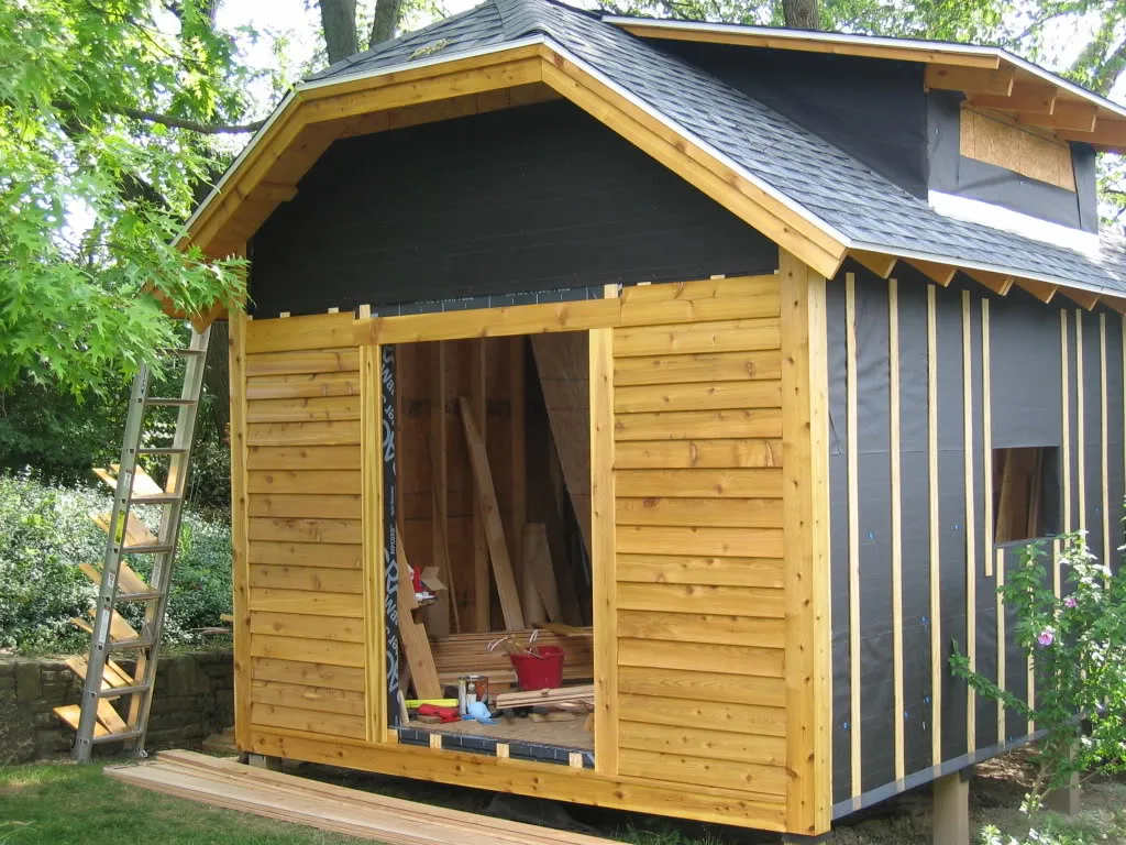

Anyone have any suggestions for how to trim between my rafter overhangs?   The design aspect that I am struggling with is that on the gable end, the bottom section will be bevel siding, then a trim board, then shingles.  Wondering how I make that trim board looks like it flows from the gable end around the corner and to the front side.  Obviously I have to lign it up, but is it ok for the trim on the rafer side to be larger than the gable side?

Started on siding and trim.  I've also been staining a couple shakes here and there so I don't have to do them all at once.

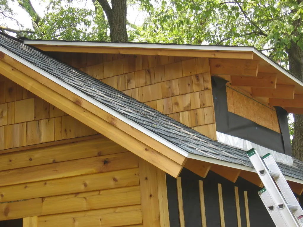

Finished the shingles on this side. Really wish I had done one less course of clapboard so the shingles started lower.  Either that or skip the trim board because you really can't visually differentiate it from the clapboards unless it is a different color.  3 years from now when it is time to re stain, I may paint the trim white or some other color.  I also have 7 inches of exposure on the shingles, but I think less would look better.  Maybe 5 or 6 inches instead.  It is amazing the amount of waste when you are shingleing that small an area.  Glad I bought the cheapo undercourse shingles.

Another thing I think looks good that I should have done is have the trim boards on the corners be visually thinner than the exposure of the clap boards.  If you look that is what a lot of builders do and it looks nice.  It's less expensive too. Also would have had the bottm trim boards along the base connect to each other and start the corner trim boards above them.

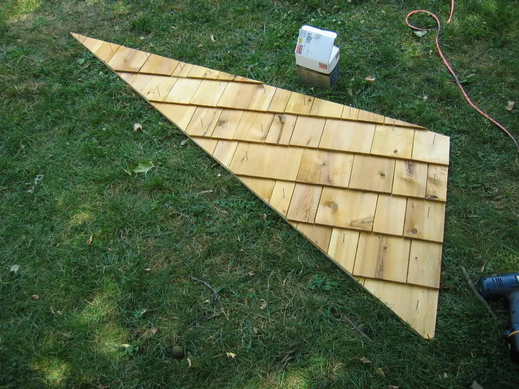

Did part of the dormer today.  Lots of cuts involved, and I knew it would take me forever if I were measure, go up the ladder, go down the ladder, repeat.  So I devised a plan.
How to solve this?
Decided to build it on the ground.  Just build a frame and shingled it on the ground.  Cut it to size with the circular saw and some site made tracks.  Also changed the exposure to 6 inches.
And, plan backfires.  Yup, it's crooked, yup it's staying that way.  Eff it will piss me off every time I look at it though.  Also if anyone does this, there should be a gap between the roof shingles and the bottom of the shakes.  I planned for a gap, but when I got it up there, it was gone.  Must have measured wrong.  Couldn't cut it smaller because of nailing.  Oh well, make the mistakes on the shed and when I get to the cabin (someday)  I'll be a pro.
