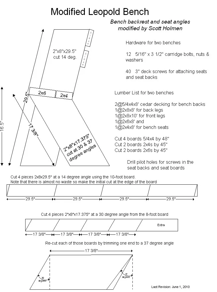

Ok, I finished mine, but I think I did something wrong. (picture to come eventually)
Just looking at the space between the back of the seat and the bottom of the back, it looks like you have more on your benches than I have on mine.  Which leads me to wonder what the lengths of the legs are that you were using.  Mine I cut to 33"  as in the drawing on the previous page in this thread.  Was yours a bit longer?

My side pieces were 36", measured from the point to the short edge of the angle.

Well, I guess that explains why they look about 3" taller in the picture than mine does  d*  I used the 33" measurment that was on the drawing posted earlier in the thread.  I know you worked off of the design in the book, which must have been slightly different.  I guess the next one I build I will have to try the 36" measurement then.  :)

Here are my revised plans for a pair of Leopold benches.  Used them more this weekend and they seem to work well.
Nice plan and good looking bench.

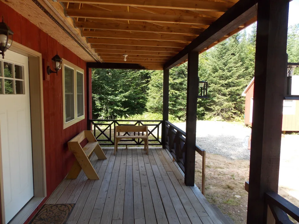

I built 4 of these for my front porch. I always ask everyone to sit on one and see how comfortable they are.
