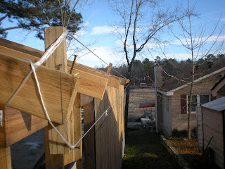

I haven't posted any updates in awhile, so here goes.
Most of the 2x4 purlins are on.  I hurt my knee right after the trusses were finished, torn meniscus the doc thinks.  So, I'm not as mobile as I was before.  The decision to do arthroscopic surgery (spelling?) is rapidly coming as I'm tired of this lack of mobility, and the subsequent weight gain that comes from not exercising.
And, I've made the "plumb cuts" on about half the truss (heel) ends, so the fascia will go on parallel to the house walls.  I found a little video on YouTube that shows an ingenious way to line up all those cuts.  It involves using two strings.  The pic above does a pretty good job of describing it.  You can also see the cut marks I made on the first three trusses.
In the second pic, that board sticking up in the middle of the upper string is not part of the method.  It's just an extra board leaning against the wall on the inside.  I should've removed it before taking the pic.
There's more info in the blog at address below.
My house building blog:
http://n74tg.blogspot.com/
Sorry I don't get the pictures.  Just the usual outline w/red box "X".  I went to your blog and saw what you are trying to describe.  I generally just snap a line on the top of my rafter tail.  Then take a scrap piece with the correct plumb cut and line it up with the top of the rafter and the chalk line then strike a line with a pencil transfering it to the rafter tail and cut.  It is a little easier if you figure the off set of your saw and clamp that scrap to your rafter tail then using the guide of the saw against the block there is little margin of error.

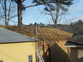

Metal Roof Started
Yes, I finally got it started.  It's K-Panel, 26 gauge roofing, hunter green in color.  What you see installed is 21 pieces, or about 25% of the whole roof.
In the beginning, each piece took what seemed like a really long time to get installed and screwed-down.  But, later I realized that if you've never done it before, that it just that it takes awhile to get the most efficient methods figured out and implemented.  On the last two days I've gotten about 8 panels installed per day.  If the weather holds I could get finished in as few as 7 more days.  Now having said that, I'm sure it will take at least twice that long.
There's a lot more detail in the writeup at the blog address below.
